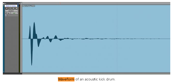

attachment.php

You made comment about how the 3 audio files you created with different timbral profiles represented a distortion that was low in priority on your list....
I simply disagreed to its lack of importance....one of those files about caused physical pain and this is just one frequency imagine the distortion spread across the whole midrange....Must be my musician ears that are super sensitive to distortions...I'd be highly dissatisfied. Luckily those are extreme representations, maybe thats why you say they're priority is low.
Then I think you misunderstood what I did and what I meant.
The audio files were manipulated in phase only. They were of a 400Hz square wave. So the fundamental was 400Hz but there is many more frequencies involved to make a square wave.
In one file this caused clipping which was obvious and easily detected and was just meant as a demonstration of how a phase change could create a problematic amplitude change.
The two other files were an original sample of the square wave and one where the phase change made the waveform look nothing like a square wave but yet it still sounded like a square wave, at least to my musicians ears. This is a lot like what happens in a crossover with some group delay.
The ear and brain are able to sort out a lot and a garbled waveform can be heard to sound very much like the original.
This general principle is why almost all research on phase tends to come to the conclusion that these sorts of phase changes are not a highly audible problem.
So when ranking defects in a speaker that are highly audible, this sort of waveform trashing comes down the list for most. You can disagree and there have been a number of notable individuals that prioritized waveform fidelity very highly. For myself I have conducted lots of unscientific listening to different filters and phase changes to try and discern my preference and on the whole I prefer less phase change and to me the difference is more audible as frequency goes down. The differences are easy enough to hear but deciding which is preferred is much harder and changes based on program.
