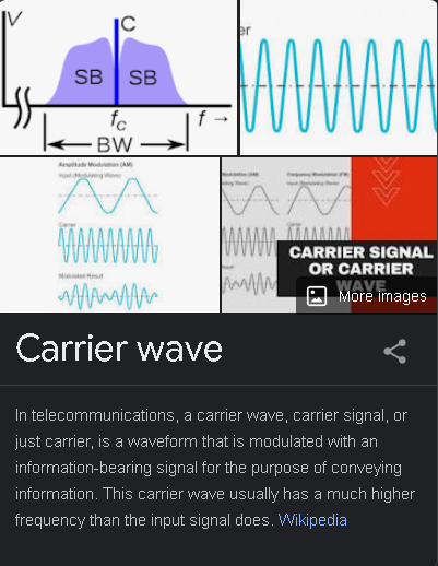

Could we call the fundamental the carrier signal?
No. The closest thing to a carrier in sound is air. In audio engineering, a tape bias frequency or sampling rate would be close.

It appears a carrier wave is not expected to be the fundamental but, it can be the fundamental...
"One concern we have in using a given C:M ratio is whether the carrier frequency is the lowest frequency in the spectrum, i.e. is it the fundamental? If it is, we can treat the carrier frequency as the principal pitch that will be heard in the resulting timbre."

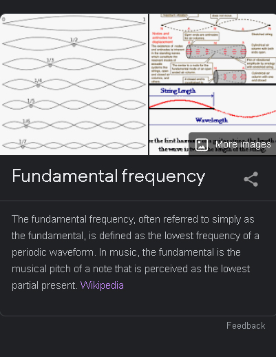

I thought these were interesting...
The fundamental can be, the Carrier wave.

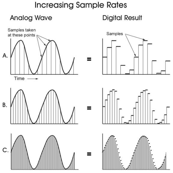

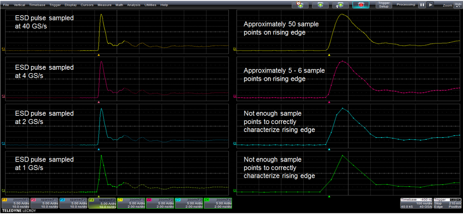

Look how sampling rate affects the impulse.
