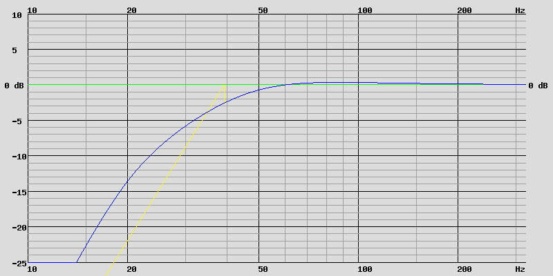

No shun to FaitalPro but The AE has the specs I was looking for, thanks to every ones help. If extending the bass isn't to my satisfactory, now I have an excuse to build a giant air pump next year =). I'm pretty certain I'll have more than enough though.
So all drivers have been purchased now! Waiting on a 60cm/23in JMLC horn, wide for the inquiring minds. Unless the ebay guy is a fraud, which I don't think he is, only thing left is enclosure design and......how to split the signal into 3 stereo inputs....or at least 2 if going to run the 15's in series instead of separately. Potentially I may be able to use the minidsp for the latter though I am trying to eliminate the minidsp for purpose of lowest latency.

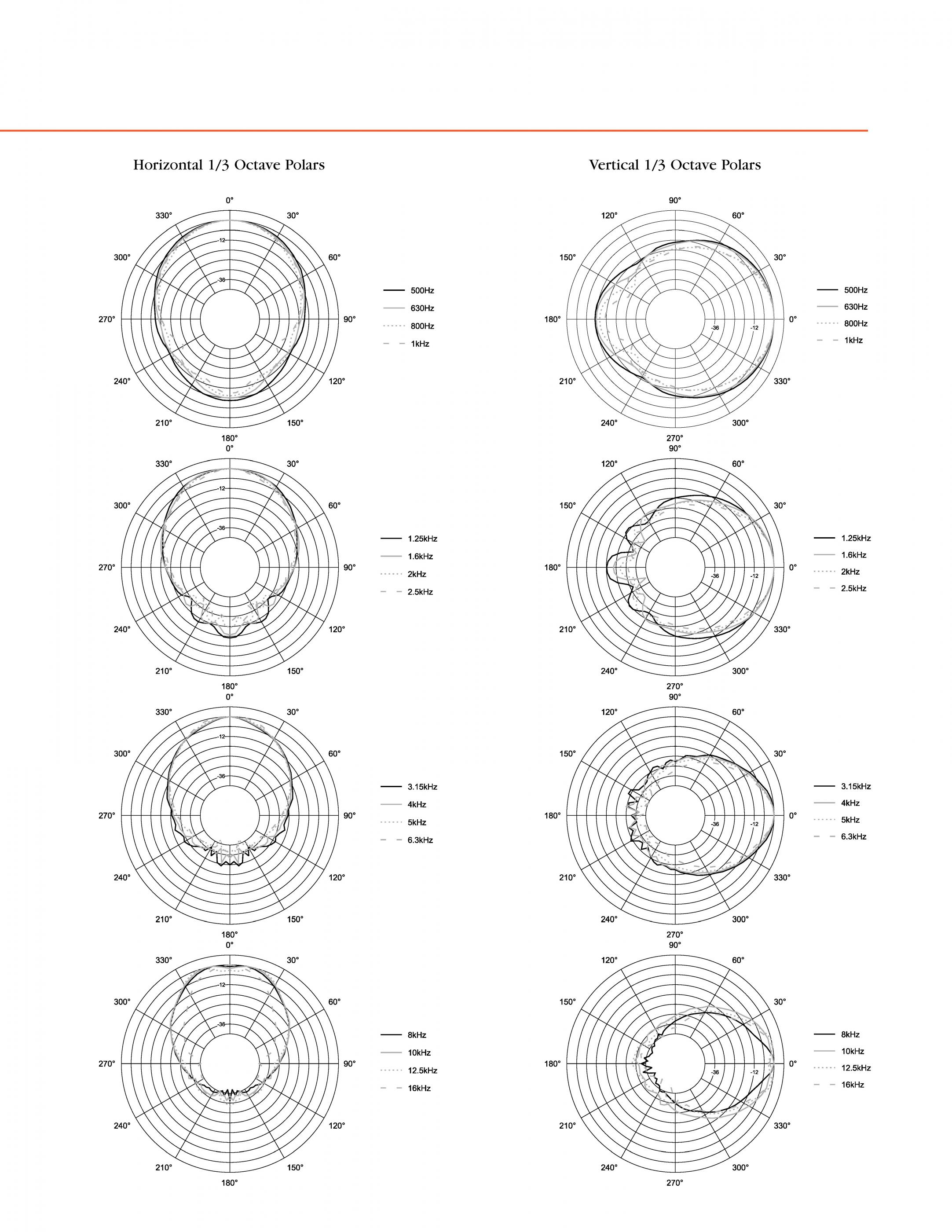

The measurements below were performed by jzagaja for the Auto-Tech JMLC350.
A Polish STX D1500Ti 2" driver was used.
I would expect your JBL to do a little better in the top octave, but it will beam, just like the Tractrix.

No way i could live with that dispersion.
Me too can't stand head in vise flash light beam systems. Sound is compromised off axis and completely unnatural as you move around the room.

Me too. I mean, that's horrible, really wide at the bottom and extremely narrow at the top. Most spherical wave horns behave like that and I cannot understand why so many claim these would be the best and only acceptable horns.
If diffraction is bothersome, one could stick a small piece of 30ppi foam in the slot. The 2451 has enough output to compensate for the 2dB loss.

While I wouldn't necessarily use words like horrible and the like, I agree that an overall wider dispersion is desirable even it was mainly in the horizontal plane.
The performance, namely very bad dispersion, in conjunction with the quite luxurious price leads (well, at least for me) to a that bad price/performance ratio which I cannot call anything but a horrible result. For that money, I'd expect a lot more!
Therefore I suggested the 5352.
Hm, at 16k it's also very narrow with just 30° dispersion. At 10k and below it's 60° over a very wide range though.
It's not my dream horn but the 18s XT1464 performs a lot better regarding dispersion control over the frequency range.
