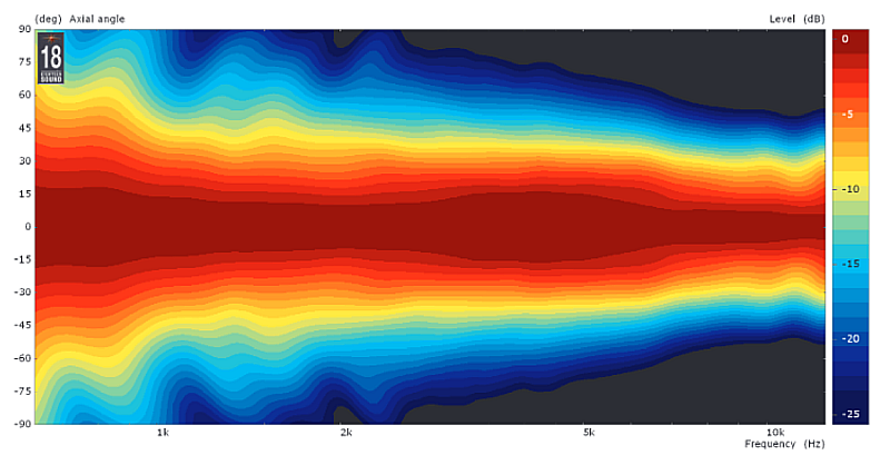

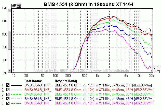

It's not my dream horn but the 18s XT1464 performs a lot better regarding dispersion control over the frequency range.
I am not convinced the XT1464 is better in the top octave.
This is the horizontal polar plot (Vance Dickason).
That pretty much depends on the driver, too! I've seen other measurements which look a lot better than that. But even if it doesn't perform better, it's still only ~1/10 of the price!

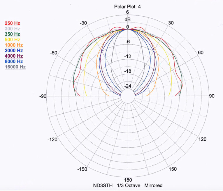

The polar of the jmlc 350, most likely due to the driver used in the measurement, isn't flat. The polar for the 350hz tractix is super flat, and the polar for jmlc 200 is just as flat, so with the right driver the jmlc 350 should just as flat, unless you guys know something I don't.

My concerns are more so about diffraction at the mouth, but I think the polar will turn out quite nice with the chosen horn. I am interested in covering a larger portion of the freq. range with a single horn but all things considered I may have done a good job choosing the middle path between high frequency performance and low.
Camplo, mouth diffraction and reflectance should not be a cause for concern.
JMLC horns were primarily developed to minimize those, hence the 270° rollback.
A JMLC beats the Tractrix in this respect, only the MinPhase is of the same level.
