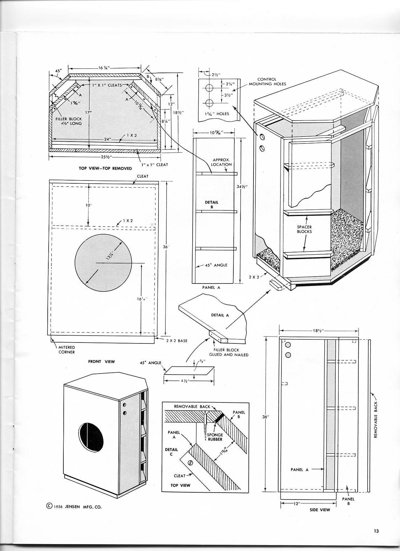

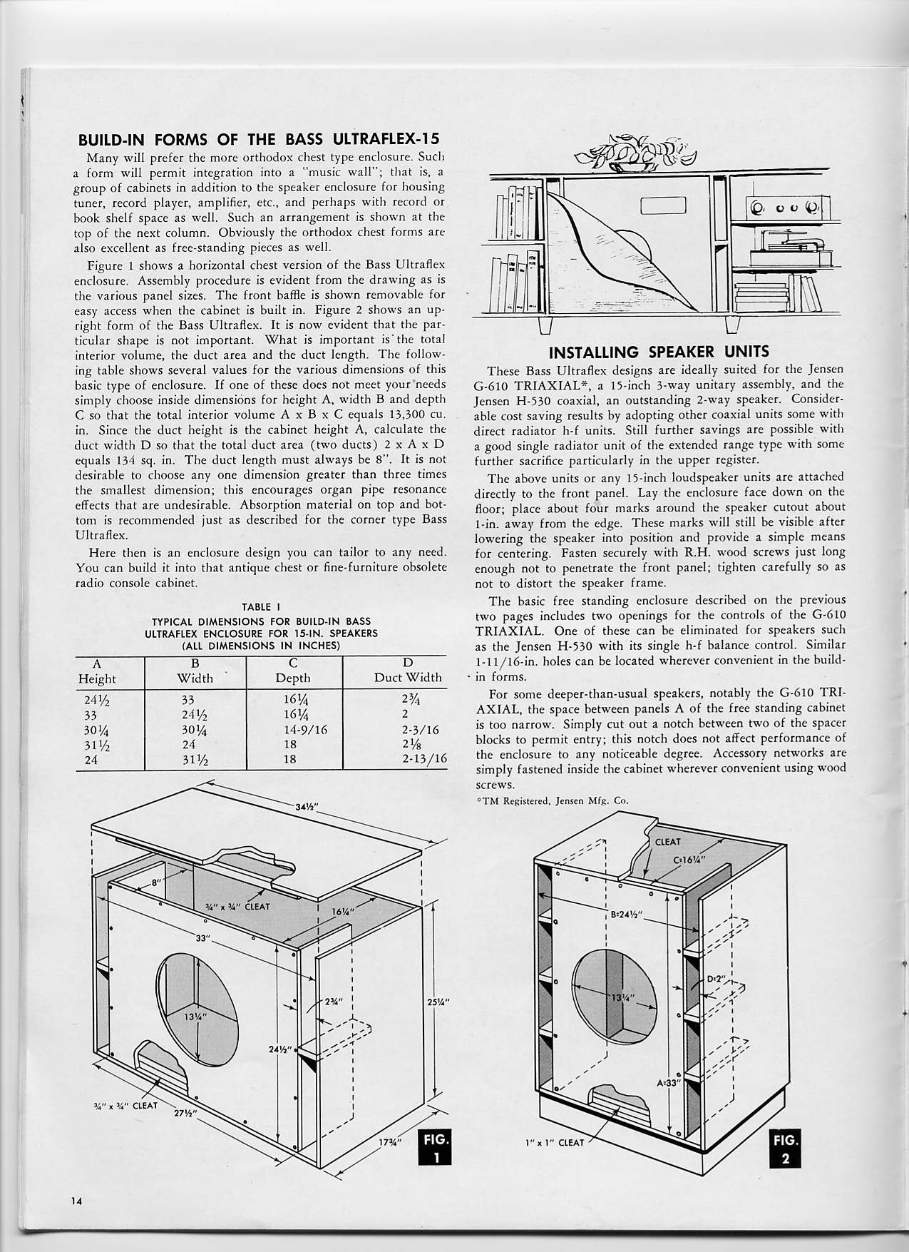

There is a type of enclosure where the ports or many slots, I forget the name...I seen another enclosure where the guy used several longitudinal slots on the sides for the port. At least, the first instance its a known enclosure style that supposedly has increased performance. I'll figure out the name in a second.....its dinner time.
I presume you mean the Onken, a specific alignment of a type of Jensen Ultraflex [fig.2]: http://www.dcaudiodiy.com/jensen_imperial/page_14.jpg

The TD15M just barely meets the Av = Sd ideal w/6.34 Onken alignment.
For 'best' = 5.7 alignment = ~ T/S max flat, vents will need to be < Av= Sd, but still 'good enough' to get some of the Onken's Fb boost: HiFi Loudspeaker Design
GM
edit: comparing these two except with a single large vent, which can be easily retuned, the smaller 6.34n seems a better choice overall unless of course you want the multiple vents for their industrial 'look'.

I think you just said a single large vent is suffice. I really don't like the look of the onken alignment with square slots., I was hoping the same could be done with multiple round holes.
This is the other Jensen design with the vents at the front, that you see more often:
Such cabs are more difficult to build compared to good ol' BR cabs.
