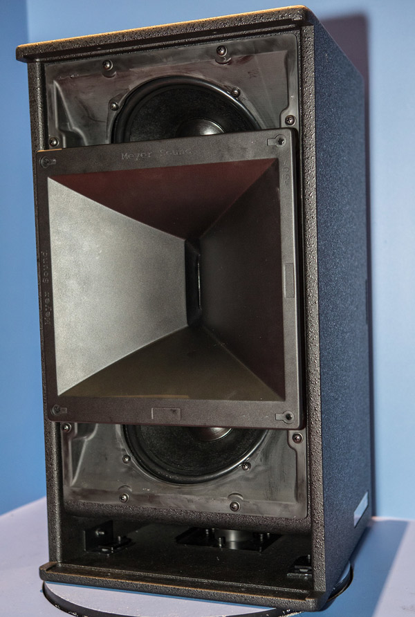

Funny isn't it?
Despite the 'worst thinkable horn sound', there's a huge diffraction slot in the Ultra-X40's horn.
Yes, it is funny 🙂
My guess is that Meyer wanted the horn to cross lower like so many pro designs are doing today.
That crossing lower overcomes the 'worst thinkable horn sound' 😀
