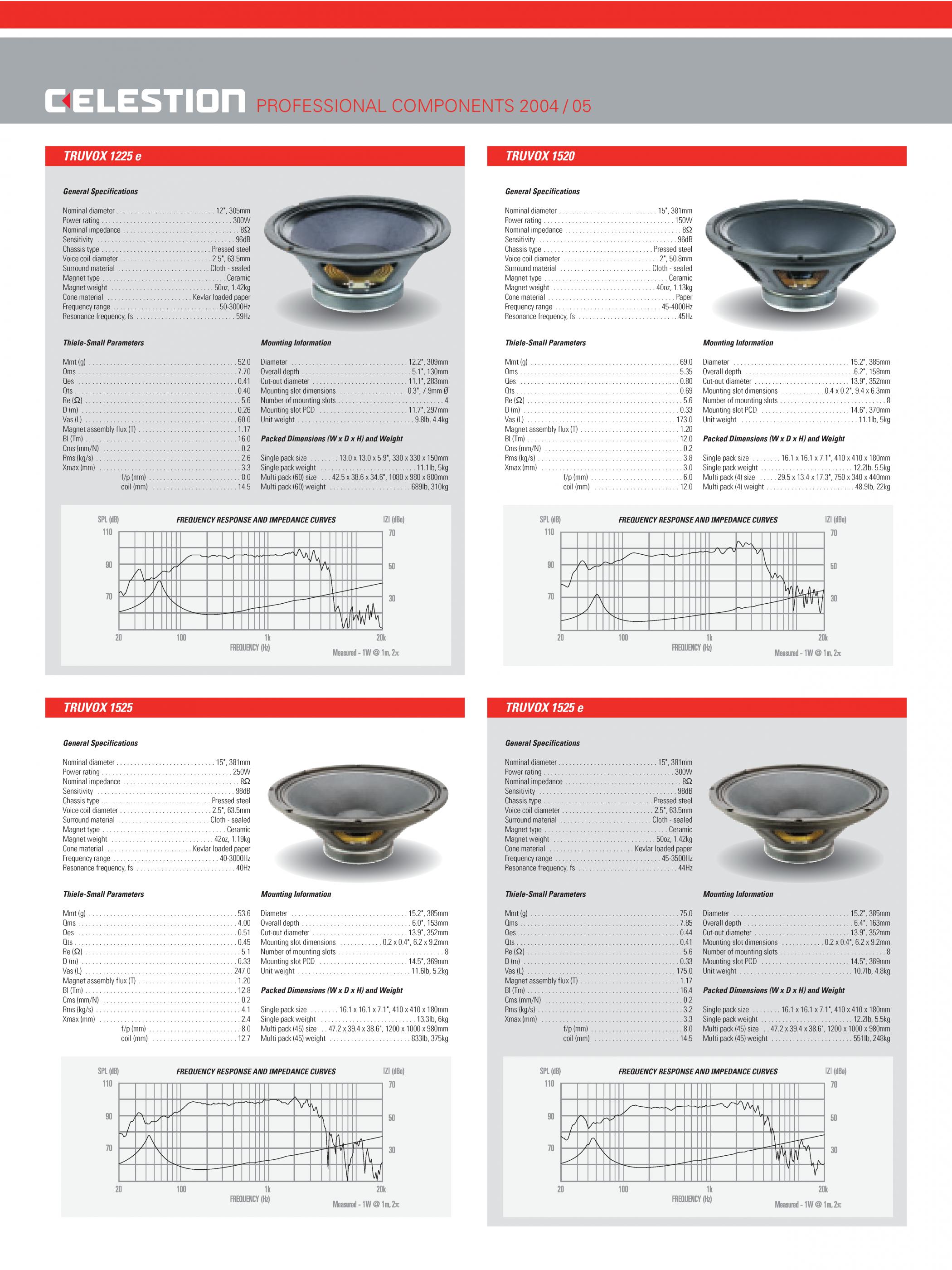

Now that I have done some research, here's one more specsheet.
This one is from the 2004/2005 catalogue and the TruVox drivers had the latest labels by that time. BUT, I am quite sure there were 1 or 2 small revisions after this one.

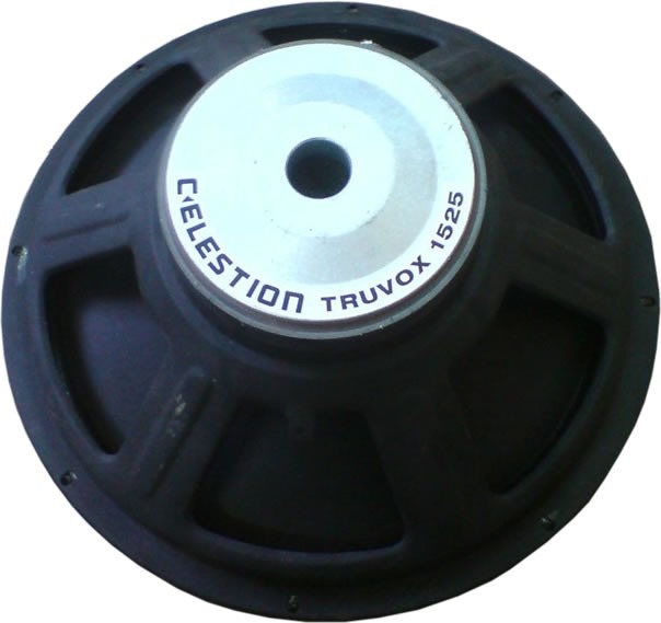

Below an early Red Label and a later TruVox.

Now that I actually did some research, here's one more specsheet.
This one is from the 2004/2005 catalogue and the TruVox drivers had the latest labels by that time. BUT, I am quite sure there were 1 or 2 revisions after this one.
The last one looks exactly like the current one, except for the label, but looks do not say much.
