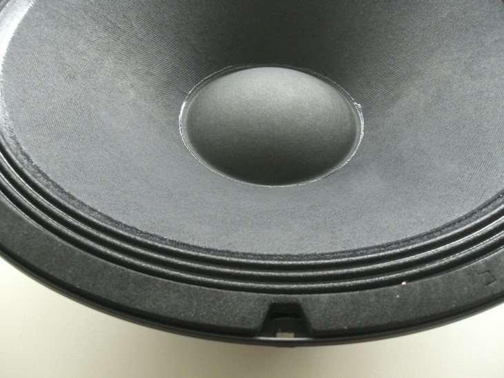

Or, they use the cone (and possibly the magnet) of the 15HCX76 or 15CXN76, the parameters of which are close to the Cyrille M38ND76P-2.
To get a clue about the driver, it's useful to check the cone surface/structure.
If you compare the woofers of the previous pages, the GPA 416 etc., but also the Faital 15PR400 you'll notice the cone surface is similar to this (of my own driver):
You can see that structure on a lot of drivers, even on extremely cheap ones. That's not actually a hint.
Obviously, this applies in conjunction with the motor and suspension.
I am not talking about guitar woofers with 1.5" VC.
If it's that common, it's obviously not a hint. That got the same quality as saying 'that car got alloy wheels, it must be a BMW'.
