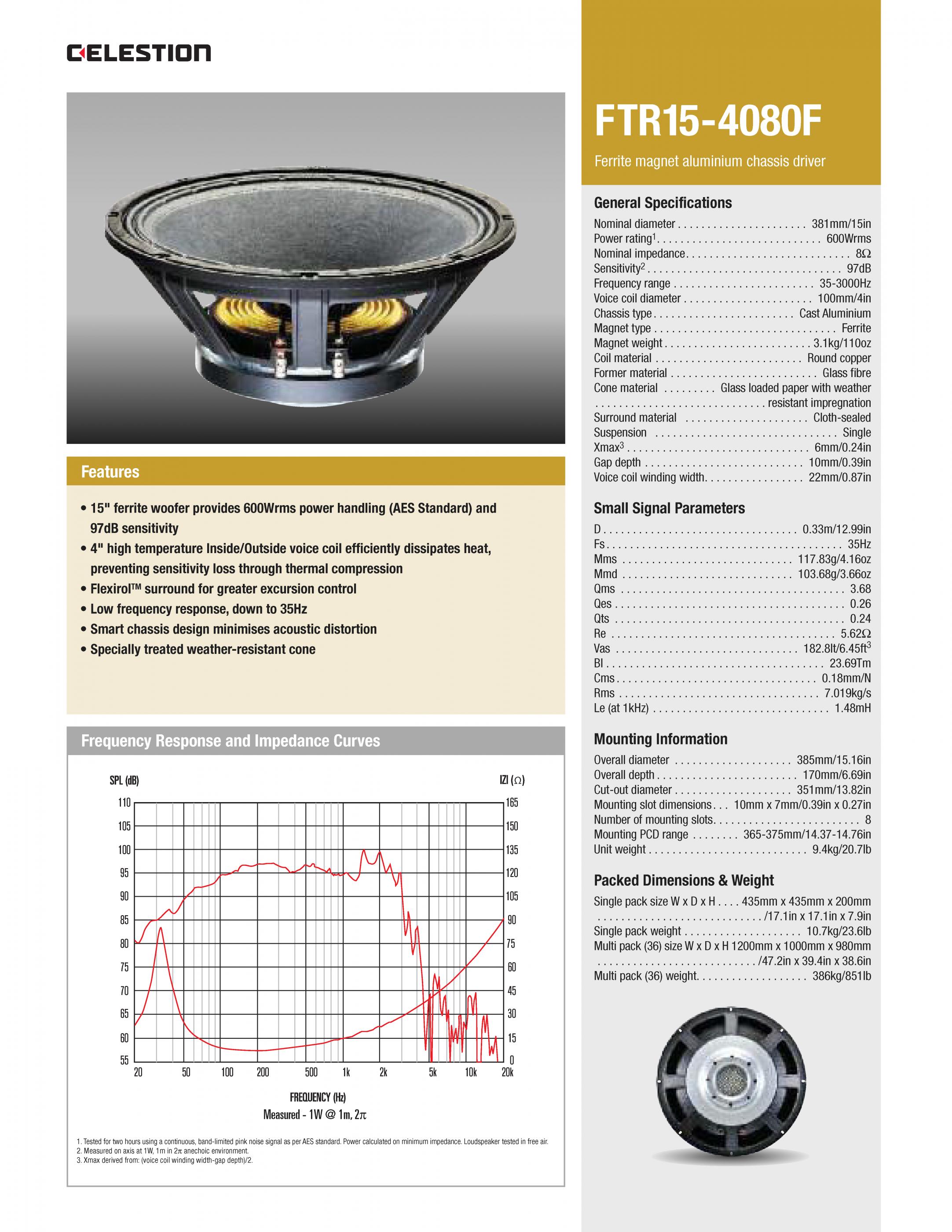

Noted! I also like the 15FH500 for many reasons, I am just trying to wrap my head around actually placing these huge enclosures in my basement.
Regarding the AE15M its still within xmax at 30hz and 116db. It just barely makes it in there. Every driver I mention is within 1mm xmax at 116db, forced flat freq. curve. Varying group delay but all within the 2216nd benchmark. So I still hold it high on the list, at this point, its the AE15m vs the 15FH500 16ohm version. If the Failtalpro didn't have such a gigantic enclosure, I'd have much less hesitation to decide for it.
I tried to find it but I found the jbl you posted instead, which driver was this by name?The driver of which I posted a response curve some pages earlier, is an example.
It has a fairly powerful motor (Bl of 18) and a very light cone (62g).
It'll do about 114dB before x-max and with only 50 Watts.
It's an older Sica driver, not available in the US, but somewhat similar to the known midwoofers like the 15PR400, Deltalite 2515II etc.
The LEGEND BP1525 is also quite similar, except that one has a much lower Bl, but more x-max at the same cone weight.
The suspension is inherently more lossy. That's why it probably won't play as nice in the midrange.
That elevated response >700Hz could indicate this, but this remains speculation without knowing specific details about the cone, suspension and motor structure.

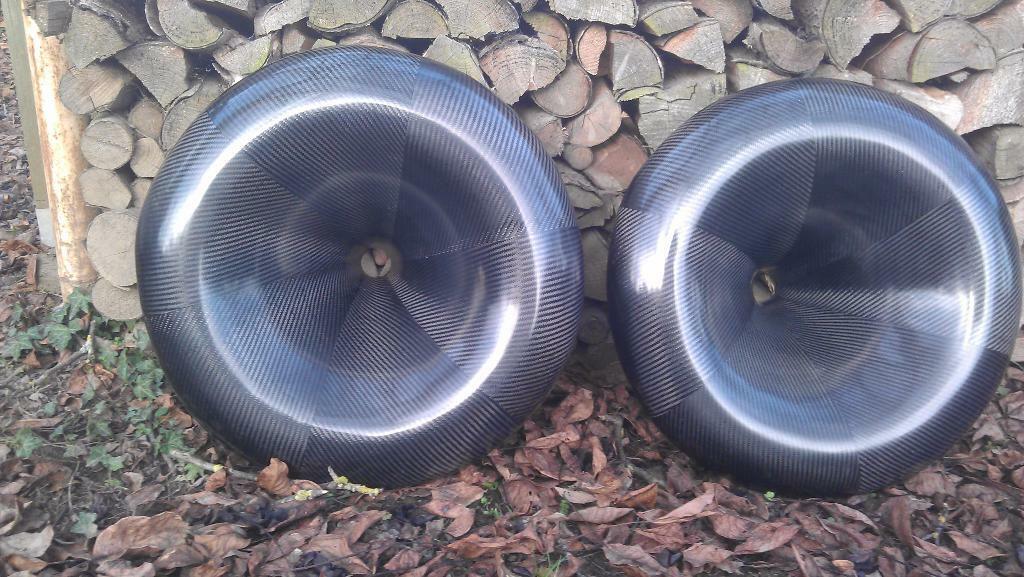

He also makes those of Carbon fiber:
Those are probably spherical horns of some sort.
I could ask the seller, but he'll probably speaks English as well.

I meant this seller, €352 for a pair of 250Hz 60cm diameter horns. Price is negotiable.
I wanted to post that ad much earlier in the thread, but didn't consider it worthwhile because of shipment cost.
I seen those on eBay too, different seller, won’t ship to America. How much will shipping be I wonder? Someone somewhere in America is selling a horn I want, has to be! I asked the jmlc guy about shipping, let’s see what he says
