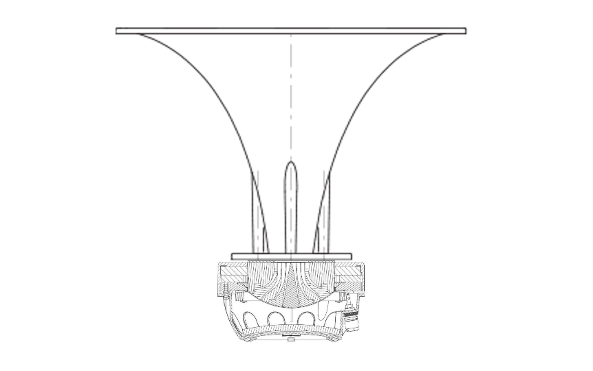

Here's some info that could be useful.
I'm pretty sure its better to have a driver that plays flat to ~30hz, or have an f3 of, naturally, with its enclosure, vs using eq to extend its range, if that range is my design goal....which it is.
I don't know if anyone here has any experience of fidelity of bass when dealing with such a situation. The natural f3 of the dual 15M is ~52hz, I'm not sure if its the best idea to extend it using eq, though the xmax allows it vs finding a woofer that has an f3 of ~30hz like the 2215ND for example.
This Faital LTH142 (clone) is a very cheap alternative.
It's an elliptical Tractrix and could presumably be used from 700Hz, preferably 800Hz.
It's used in the Unison Research Max 2. In the prototype phase the XT1464 and XR1464 were tested, but eventually the LTH142 was chosen.
Drivers are 18Sound.
This thing is supposed to go down to 30Hz, but the driver's Fs (39Hz), cab size and tuning of the port doesn't allow much to happen below 40Hz.
Thats not a bad one Ro808, how do they pull off making it applicable for the 1.5" and 1.4" throat, at the same time?
Forcing the driver to the 30's, via eq, is what I could do with the AE 15M....but is that a good idea vs, a driver that plays to the 30 region without eq?
1.5 isn't much bigger than 1.4". If desired, or necessary you could mill/drill the entrance.
