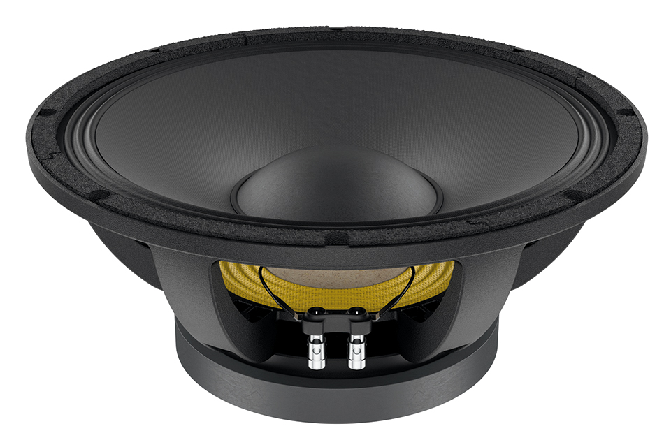

According to a German PA guy, who apparently has used a lot of LaVoce woofers, these are comparable to the known (Italian) brands.
Most DIY folks seem to like the drivers as well.

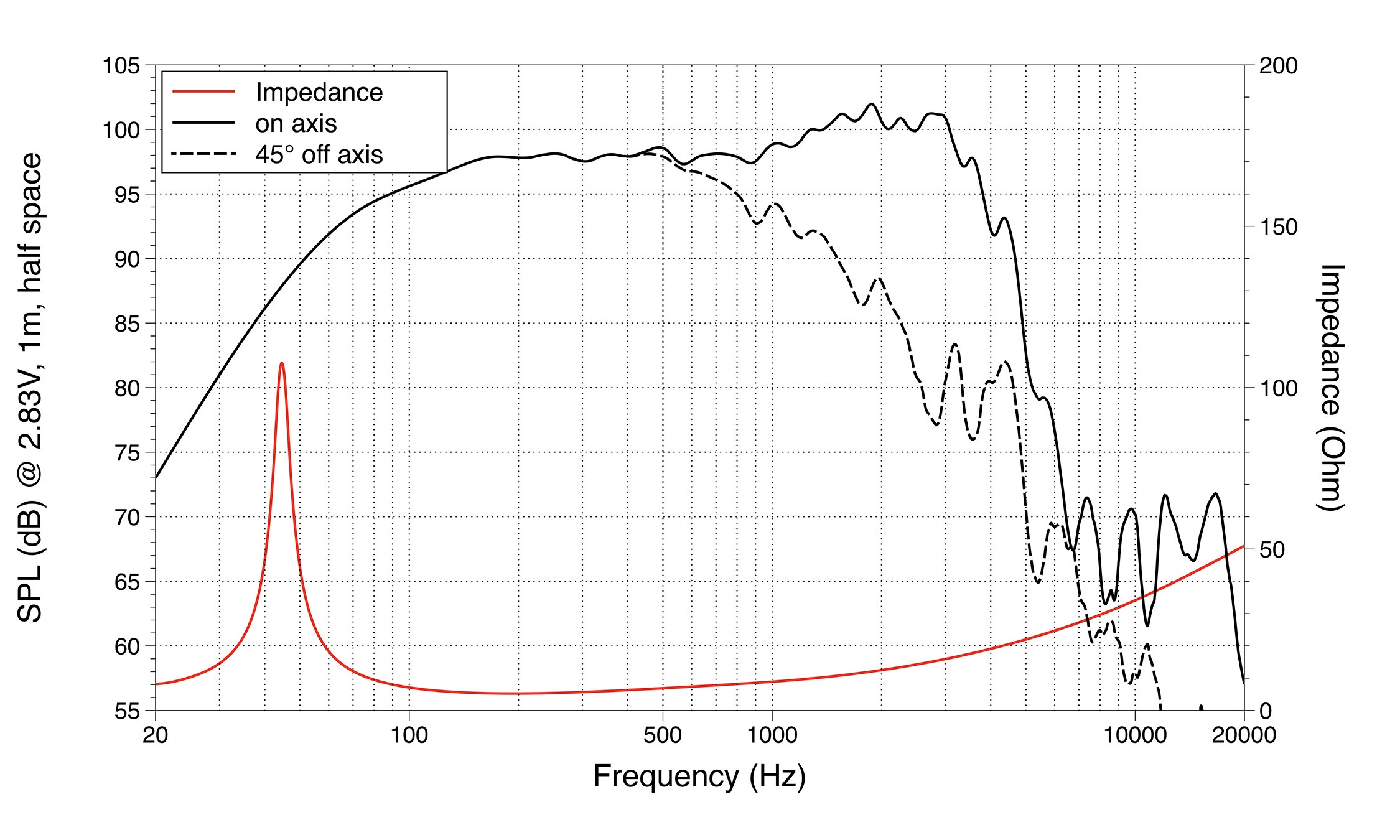

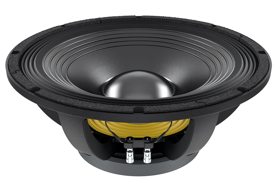

I haven't seen this (new) WAF153.02 available in shops, but it's an interesting midwoofer, with a relatively low Fs of 35Hz and double demodulation ring

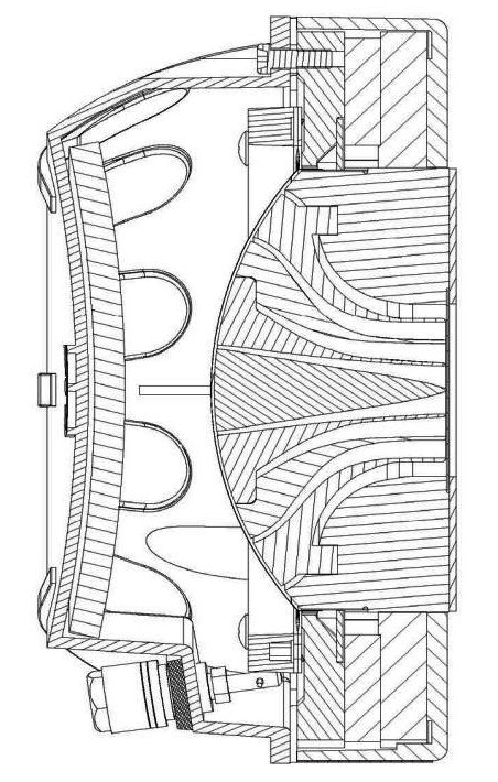

Below a drawing (by Joseph Crowe) of a throat adapter to match the exit angle of a Radian compression driver exit angle to the throat angle of a Yuichi horn.
For Tractrix horns combined with traditional drivers, with a deep conical exit section, it may not matter all that much.
