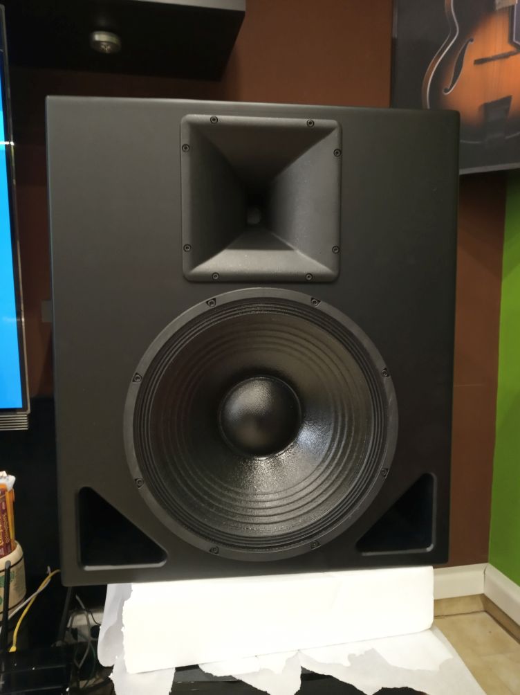

It was the first part of the complete loudspeaker driver unit conception, commercial PA coaxials are too small for my application.
For your intimite listening space, I would opt for an efficient 12 or 15" with horn or AMT from 60-80Hz and up
I tried 6-8-10-12-15-18 in woofers in various enclosures and experienced terrible room modes each time.
complemented with 2 smaller (active) subs.
I removed all the subs in my room, my custom 25in IB coax woofers can go to 30Hz (+3dB) at one meter with a higher level of détail in the low medium (thanks to the direct field)
You might want to look for some older B&C's like the 12 PE 32, 12 PH 32, 12 PL 32 (or equivalent drivers from other brands) which are perfect for such a setup.
Too small and already tested in closed/Vented/aperiodic/semi-open boxes, room modes each time.
At night you could switch off the subs, in order to listen without disturbing the neighbours ;)
The direct field immersion have reduced my listening level by 7dB(Z), my comfort zone was around 80dB (37NF) and 73dB (37NF) now...

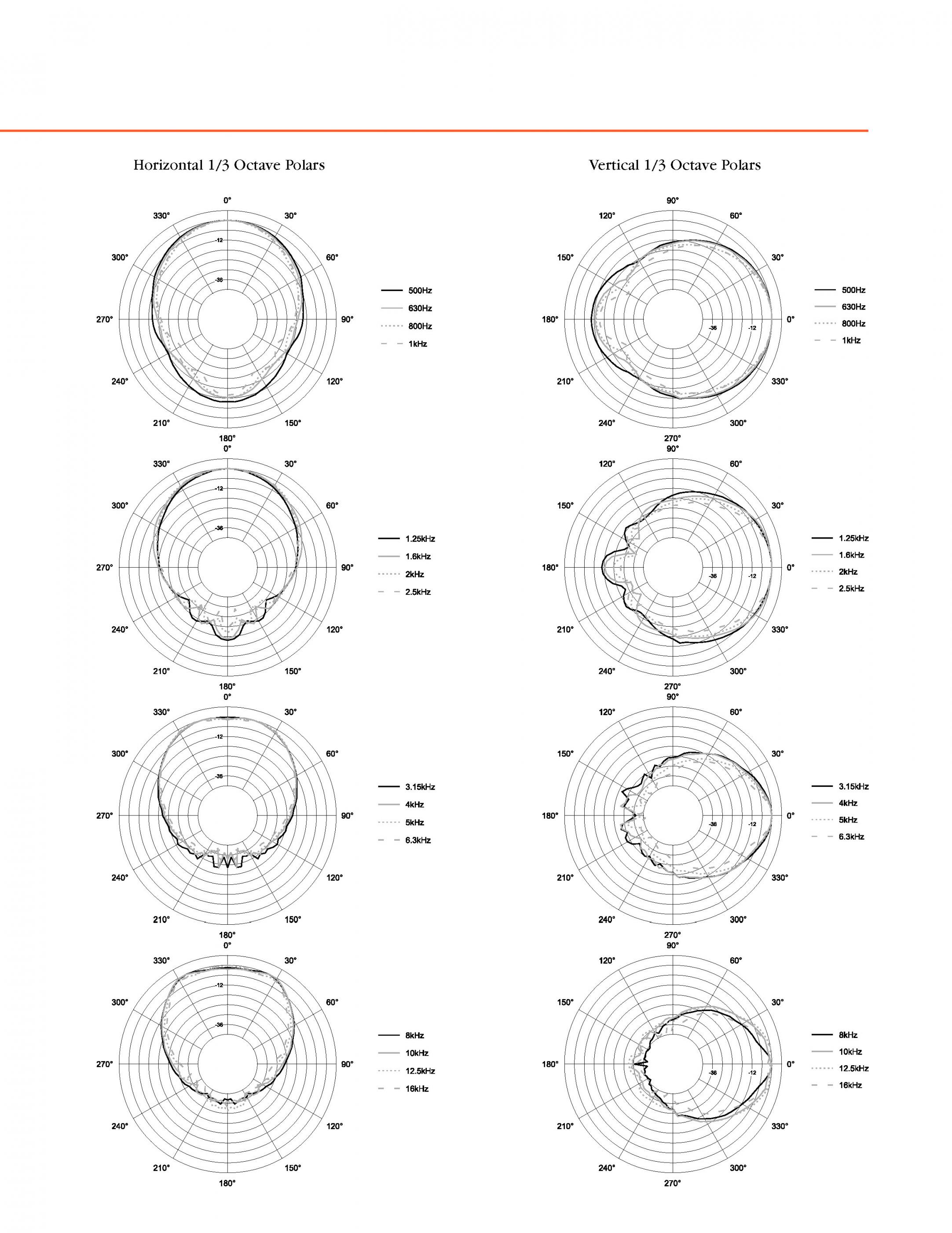

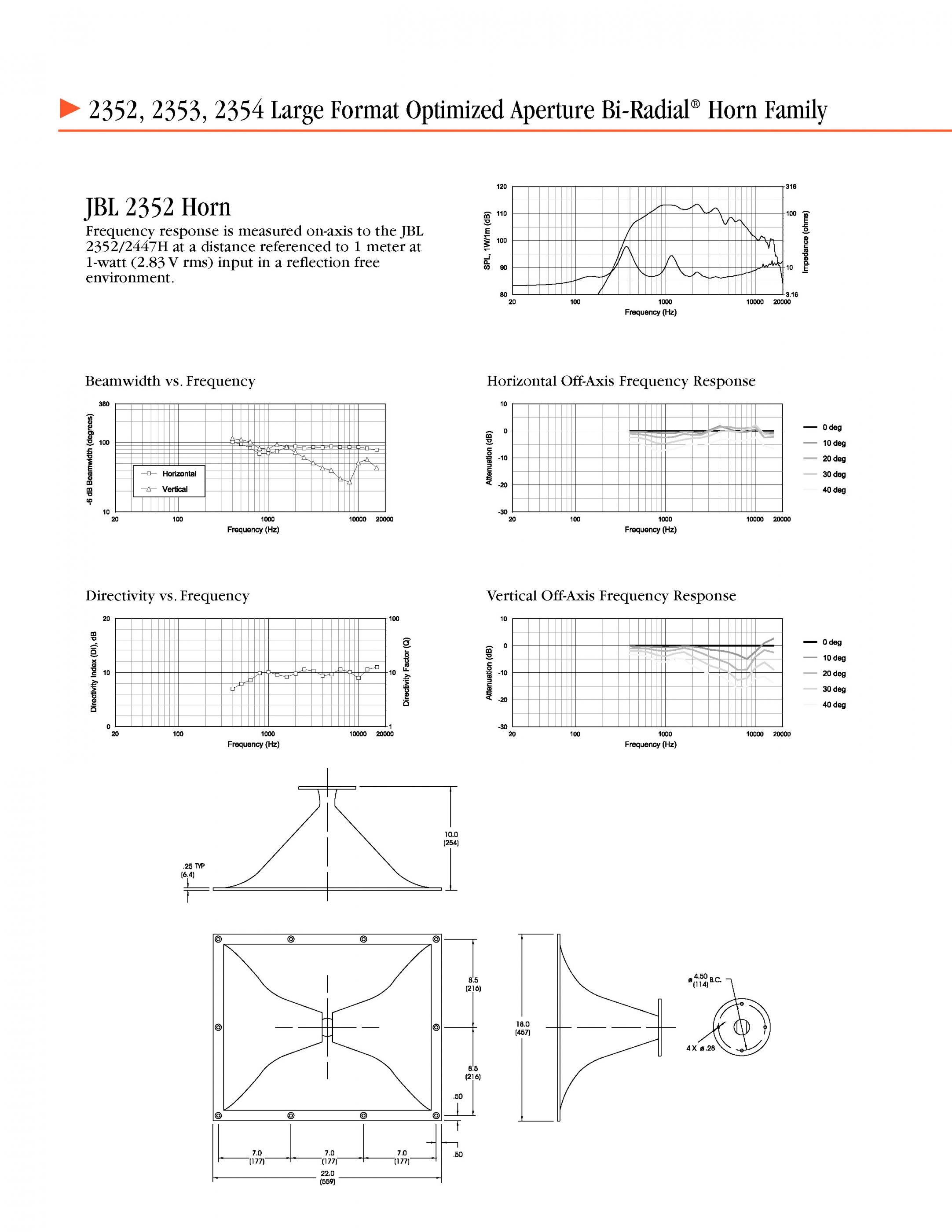

Some data from the 2352 specsheet:
