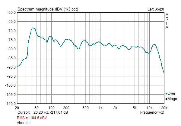

I assume you refer to the midbass horn that I showed measurements of. It doesn't have a slot. But it has a phase plug. The phase plug isn't really important though.
With most drivers it will be flat without EQ up to 550-700 Hz. But with a custom driver with low mass it can be extended considerably higher. However, I don't really see any point in that as the horn is meant to be crossed at 600 Hz or lower.
