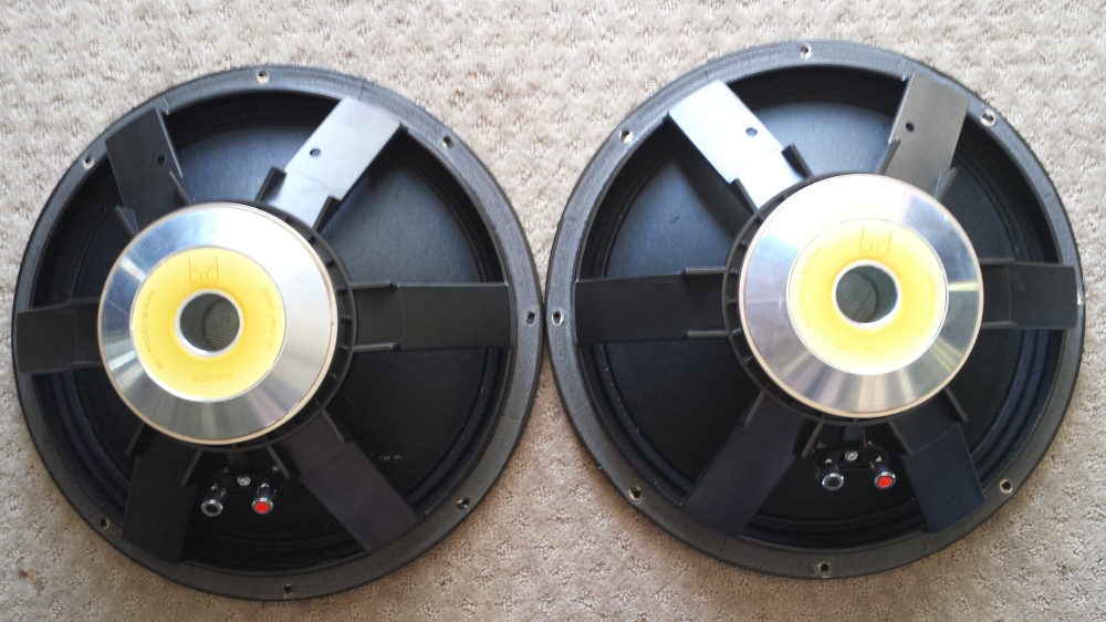

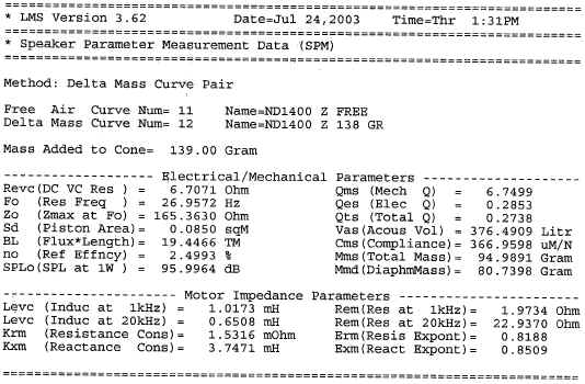

JBL 1400nd / 1401nd. Those are really good woofers for 2 way, but only available as NOS or second hand. JBL S9500 and DMS-1 use them in WTW configuration.
1400 Nd

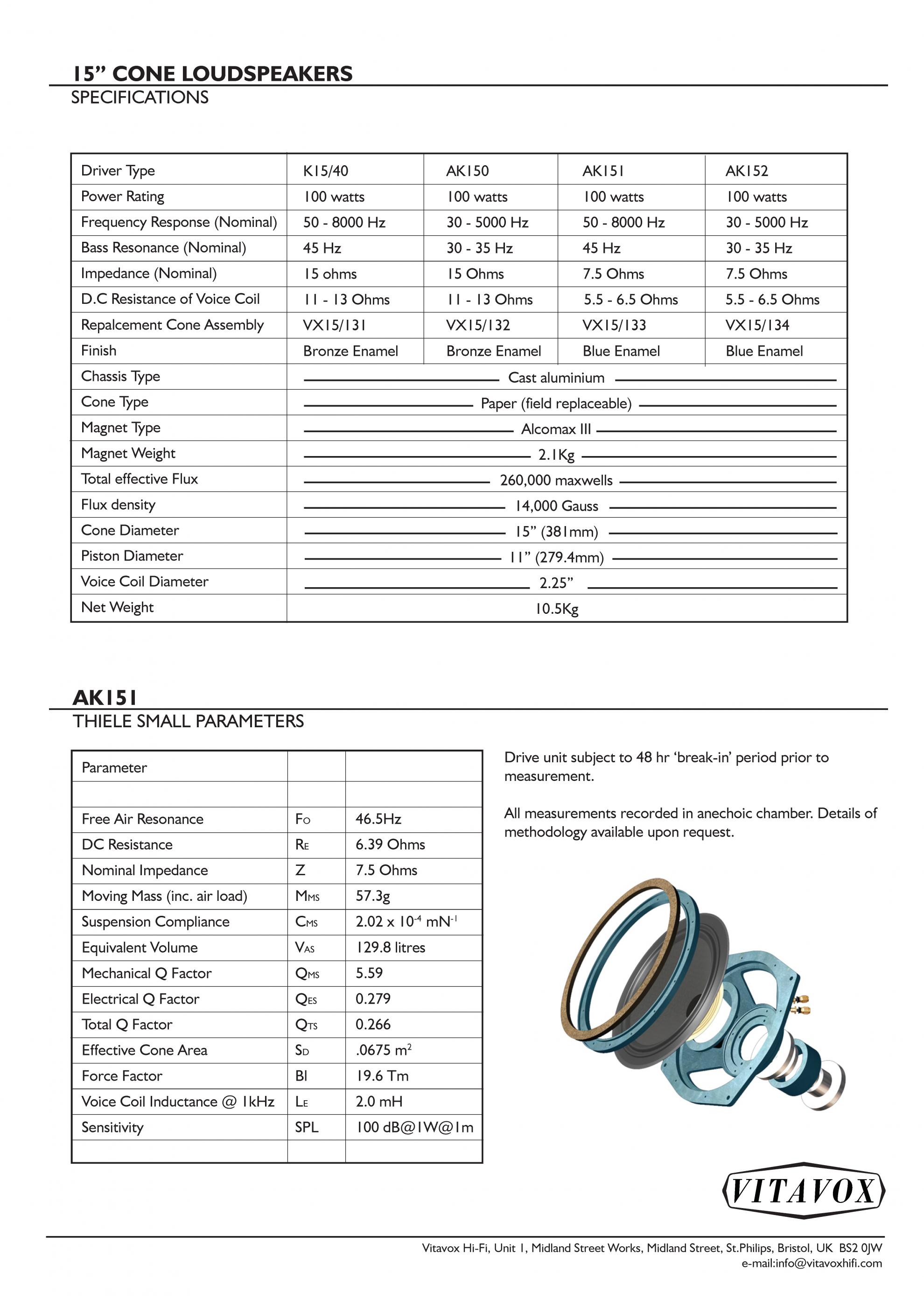

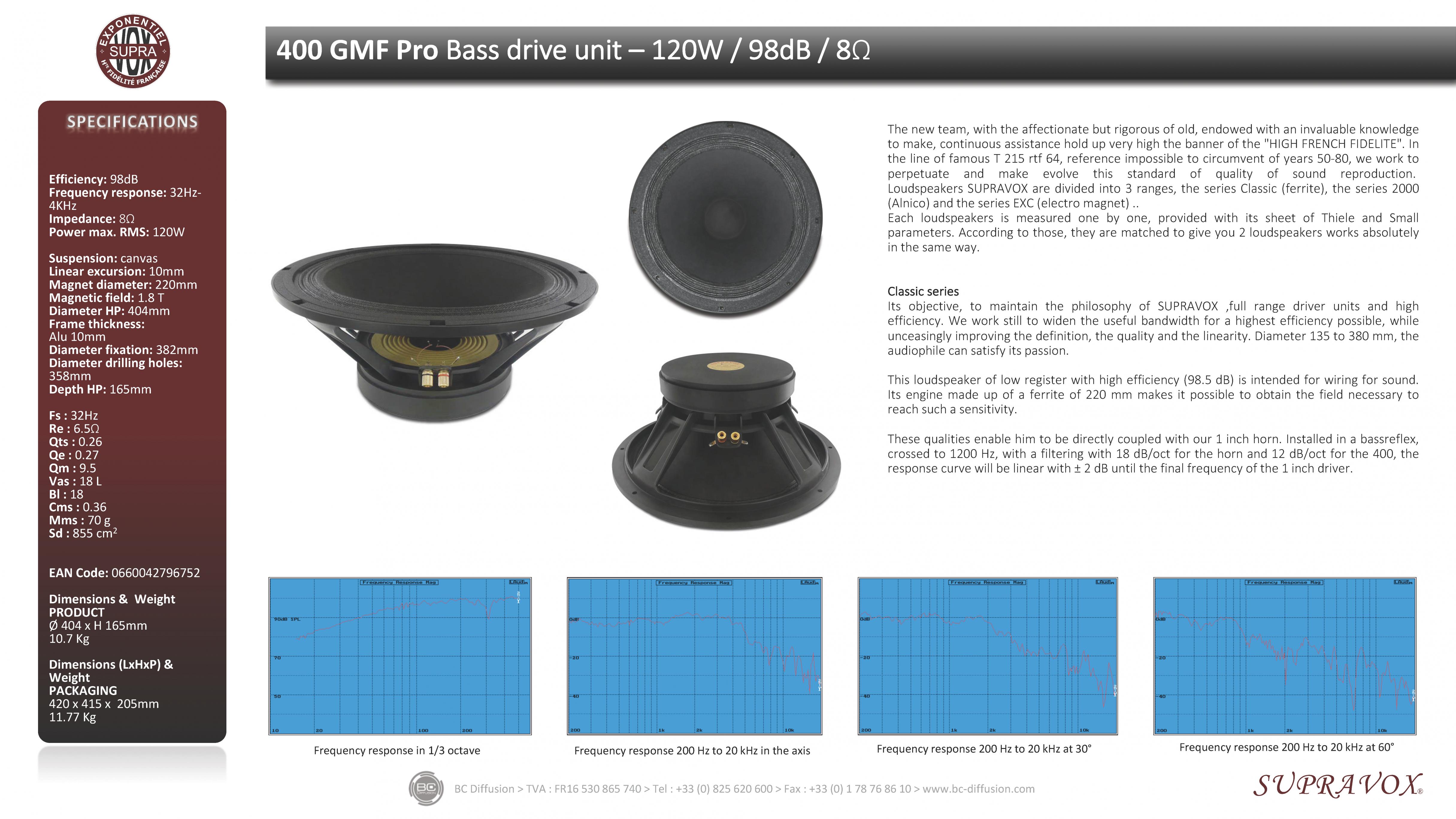

Wide-range driver, that won't like high power levels:
Last one.

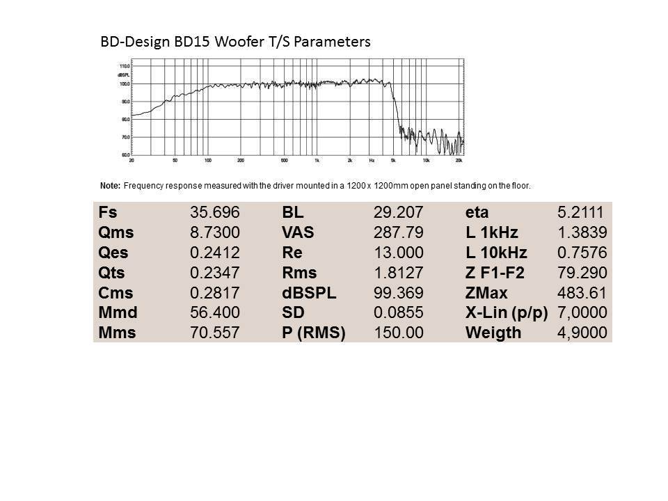

The B(ert) D(oppenberg) 15 was developed (by the man that goes by that name) specifically for his own products.
I am not sure if these are still being produced.
The guy who built my cabinets also owns a pair.
Those drivers are not cheap but worth their money, much more than TAD woofers in my opinion.
Camplo, I don't think the BD-15 is suitable for your project.
This quote may enlighten you:
"A high efficiency speaker designer, Burt Doppenberg specified his own take on a high efficiency 15" woofer. It has a smooth curvilinear cone. The shape of a curvilinear cone tends to help the driver reproduce higher frequencies, which is desirable with a driver intended for wider bandwidth usage. More importantly it sports an underhung 16 Ohm motor with a modest 3.5mm Xmax and a ring neodymium magnet. This is not a pro woofer, nor a subwoofer. This is a hi-fi midwoofer, designed with the ability to operate higher in frequency and with a notable absence of breakup peaking and extremely low distortion. The underhung motor makes for extremely high fidelity within its limits, and the 16 Ohm impedance is a welcome characteristic, allowing this woofer to be used with OTLs, which often allow more power into higher impedances. Alternatively, a pair of them in parallel gives you a nominal 8 Ohm impedance characteristic with 102dB/W/m sensitivity."
