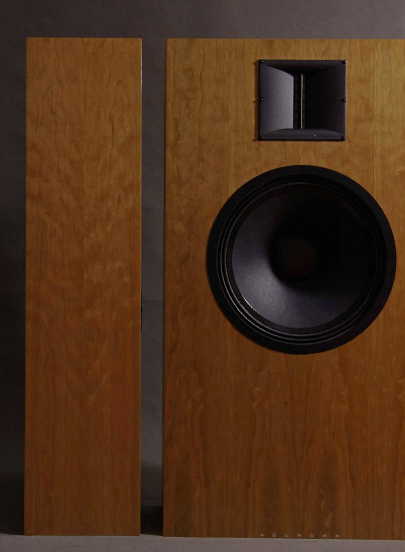

That image is taken from this article on a interesting 2 way for which the 15FH500 and HiVi RT2H-A neodymium are used (use Google Translate).
I guess, the Faital would perform even better if you'd double up the cabinet depth.
I don't think so.
There are remarkable differences between the 15FH500 in 8Ohm vs 16Ohm.
8Ohm need smaller enclosure volumes according to t/s parameter, here seen with acuhorn.
vs 15FH500 with 16 Ohm, different t/s parameters, starting in boxes of 250 liters extremely deep.

I don't think so.

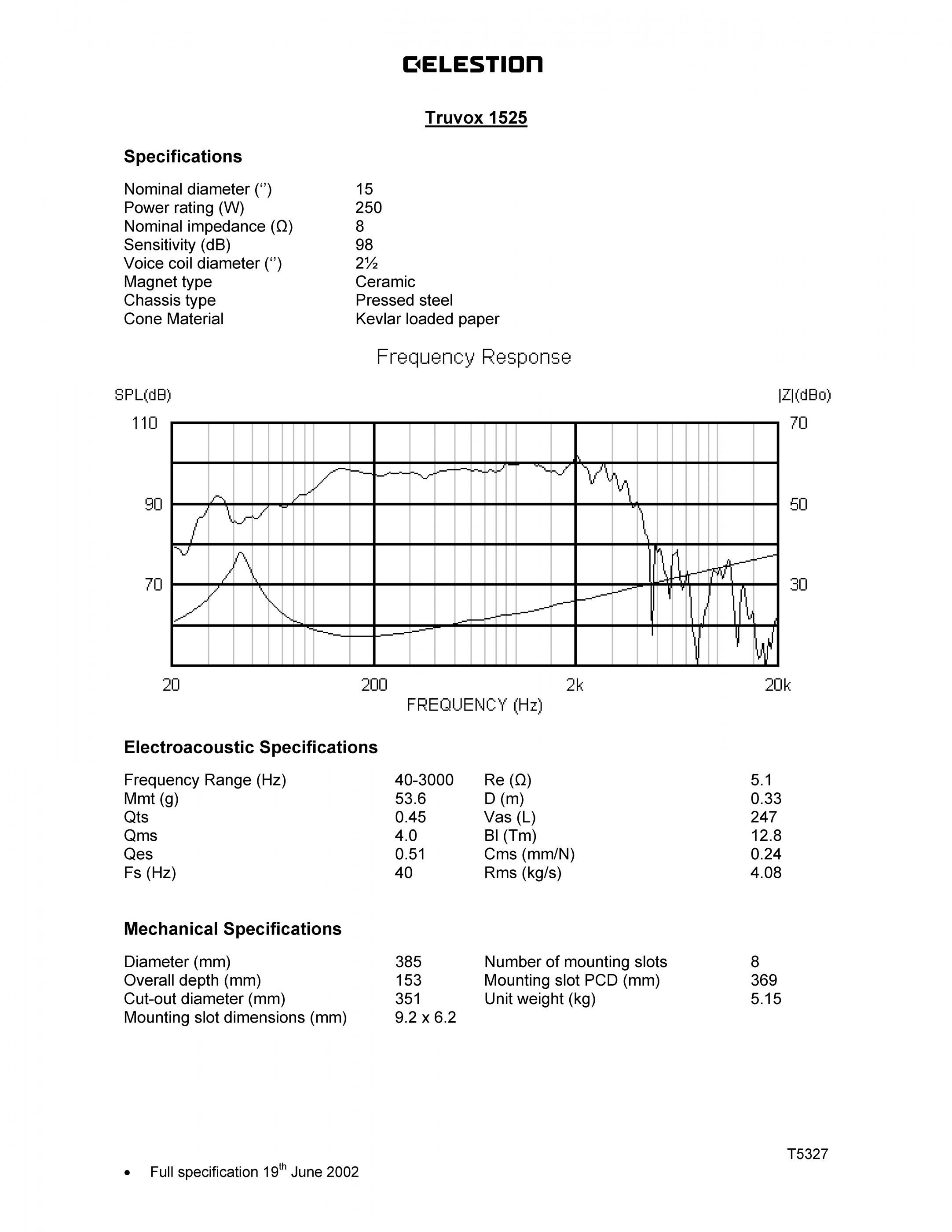

Yes, it's the TF1525, but the older TruVox TF1525 is even better than the current version.
The drivers are identical. They had to change the name (on all drivers) because of the 'TruVox' being a registered trademark.
TF 1525 8 46.0 162.1 5.40 6.240 0710 0637 75.9 12.9 854.0 0.82 ± 2.4 48 97.2
TRUVOX 1525 8 40.0 247.0 5.10 4,000 0.510 0452 65.6 12.8 852.0 0.00 ± 4.0 94 98.9
Both don't fit the datasheet. The 'new' TF 1525 does not have +/-4mm Xmax either, it's +/-2,5mm. The difference to the 2,4 is most likely different rounding at the conversion from imperial to metric. Where did you get these from? I can only assume you either mixed them up with a different model or these were self measured by someone.
Both are metric.
The Truvox parameters are from an old datasheet.
I am sure you are aware drivers and the resulting parameters are constantly being changed by manufacturers.
I am sure that you are aware that drivers and the resulting parameters are constantly being changed by manufacturers.
The parameters are kept consistently as possible. However, the temperature, the air pressure, air moisture are factors that got a lot of influence on the measurement. If they change production details (parameters) of that magnitude, they change the model name/number. But they didn't scrap 'truvox' because of a new model, they scratched it from everything, from the pages, the labels, the boxes, the commercials.
This doesn't change the fact the TF1525 and TruVox 1525 are different drivers.
Maybe there was a different Truvox 1525, but I can tell the 1225 did not change with the name change and the 0815, 0815MR, 1020 neither, I still have one 'truvox' 0815 here and 4 non-truvox, they are absolutely identical, except for the labels. The parameters are very close too, which is quite a feat since they are over 10 years apart in production. Your parameters look more like the TF1525e. I'm really curious to find the differences, please post your datasheets.
