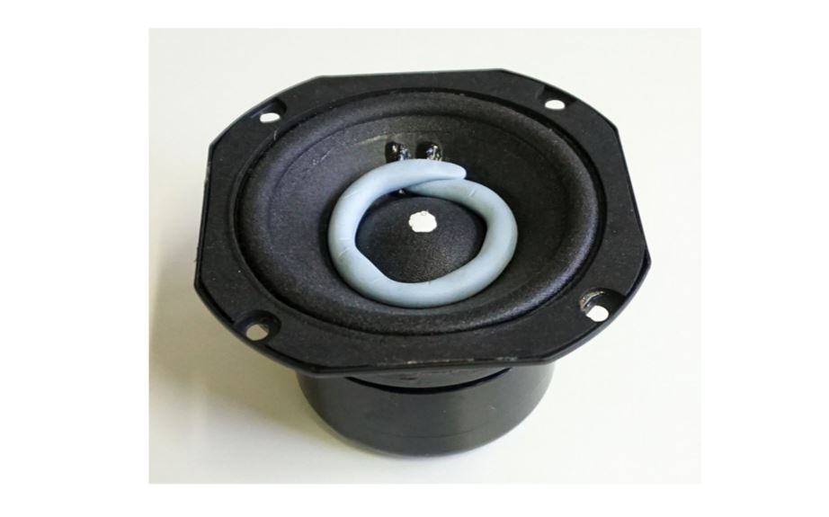

I tried the added mass using ~400grams and the BL comes out to be 18tm still....when using 920grams the mmd did not come to correct figure, somehow that throws the measurement off.
920g added mass to a cone that is only 1/10th of this mass??? Are you crazy?
Attached is a picture of CLIO Pocket method adding mass. I would assume that CLIO is much more reliable.

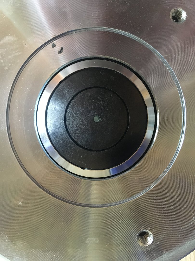

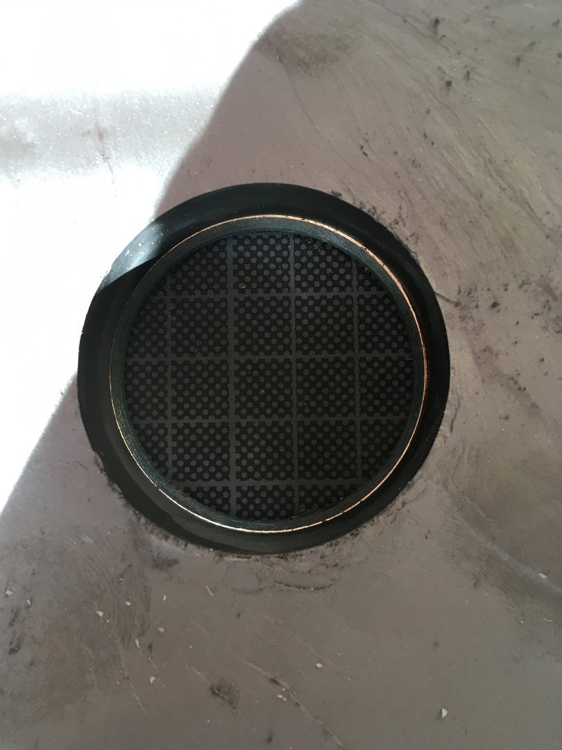

Here's an example of a compression driver where an uneven opening in the coil gap caused a scraping voicecoil.

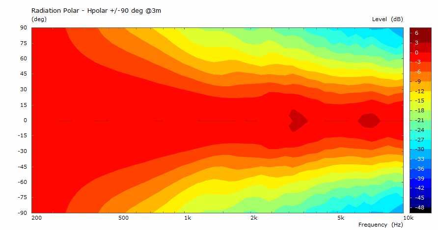

First attempt of a SWH with controlled coverage, without rollback (sims courtesy of DonVK):
- Is it possible to cover the whole spectrum, high SPL, low distortion with a 2-way?
