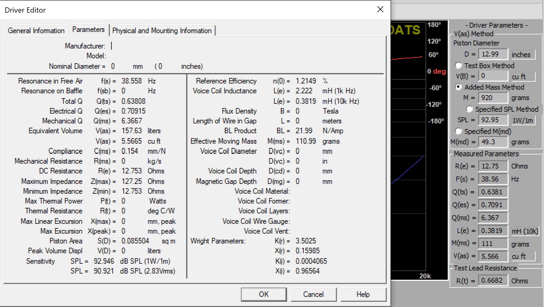

Your dats is giving lower Bl than expected on multiple drivers.
It is possible that your dats is defective and you seem to be ignoring that option...

I added more mass and this is what happened...but now mms is off....If I lower the added mass...I get correct MMS but BL is off

Measurement error for BL... Q has not changed no matter the method...no input is needed for Q. Q measured out correctly within range for the 18H+'s....its just the 15m that is double the expected amount.
Bl is supposed to be about 23tm....I just got a 21.99, when can say motor strength is there for the 15m. Likely to be very close with the 18H+. Its just a matter of Q for the 15m....

I tried the added mass using ~400grams and the BL comes out to be 18tm still....when using 920grams the mmd did not come to correct figure, somehow that throws the measurement off.
