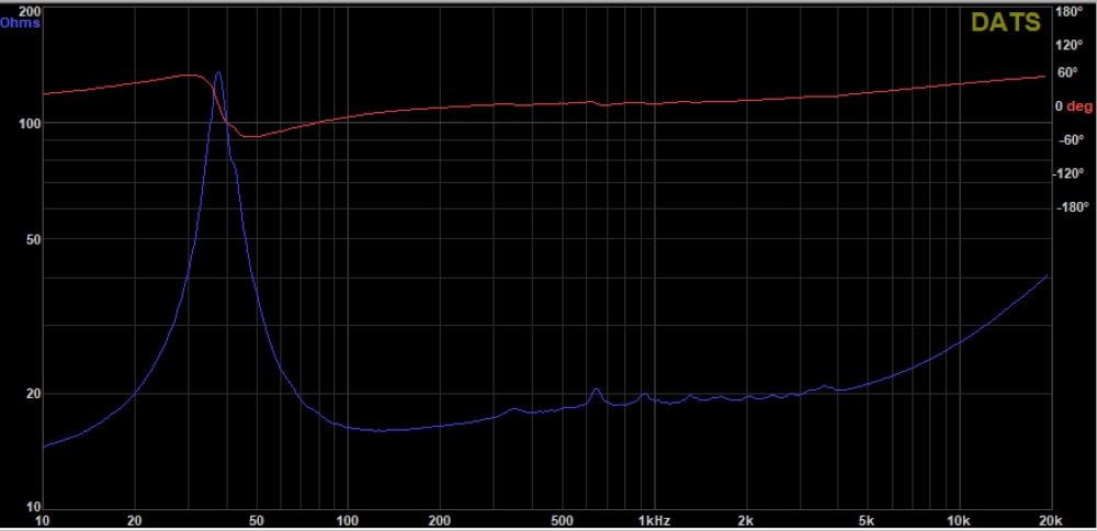

The diameter must be specified correctly. You always have different values, sometimes also 0. DATS cannot calculate correctly with this. For this you have to measure from center to center of the treated cloth surround. With a 15 "woofer that should be about 13".
How was the woofer positioned during the measurement? Was it standing on solid ground without moving? Ideally, it should be measured in the position in which it will be installed later. But it's not easy with such large woofers.
If the woofer moves uncontrollably during measurement, this can also lead to disturbances in the impedance curve.
The diameter is not used to calculate free air measurements....so you can recant that statement....Diameter is used to figure Vas, and of course I've used the correct values for the 15m because they were given to me by John...and whenever I calculated Vas I displayed the driver editor screen which displays Sd....and Sd has been correct, verifying the use of the correct effective diameter amount.
Which is why I don't understand why there is so much noise and odd peaks in your measurements. Without a good control measurement to a driver enough other people have measured makes it impossible to rule out a measurement error.

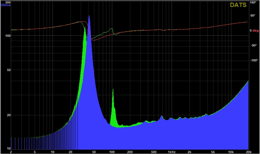

Here is an overly of one driver mounted in box with the back panel off
The other sitting on solid ground....
If you understand physics enough, Having the resonances at the same place, thats is, having the resonant peaks showing an identical trend as they do...while mount is mounted to a very rigid box, facing sidways, and one free stand on a solid surface facing upwards....shows that those resonances, ~300hz and up, are not sourced from anywhere but the driver itself....
Doesn't break up show in the impedance measurement? Is it just break up?
If not...its defective, plain in simple, unless you have something else to add..

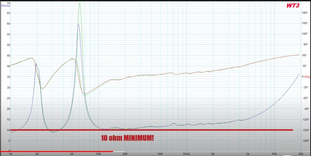

Forgive my frustration....You want a control, you've got one Here is the impedance measurement from the youtube review....it has the same trends in the curve.

My impedance looks not unlike the impedance of the youtube review....Whats wacky about it?

Blue is on ground?
And you dont have any noise around which has that spectrum? Refrigerator? Because now, the woofer is a microphone.
