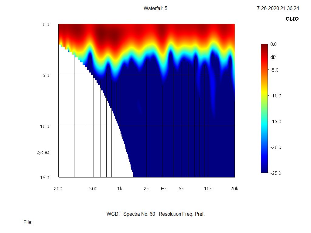

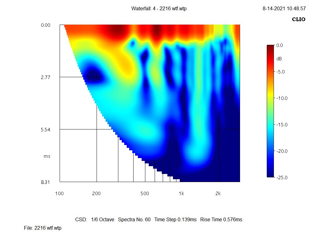

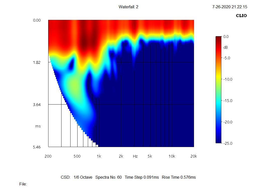

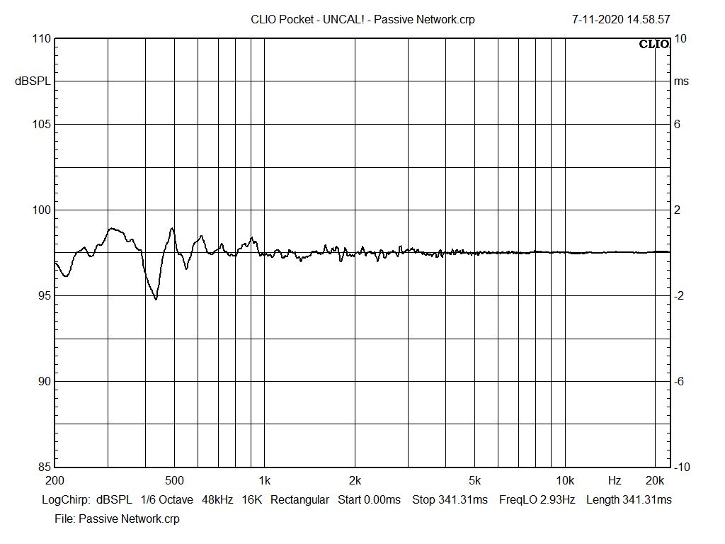

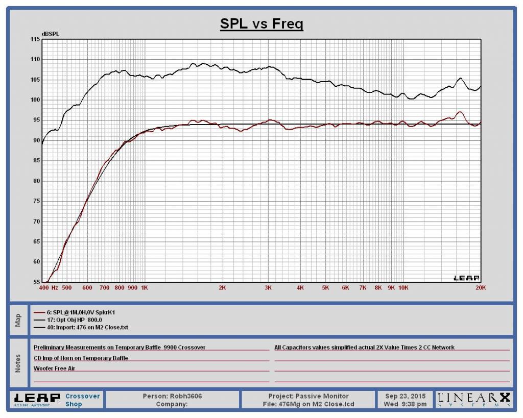

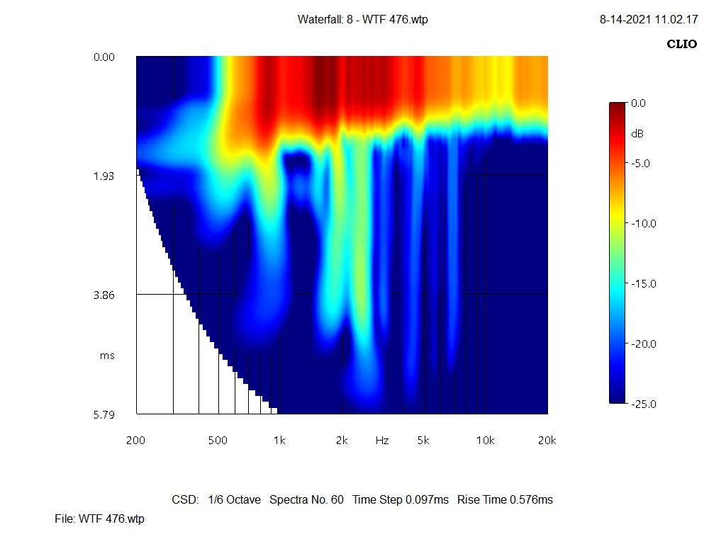

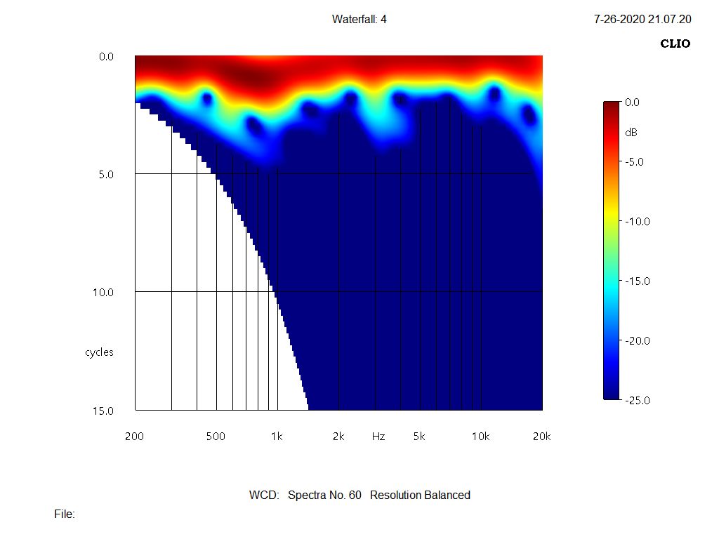

Not sure if this is what you are looking for. I have CSD/Wavelet for my 2 way down to 200Hz. Crossover is at 700Hz 15" woofer Waveguide 4" CD. This is an in room un-gated measurement so the room is in it as well. I added Group Delay as well.

It would be nice to see csd of the 2 drivers separate and un filtered to compare...
Otherwise burst decay would likely tell the story more clearly.

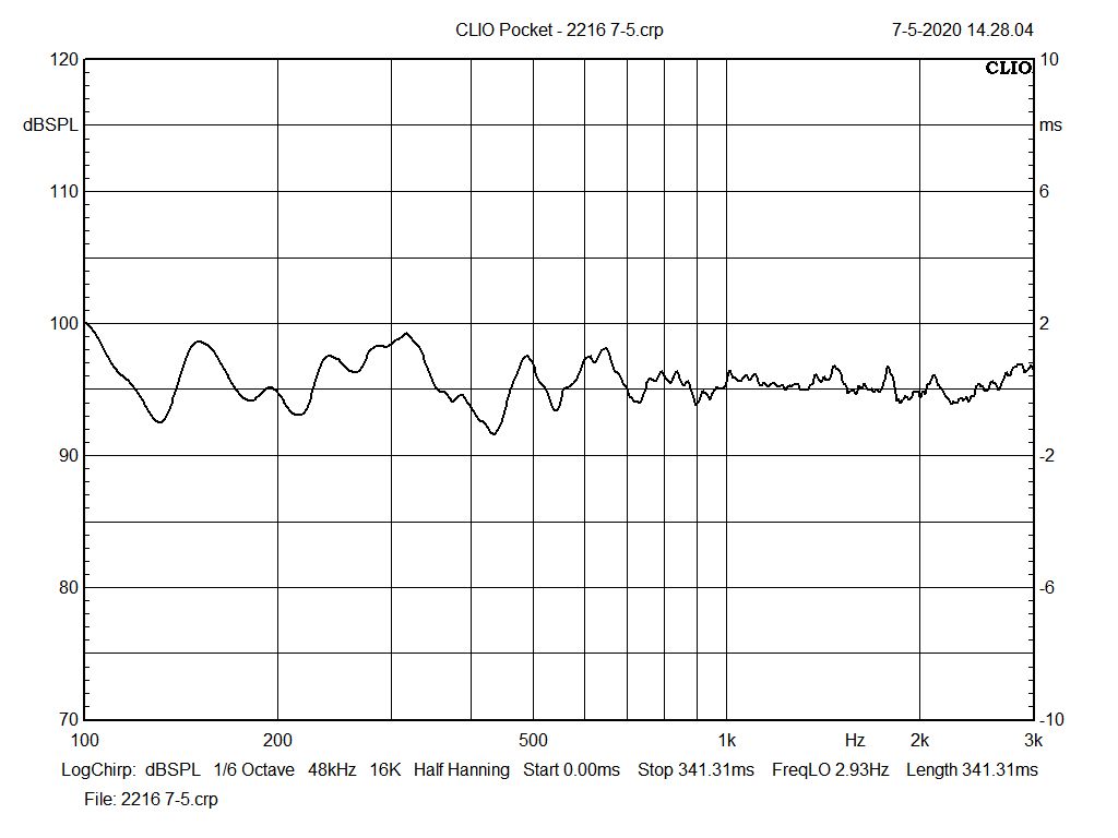

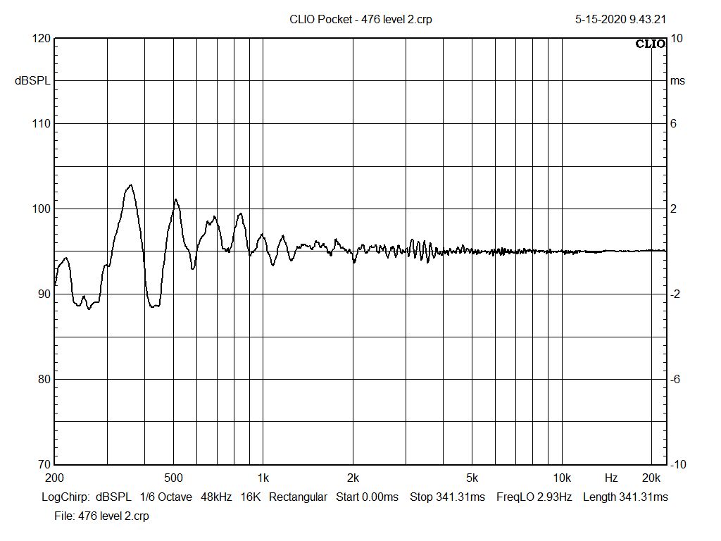

OK here are separately. Windows are not exact but close. Why are you concerned about separates when the system will be filtered and combined? JBL uses it @ 800Hz I went a bit lower to 700Hz or so. Depends on how you define cutoff. 700-750 is right on the knee so I am pushing things a bit.
On second thought Rob, it looks like you do have two separate CSD plots of each driver and you can see that the horn as tighter Decay times
They look pretty close to me especially if you account for the different time scales. Certainly not enough difference to worry about. The 476 compression driver is the the one that looks "wider" shorter time scale. Actually I think the woofer looks a little better?
