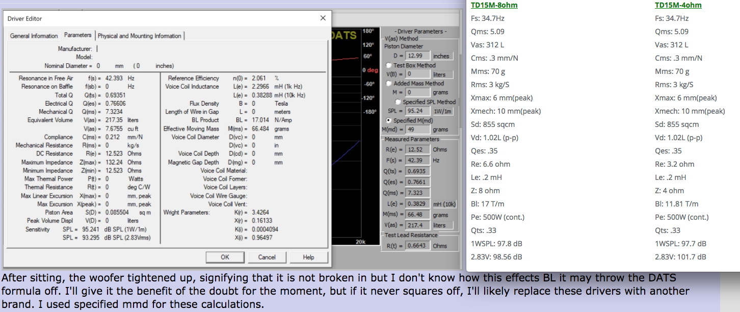

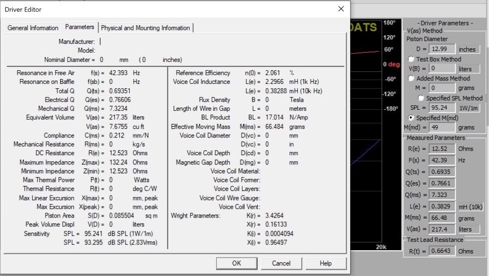

After sitting, the woofer tightened up, signifying that it is not broken in but I don't know how this effects BL it may throw the DATS formula off. I'll give it the benefit of the doubt for the moment, but if it never squares off, I'll likely replace these drivers with another brand. I used specified mmd for these calculations.

The "5dB low" DATS sensitivity you posted references 2.83v (1 watt into 8ohms) so automatically reads -3dB less for a "16 ohm" driver, which would require 4v for 1watt.
Adjusted for that, the sensitivity would be -2.27 dB, rather than -5dB less than the "8 ohm" (6.6 Re) version.
Yes, you should do a 1watt 1meter measurement (preferably outdoors) using 4v and expect 96+ dB in the upper frequency range to sound quite loud.
Again, per this: Thiele Small parameters equations - How each one affects the others
BL is BL, so calculating reference efficiency n0 yields the same 2.061% as DATs: n0 = (9.7822 * 10-10 * Vas * Fs^3) / Qes
Increasing BL, Cms or Fs will reduce Qes and Qms.
Increasing Re will result in increasing Qes. This can be done by adding a series resistor, but this will also affect the efficiency of the driver in a negative way.
A higher impedance peak at resonance will translate in a higher Qms.
Ergo, as a driver breaks in, Fs drops, Vas increases in complementary ways such that Qes, Qms, Qts remains 'close enough' the same; ipso facto, efficiency n0 stays 'close enough' the same and why [the better?] manufacturers [use to?] measure it as the only driver spec other than Fs [back only when it was the spec used as a main selling point] for quality assurance QA requirements.
Then maybe the Qts will come down too?
Yes. Measure at levels higher than "small signal" and your Qts values will change.
Some Morel drivers are measured at two levels - small signal and 1 volt.
The 1V numbers (if you saw them in isolation) would indicate a more powerful motor / magnet.
0.44 -vs- 0.36 (Qts)
50.5 -vs- 42.5 (Fs)
8.2 -- vs- 11.8 (VAS)
Roughly a 20% difference.
Higher levels can get a ~35% difference.

Ok ok ok I see it now....sooooo....I could say that BL is also being skewed because of this 2.83V issue or no?
I just grew a brain and hooked up the multimeter to the output of the dats to check voltage....as it sweeps I get a peak at 2.5v it could be due to many things but this thing definitely ain't hitting 4v....the predicted 1w/1m is only off a few db.
So that still leaves BL....No idea what Formula this thing (DATS) use's to calculate BL....

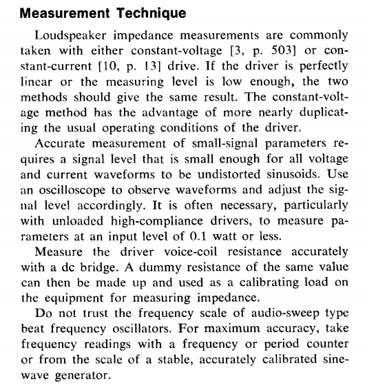

The parameters can vary quite a lot with applied voltage so to make any comparison the voltages need to be the same as the manufacturers conditions.
This is from Small's original paper
http://diyaudioprojects.com/Technical/Papers/Direct-Radiator-Loudspeaker-System-Analysis.pdf

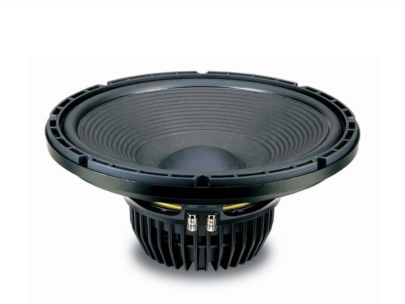

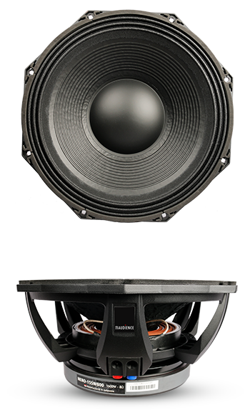

Dear all,
Seeking opinions on whether either of these 15" woofers be viable candidates that meet the high spl, low distortion (extended bass response) requirement here?....
18 Sound 15NLW9500-8
or SB Audience NERO-15SW800

I have four of these Eighteensound woofers. So far I have only listened to them as a short informal test right after delivery. The manufacturer does indeed recommend them for studio monitor use. But he does also recommend to use then only up to 500 Hz. With a large horn they could therefore be used for a two-way system. Maybe they even work nicely slightly higher than 500 Hz. When I find the time in the next few weeks I will mount them in my existing two-ways to see how they perform with a crossover frequency of 650 Hz.

Both are typical LF woofers and personally I would use another driver for such a high XO point.
If I had to choose, based on the data in the spec sheets, I'd take the 18Sound because of the rising response with frequency and the impedance staying more or less flat > 1000 Hz (with a small step at 500 Hz, where you'd ideally cross this driver).
Le is considerably lower as well.
