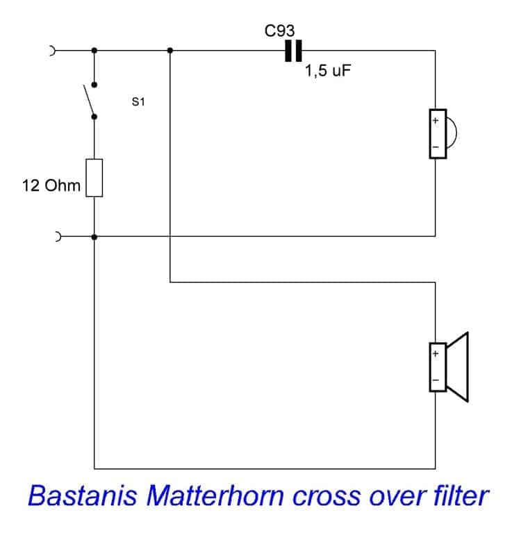

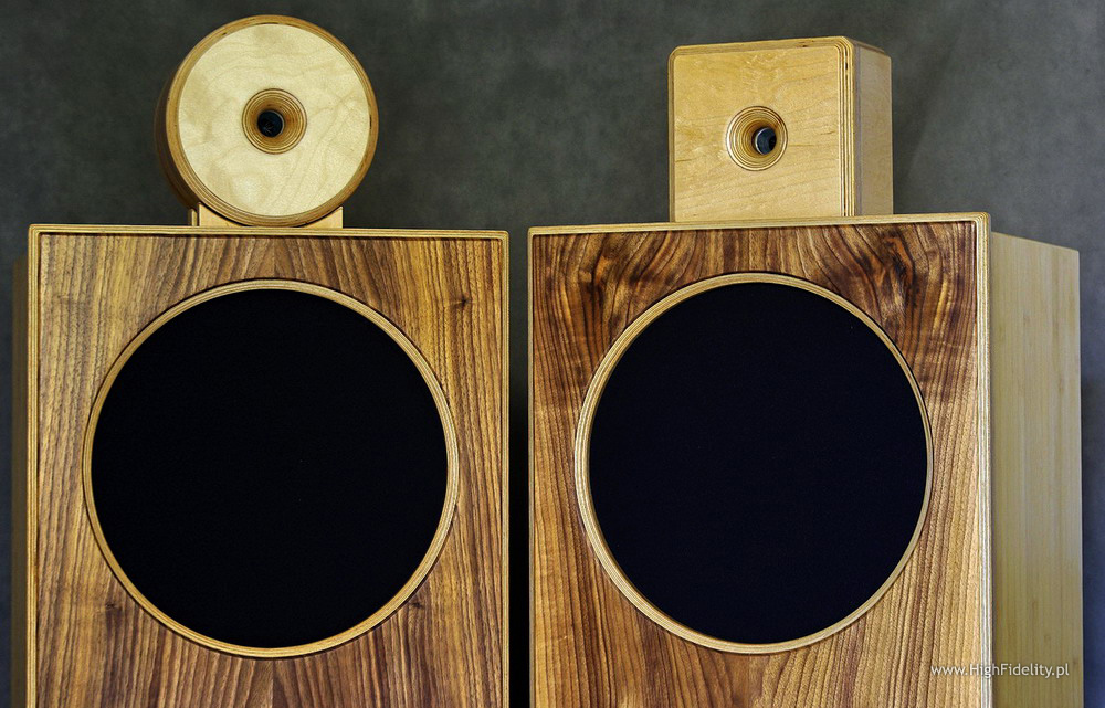

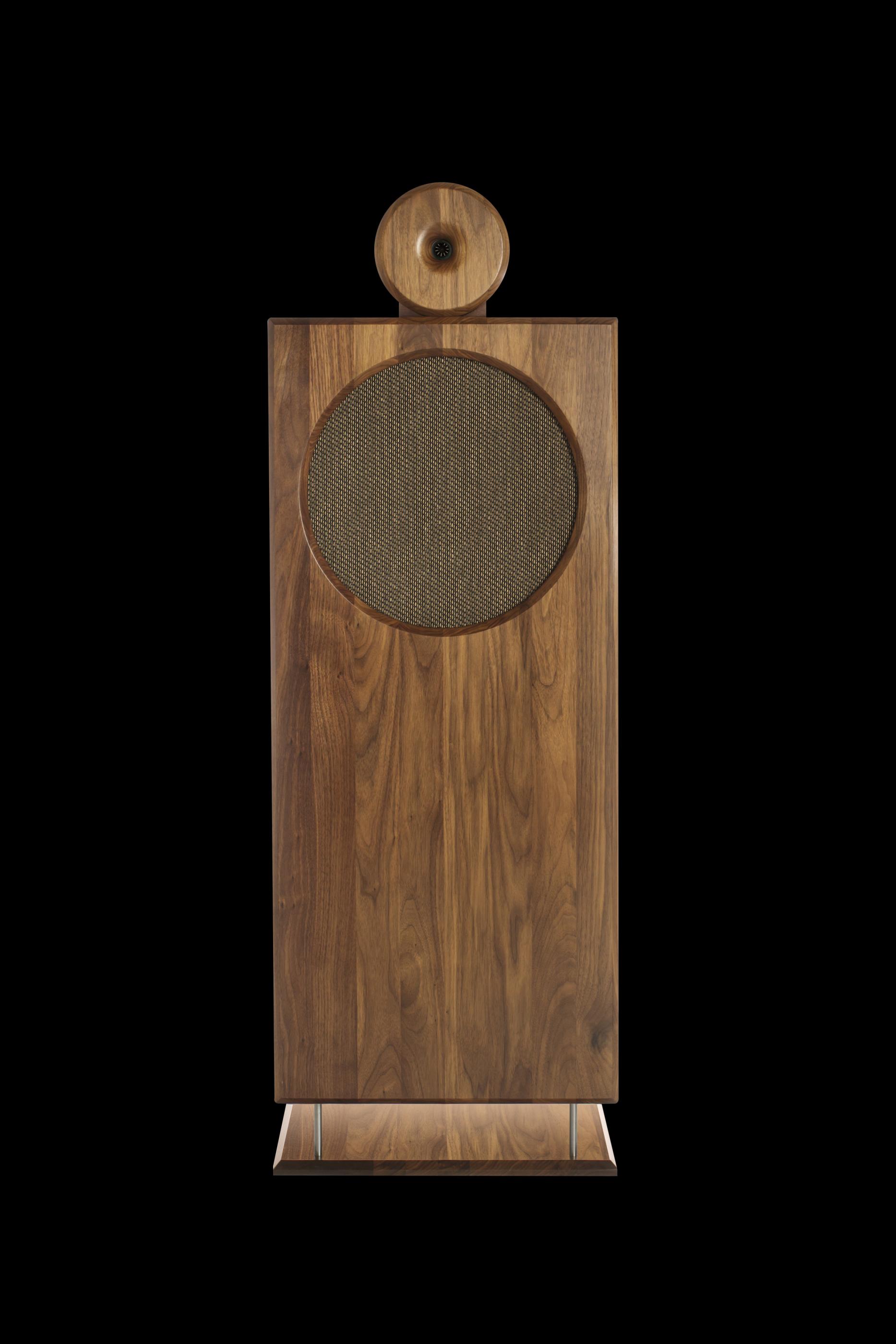

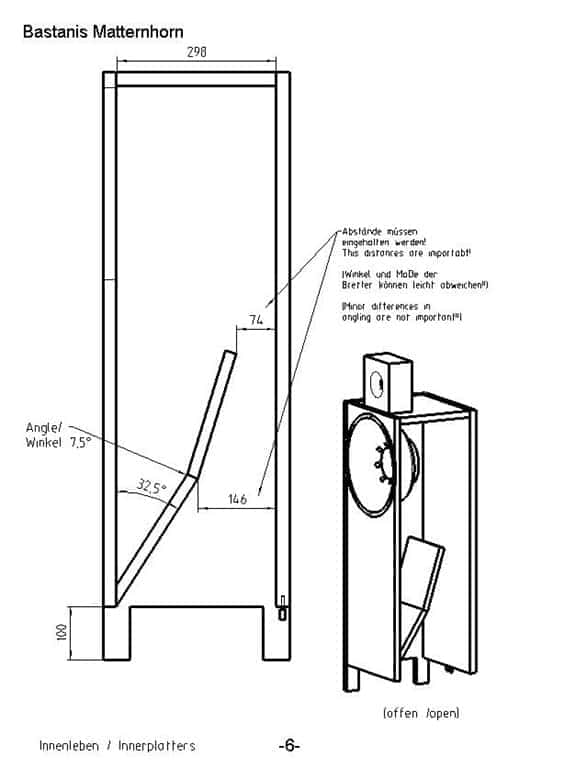

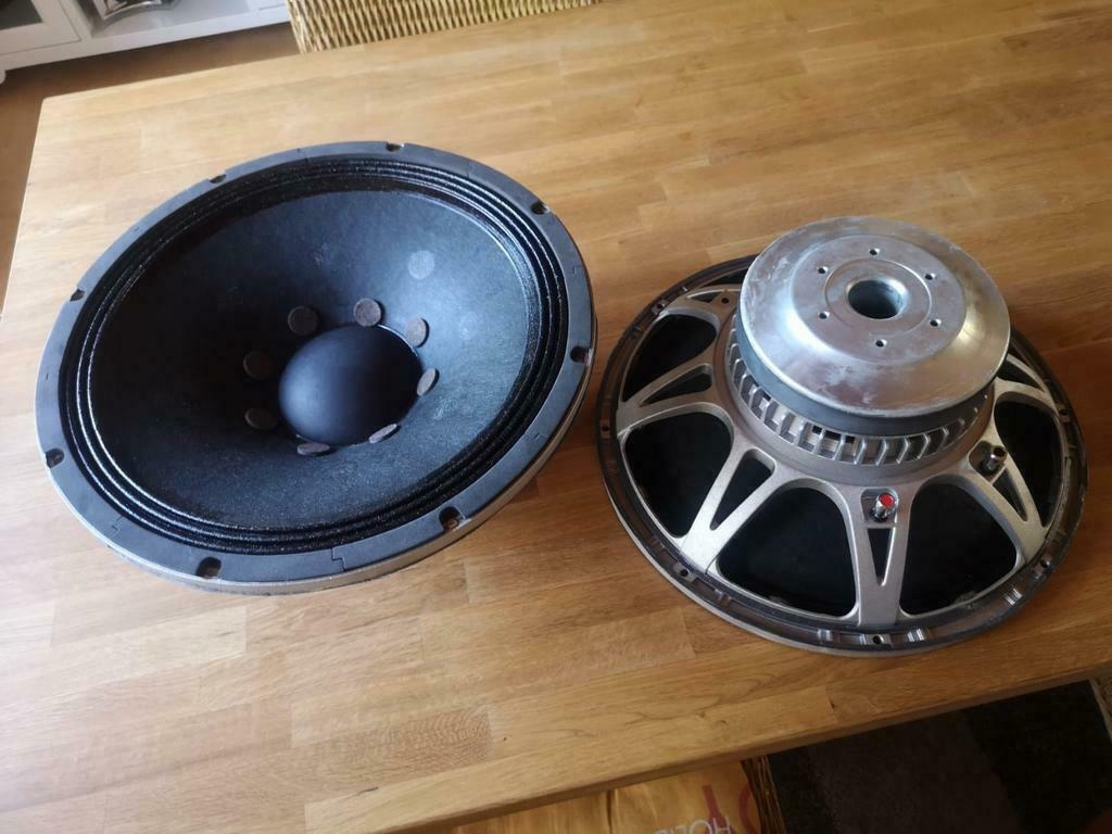

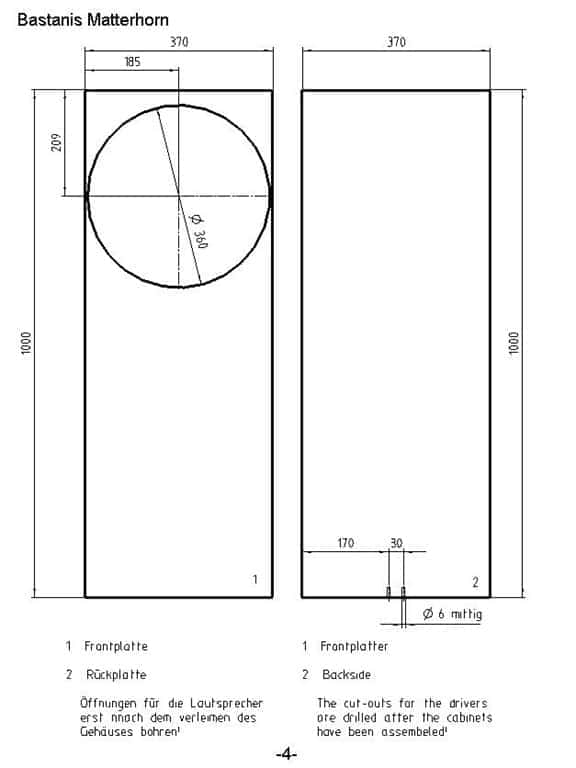

The Bastanis Matterhorn is more of a wideband 15" + tweeter instead of a 2 way system. However, the BLH could be adapted with a bigger horn and a more sensible crossover frequency.
The drivers are from Oberton and the woofer looks like a modified 15MB500. It's a nice driver with an extended response, but no 15" should be crossed above 1200 - 1500 Hz imo.

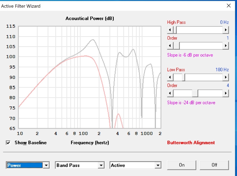

The lower section is going to look something like the above (I think I use a deeper 2nd order XO in
VituixCad to achieve similar results...the above is one peak filter on top of the resonant note around 150-180hz and a low pass...I could of just used a 4th order LR low pass at 130hz for similar results).I have to get the null section down below -25db to keep the output homogenous (lol)....Do I need to put damping material in this box? I believe I've read that damping material doesn't do much for bass boxes?
