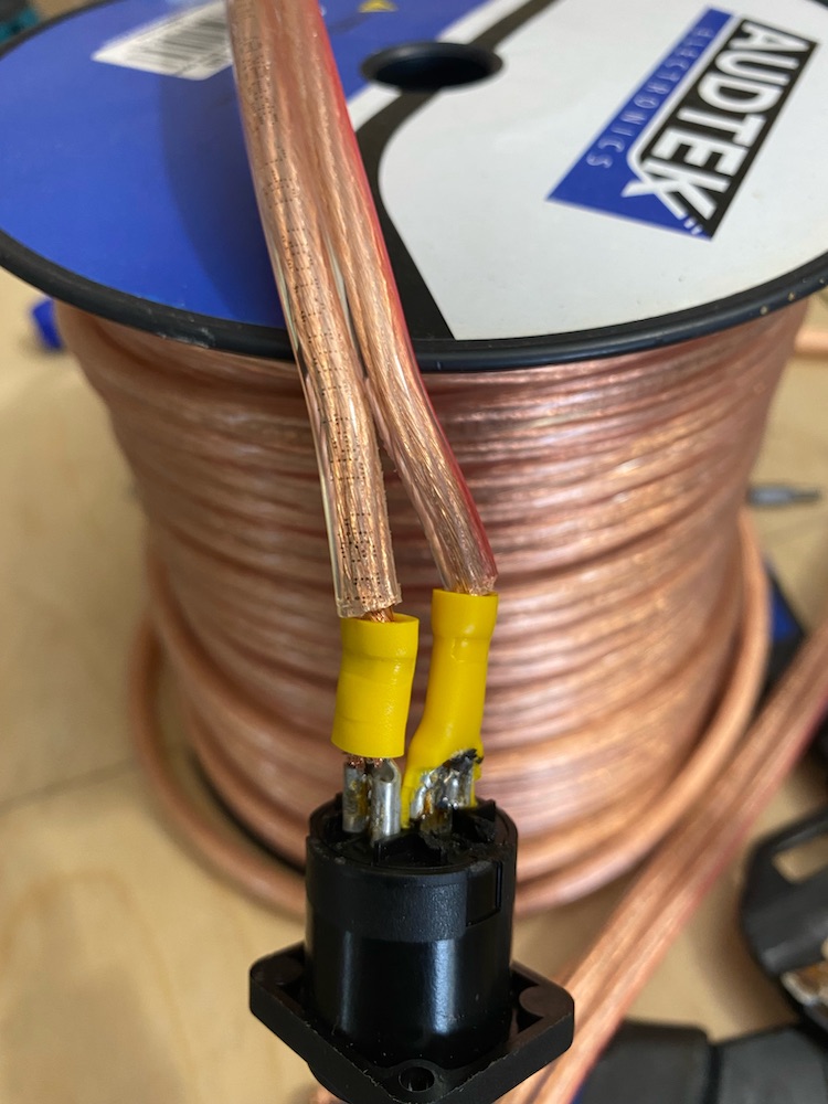

I think this will fly...I had to augment an insulated to protect the two connections from each other...first time soldering...the connects are solid. Fingers crossed lol.
I couldn't let anything like that exist in my equipment 😉
I can recommend uninsulated crimp connectors and some heatshrink over the top.
The back of the crimp digs in to the wire insulation as a secondary lock.
5-160431-2 | TE Connectivity, FASTON .187 Uninsulated Spade Connector, 4.75 x 0.51mm Tab Size, 1mm2 to 2.5mm2 | RS Components
The pliers needed to make a nice job of the crimping can be had from any auto parts store or online.
Why would you spend all that money on drivers, birch ply etc and then butcher your interconnects. If you want to solder why not solder the bare wire straight to the speakon and slip some heat shrink further up the cable jacket so you can pull it down to cover after soldering.
It's simple, you tin the wire, you tin the connector, put some solder on your iron tip and bring them together with some heat. Crocodile clips or other clamps to hold the two pieces in place. Flat pliers or haemostats are helpful to hold the wire and avoid burning your fingers.

Insert the plug into the socket before you solder.
This way the plug acts like a heatsink and helps reduce the chance of overheating the socket tab so that you get a bit more rise time to avoid melting the socket's plastic body, if that makes sense....
Another tip: make sure the two parts you are soldering stay put exactly how you like them to be, and dont have tension to them, before you solder. It is difficult to solder if the parts disconnect the second you touch them with the iron, or are already disconnected before you start. The alligator clip helper /extra hand can be annoying sometimes, altough necessary. Happy soldering 🙂

For speaker wiring, use the Neutrik Faston crimp connectors fluid showed.
Crimp. No reason to solder....at all, ime.
With 30+ DIY speakers & subs, some spanning over 20 years service....zero problems to date with wiring using crimp connectors.
(mic/line level XLR connectors get solder).
