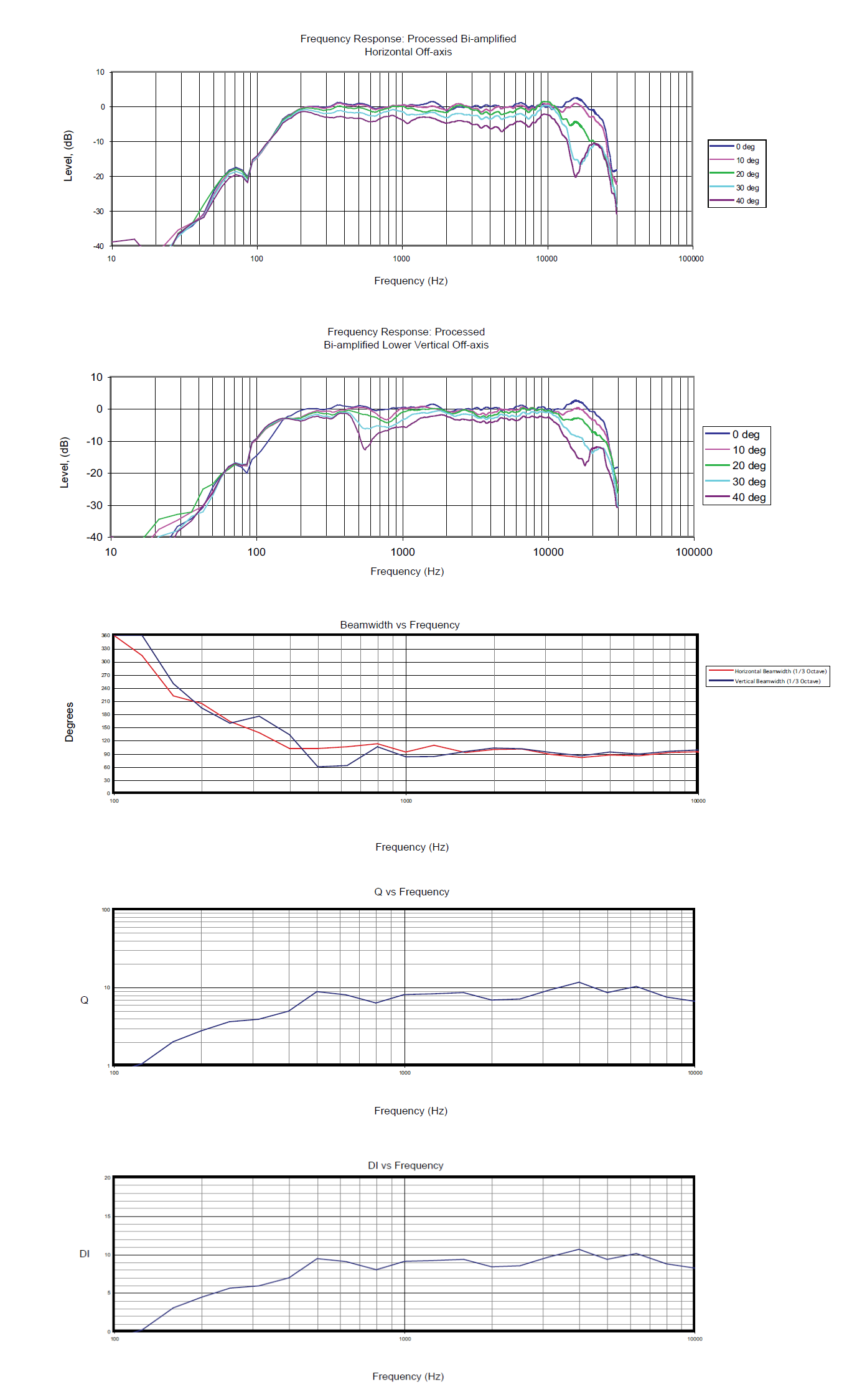

This is from Earl's philosophy document
With the higher frequencies under control, this leaves the mid frequency aspects of the problem to be addressed. First it is essential to match the directivity of the woofer to that of the waveguide. This is a necessary requirement, but one that is often ignored. It is not enough to simply use a CD device in the system, one must insure that the entire system is CD and this means that the LF driver must have the same polar pattern, at the crossover, as the waveguide. A simple investigation will show that only large woofers can provide this feature since a smaller woofer would require the crossover point to be much too high before the polar pattern was at or below 90°. When a piston woofer is used, CD can only go down to just below the crossover point, so the crossover point needs to be as low as practicable. A 15" driver is the smallest device that can be used if a crossover point below 1 kHz is to be achieved. The woofer in the Summa system is 6 dB down at 45° at 800 Hz. Below this frequency their directivity begins to widen. Matching a 15" woofer to a waveguide at 800 Hz is a workable solution. A narrower directivity than 90°, or a lower crossover point would require an even larger diameter woofer, like an 18" and an even larger enclosure. The matching of a 15" driver with a 90° waveguide at 800 Hz seems to be, if not the ideal choice, certainly one of the few workable ones and optimal for a reasonable sized system. The smaller Geddes systems have to compromise on the above requirements, mostly at the crossover. As the LF driver and the waveguide gets smaller the crossover point must move upward and the control of the directivity become slightly less than the full size system. The Summa appears to be nearly ideal, but the Abbey is surprisingly close given its dramatically smaller size (and cost).
In order to be CD in all angles around the system (vertical and horizontal), the waveguide must be axi-symmetric, simply because the woofer is axi-symmetric. The waveguide will be found to require a mouth size that is exactly the same area as the 15" − which is not a coincidence. Smaller mouths do not allow the coverage pattern control down to the crossover point and a larger mouth would not offer a significant advantage. It is clear that for optimal performance in a small room the size and composition of the system components are not really a matter of free choice, but are dictated by the system requirements. Smaller enclosures require a compromise in system performance – most notably directivity control. Larger components might offer a slight advantage, but the current choice seems to be the best compromise – the sweet spot if you will.

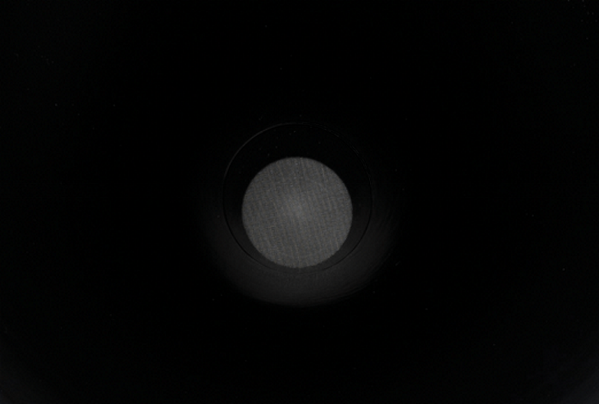

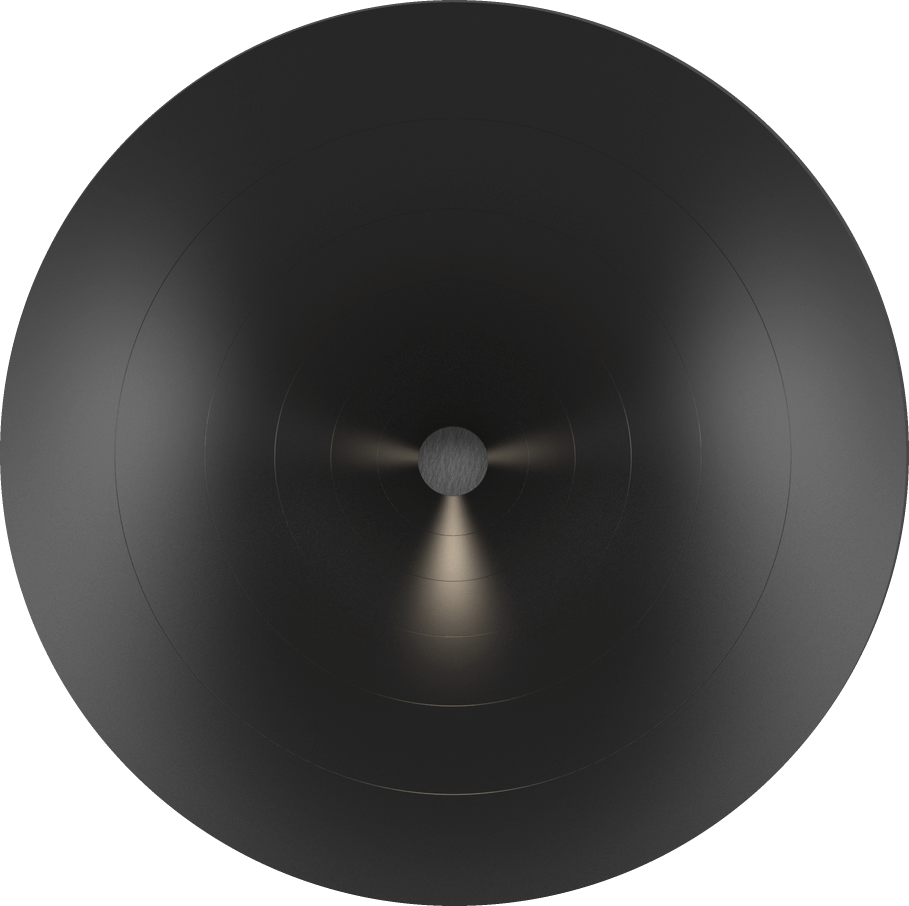

There may be a horn profile that includes the 'best of all worlds':
- It is mathematically defined by a fairly simple equation, at least for an axisymmetrical horn.
- It contains a cutoff frequency.
- Coverage is almost perfectly controlled between < 500Hz - 10kHz.
- The throat area is as clean as possible.
