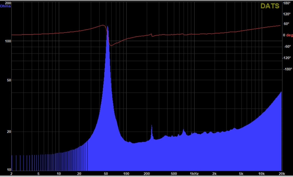

When in the box did you do the Impedance sweep or measure free air parameters? I have never used that particular device but impedance sweep would seem the correct option for in box usage.
All the above...at least in free air I can say I believe I used the dats correctly....Fs is not where it should be. When I measured the 18h+ the specs not only lined up, but were a little better than advertised.

You can try and exercise the driver by playing 10Hz tones through it for a while.Fs is not where it should be.

35ish Hz expected and 55Hz received could just be new stiff woofer parts. I would manually massage the spiders and give the cones a good few solid manual pushes both ways to loosen things up. Maybe this on top of fluids 10Hz suggestion?
Qts will drop with the loosened soft parts but 0.9 delivered down to 0.33 expected may not happen but IDK.

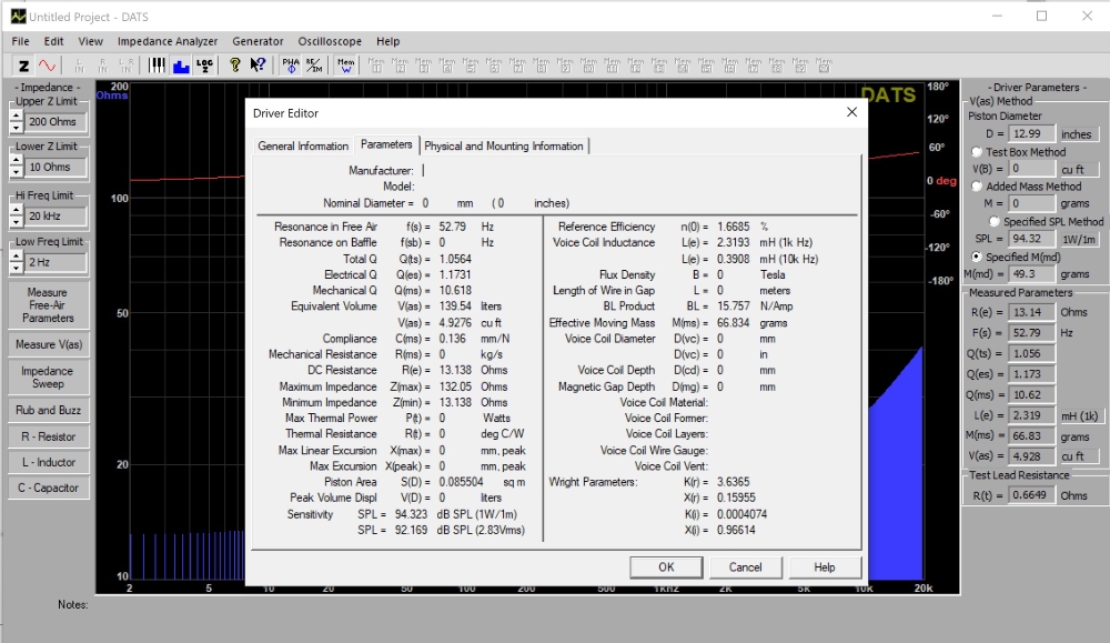

Alrighty...I wasnt born yesterday, as a woofer "breaks in" compliance goes up, not down....the Q of my 18h+ measure just fine. Fs goes down as compliance goes up, simple physics unless someone knows something I don't.
So I may be jumping the gun here. Somehow as cms goes up....qts goes down...makes no sense to me...
0.6 is what I'm getting in free air...the box is built around 0.33 hence the freak out. I will see what I learn tomorrow. pray for me lol

After some more investigation it seems that qts lowers as fs lowers...how much? Hard to say right now...
I was able to get a correct reading for BL on the 18H+ but the 15m is reading 17tm...it should be near 27 for the 16ohm coil...John pointed that out...I have confidence that either my readings are wrong or if not, this issue will be resolved. No worries

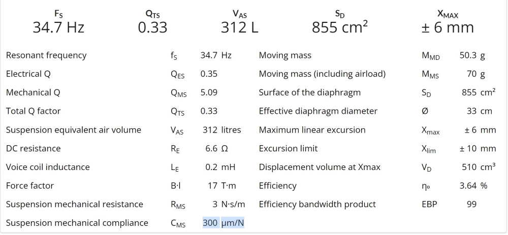

I got the effective Diameter from John...Mmd should be close (1 gram less than 8 ohm version)...his predicted Mms, as a result, is on point. Sd is good...He commented about the squiggles in the impedance, suggesting that "something" is moving...Those squiggle are in the woofer that is mounted in the box....and in the complimenting woofer that I tested unmounted in free air. So if "something" is indeed moving where do you think that "something" is? The "something" is showing the same trend as well so whether in the box or on the floor the same "something" is moving.
Dats is calculating a lot of these specs based off of specified MMd, Re, fs, Q, le...
Cms is incorrect compared to listed...Vas is off....Bl should be near 27 according to John... The formulas and math are over head. I need the help of the board to get to the bottom of this.

Latest piece of evidence....Fb is about matching according to Hornresp (51hz)....In free air Fs should be 34hz but is reading as 49hz

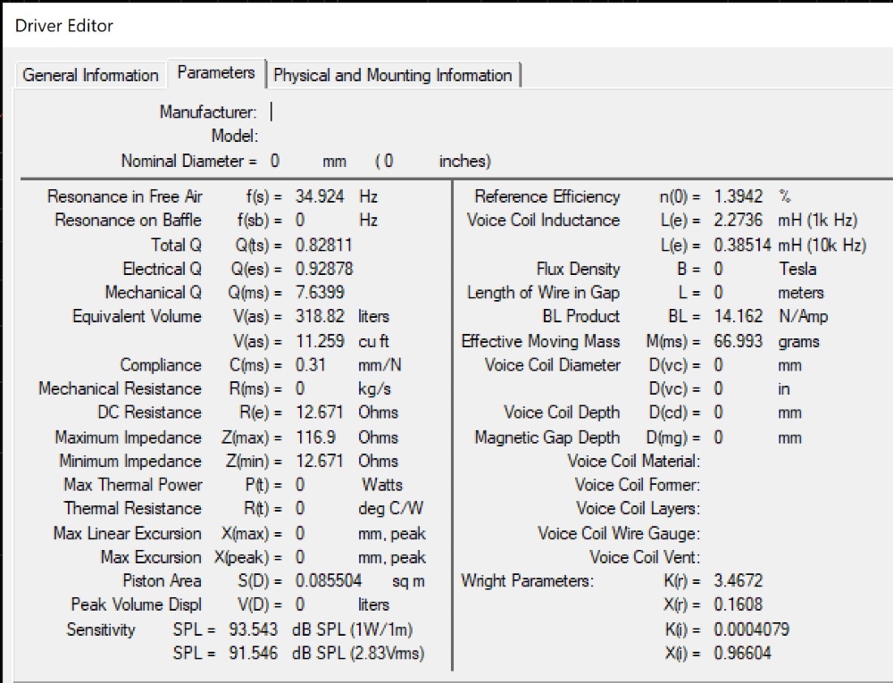

So these are the specs after the several hours at 10hz....I sent this screen shot to John. Still no response from them since 2 days ago. Any comments?
This is what John told me last we spoke.The Fs will go down over time. We can either have spiders that start at the intended parameters and settle to a point 25% lower over time, or spiders that start out higher and settle to the correct point after significant use and then stay at that correct point. This also lowers the Q's as well
Hmm, looks like they 'dropped the ball' big time on this one, the reference efficiency's are way too different to ever line up.
FWIW, specs are normally off, but if its reference efficiency is +/- some reasonable percentage from the ideal at QC testing, then you can count on them breaking in/working as designed per the ideal specs, but 3.64% Vs 1.3942%? No way!
Yours are already down to ~ the Fs, Vas specs, so obviously there's no way Qt is going to plummet down to a much more powerful motor.
