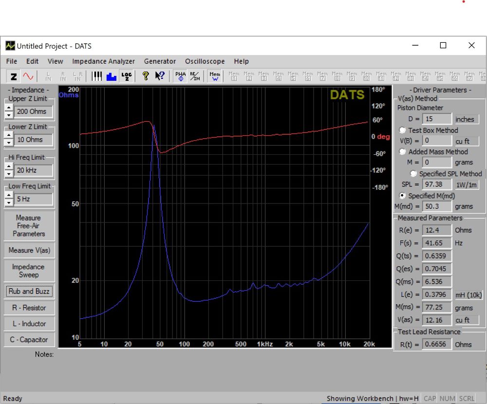

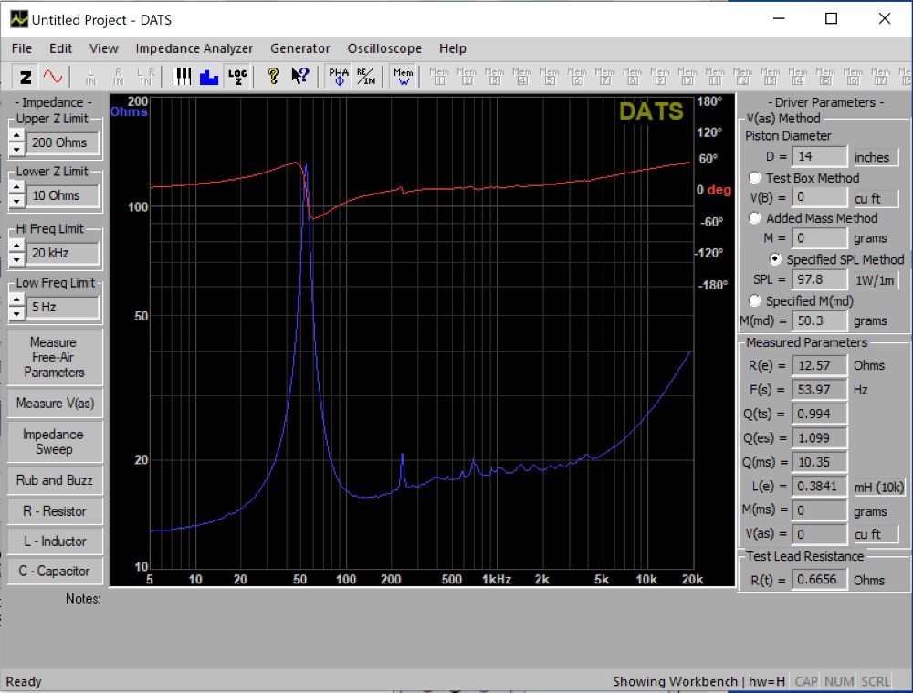

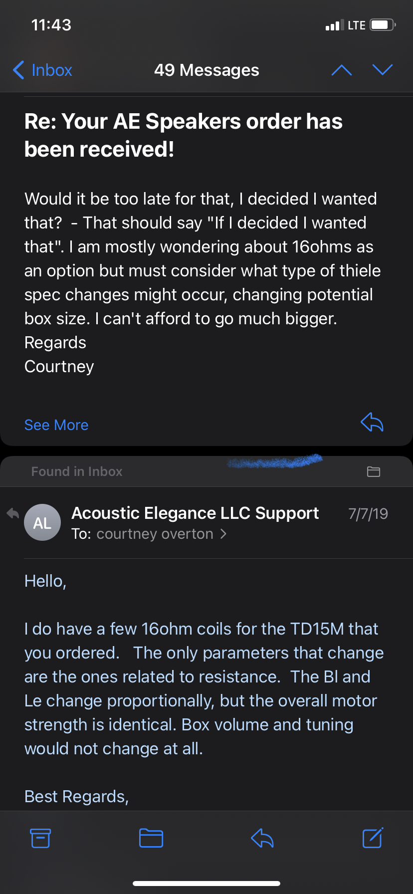

Regarding qts...I couldnt get a q of 9 with a box half the size of the 231liter box I'm using...according to hornresp...its gotta be the density 80....or the 16ohm voice coils...I havent asked John yet...or am I using Dats wrong...free air measurement within the box should give me box Q right....the impedance curve looks an undampermed box, fs is 50hz.

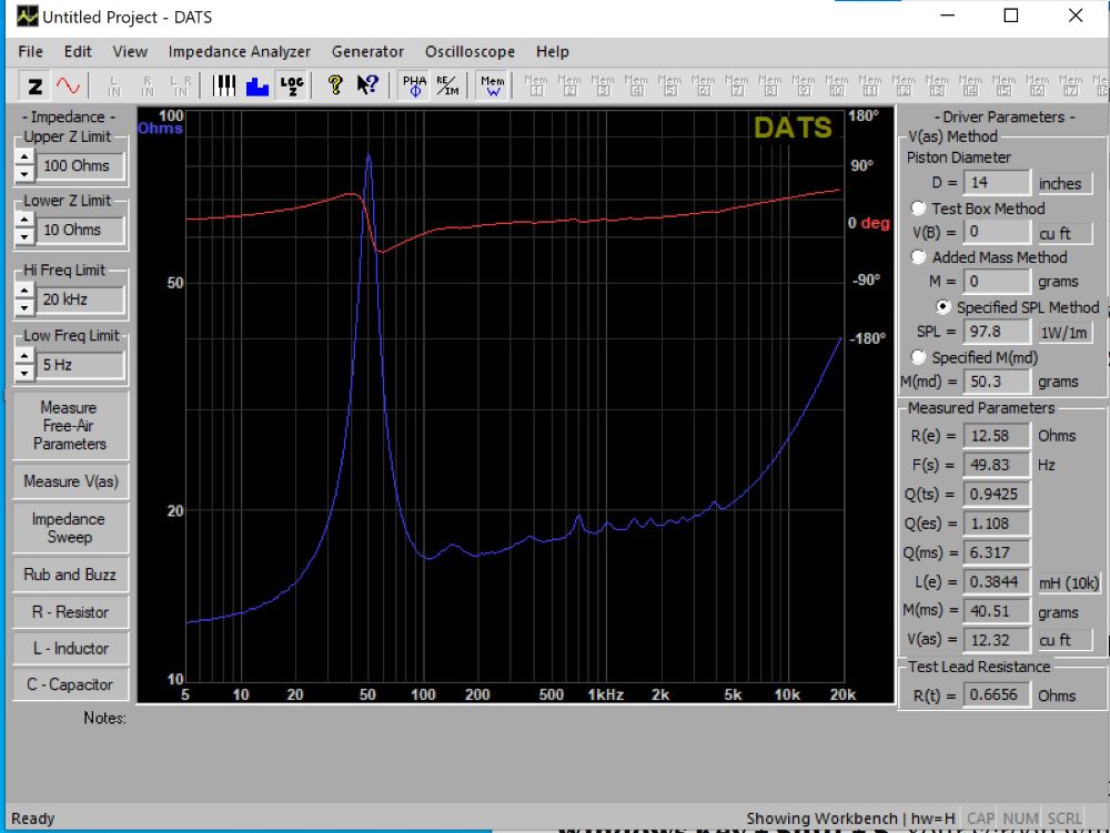

Guess I'll shoot John an email....I took all the damping material out and
Am I even interpreting this right? Should qts read as qtc within the box?
When in the box did you do the Impedance sweep or measure free air parameters? I have never used that particular device but impedance sweep would seem the correct option for in box usage.Am I even interpreting this right? Should qts read as qtc within the box?
