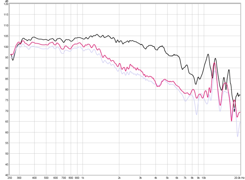

Reckon I can cross this around 800hz?

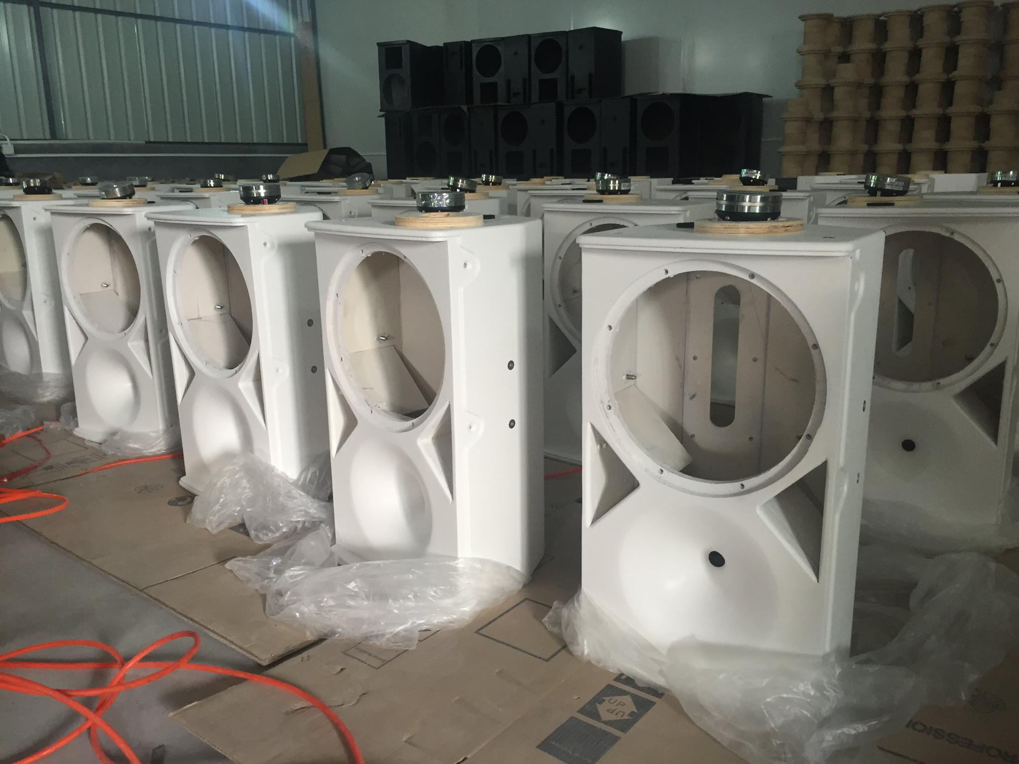

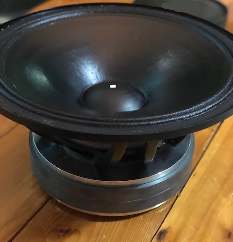

I wanted to cross low, I got the "long throw" version of that horn (30cm long) from the same vendor, and mounted it in a gutted PA cabinet. I used lots of filler to blend the horn edge into the cabinet, as shown.
This is the response (with mic right at horn mouth).
Black line = old 16ohm compression driver.
Coloured lines = new 4" cone drivers

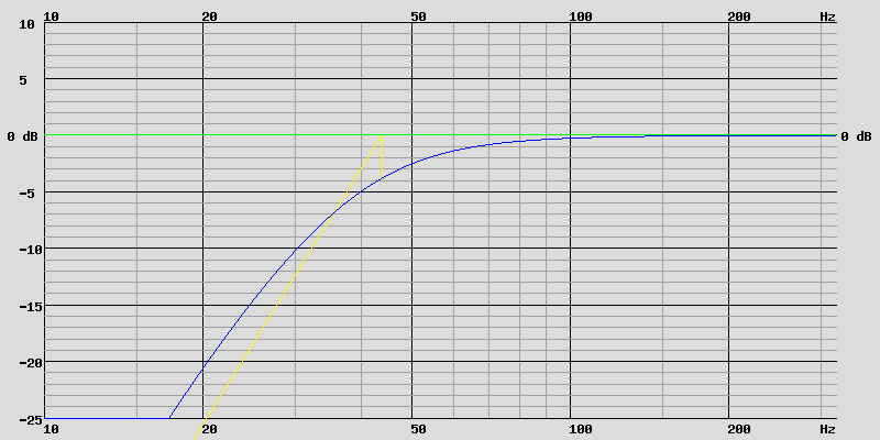

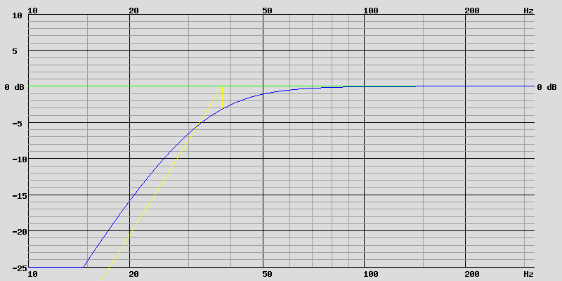

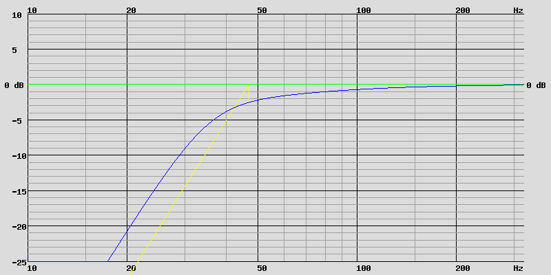

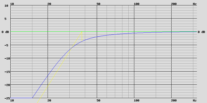

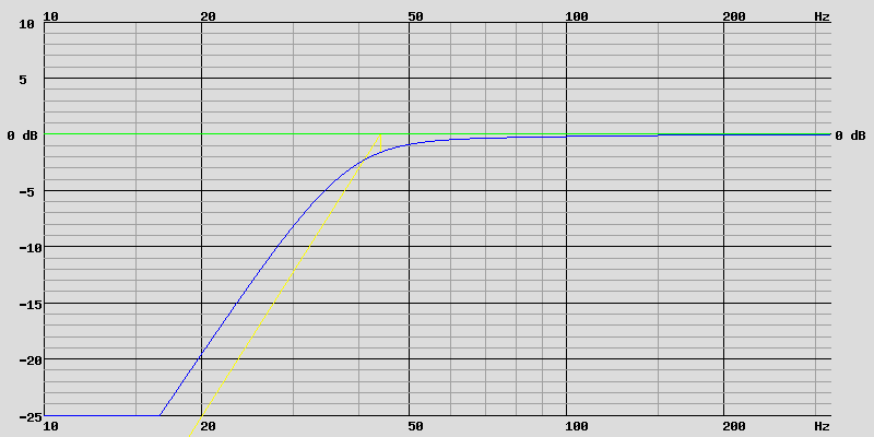

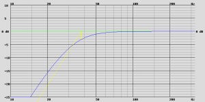

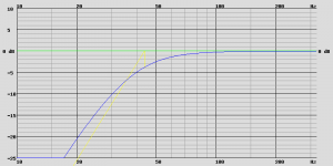

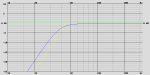

Comparison of some respected 15" woofers:
- TD15M 8 Ohms, VB = 180.0 L, FB = 35.0 Hz
- Faital Pro 15PR400 VB = 180.0 L, FB = 35.0 Hz
- TAD TL-1601A, VB = 180.0 L, FB = 30.0 Hz
- TAD TL-1601B, VB = 180.0 L, FB = 30.0 Hz
- TAD TL-1601C, VB = 180.0 L, FB = 35.0 Hz
- TAD TL-1603, VB = 180.0 L, FB = 30.0 Hz
Both the TD15M and 15PR400 are on average 2dB more sensitive than the TADs, but the TADs are (by a very small margin) kings of low frequency extension.
Personally, I wouldn't bother about the latter in my room.

Both the TD15M and 15PR400 are on average 2dB more sensitive than the TADs, but the TADs are the kings of low frequency extension.
Is this a audible in home environment?

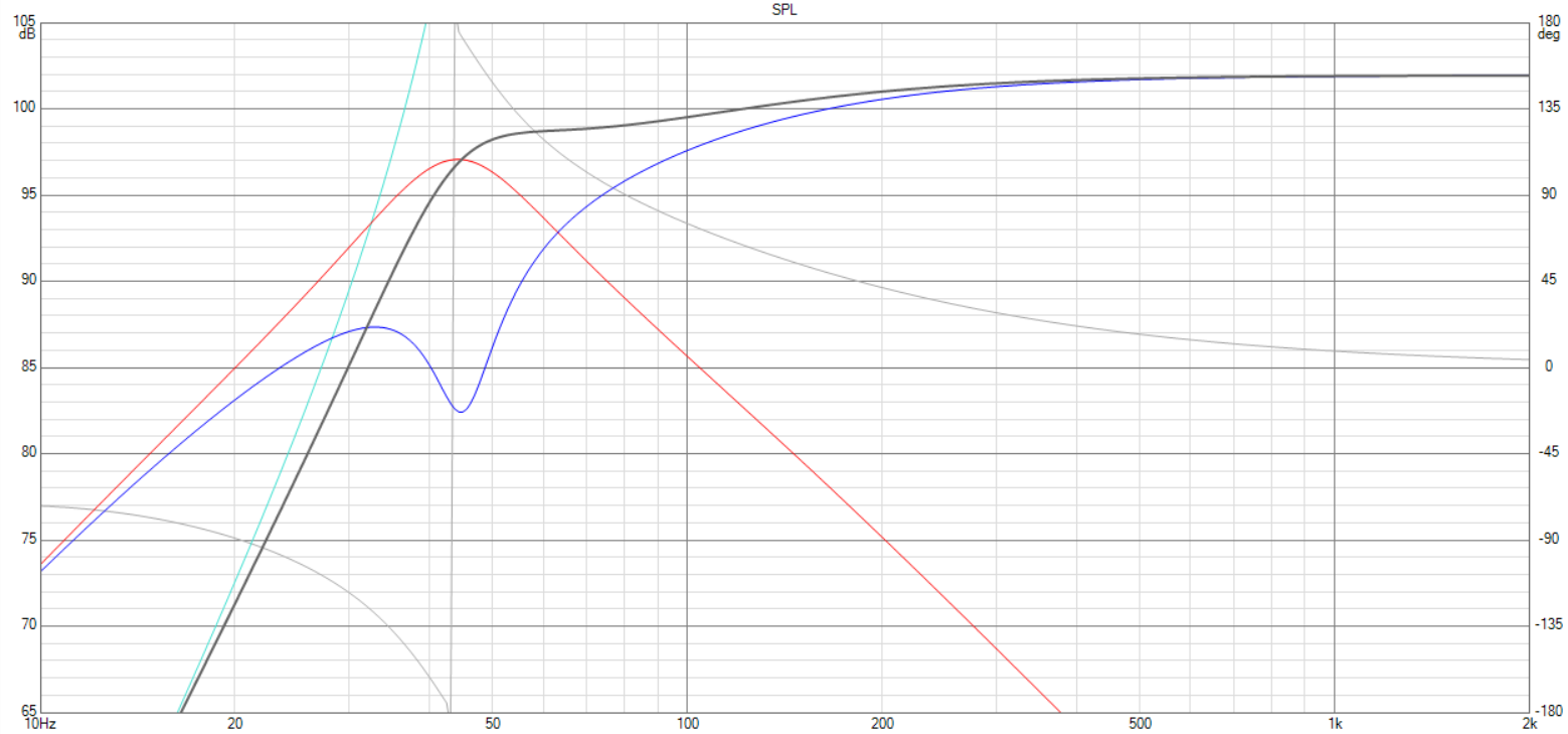

Illustration of relativity of low freq. extension versus efficiency. Taking 2 to 3 dB baffle step around 200Hz into account, what's left is 98 dB sensitivity at 50 Hz (red is port output).
The difference is not just a matter of amplifier current.

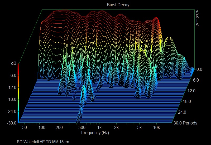

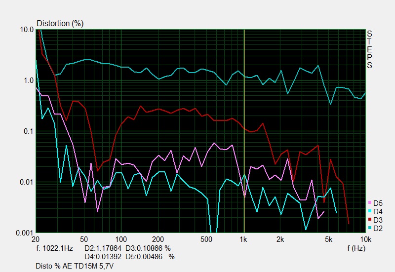

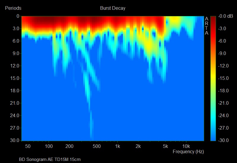

Regarding measurement data of woofers, there are only 2 truly relevant plots imo: IMD and burst decay. The sonogram is useful as a backup.
Unfortunately, these plots are rarely published.
Some plots of the TD15M (harmonics at 5.7v (about 103db / 1m)).

You can read about the difference between periods vs ms and BD vs waterfall in the Arta manual (paragraph 6.5.4, page 120).
