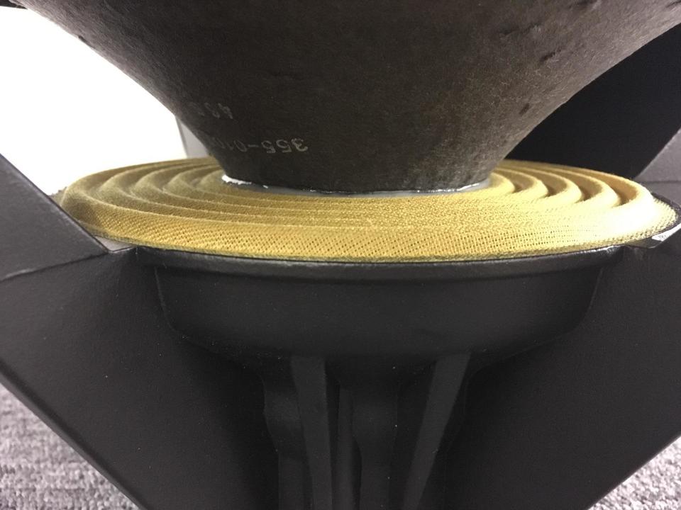

It's a stunning piece of engineering, no doubt, but it seems to be a kind of double-edged sword: a subwoofer with midrange aspirations, or the other way around.
A heavy, straight-sided cone with concentric reinforcing ribs, but also exhibiting the rising response that's typical for mid woofers.
Again, no doubt about the performance up to about 500Hz, but the crossover frequency at 800 Hz for the M2 may be a little too much of a stretch.
In the impedance curve this seems to be confirmed > 2 irregularities between 500 and 1000 Hz.

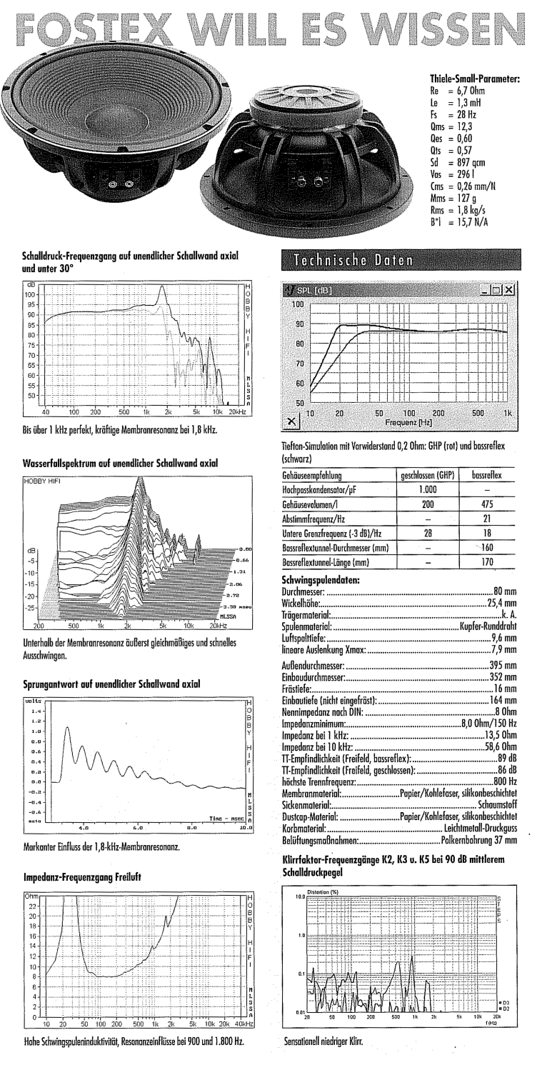

This woofer shows very low distortion figures in the test by Hobby-Hifi.
Marco crosses the woofer at 600Hz, which makes sense considering the first anomalies at 900 Hz.
This woofer looks like a typical large format sub(bass) driver for hifi purposes.
A really big (475 L) BR enclosure is needed to achieve the lowest -3 dB.
Like most subwoofer drivers, this one is also quite inefficient
In my current apartment -3 dB below 40 Hz is overkill and even undesirable in relation to the neighbours, but also because of room modes.
