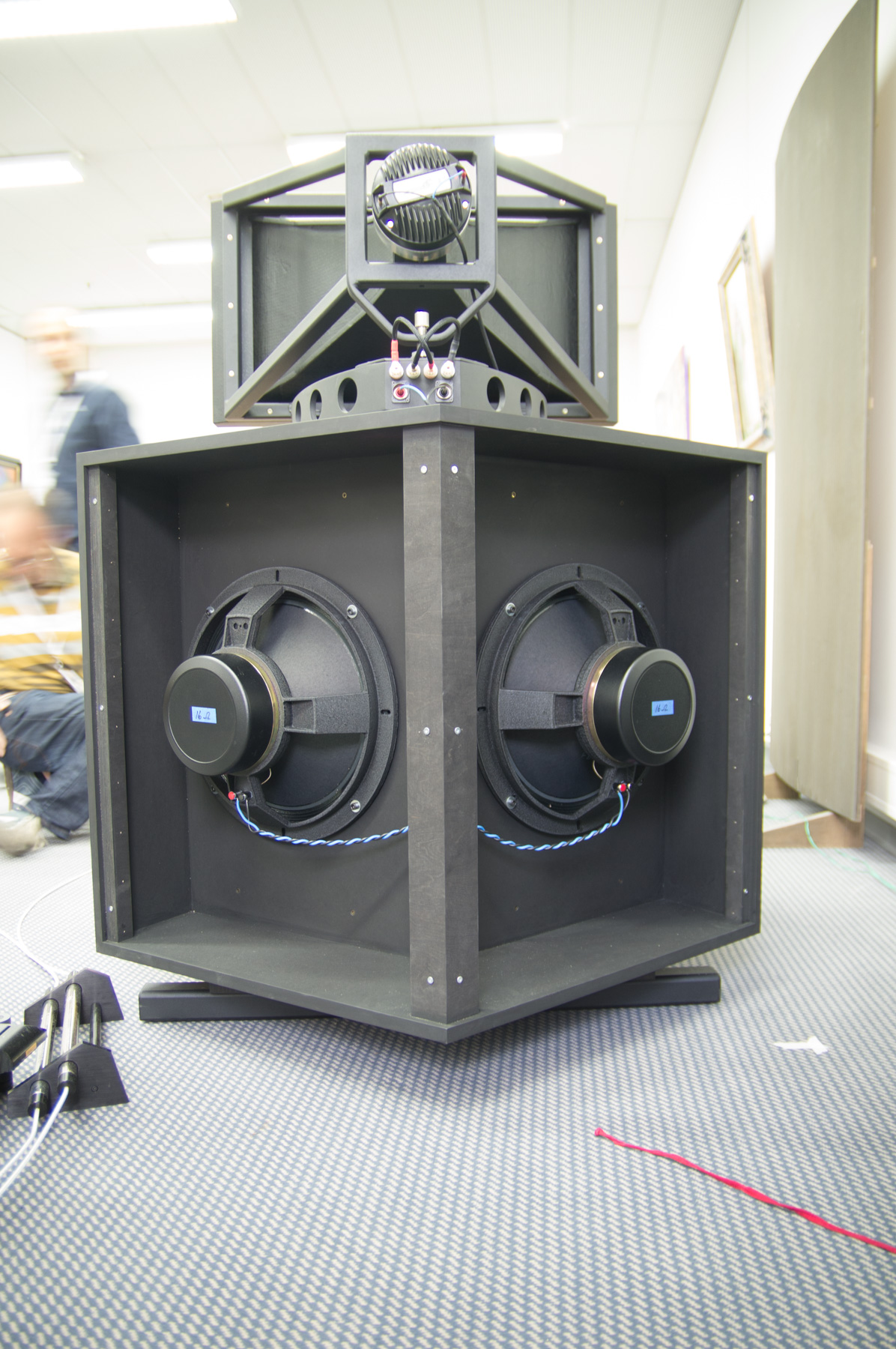

I still believe a large 2 way, crossed around 500Hz, should suit most needs.
With the exception of dedicated subwoofer drivers, most 15" woofers are devoid of IMD, nodal resonances, radial modes etc. when operated over a limited bandwidth. Horn loading dual 15 woofers further improve things.
Together with the previously mentioned horn loaded OB Bass array from BD-Design, this 2 way should also meet the thread title:
I agree with you here. But, I do think that dual 15s is over kill and "horn loaded" is more appearance than performance. For PA this might be required but, for the most part here at DIY it's home use only.

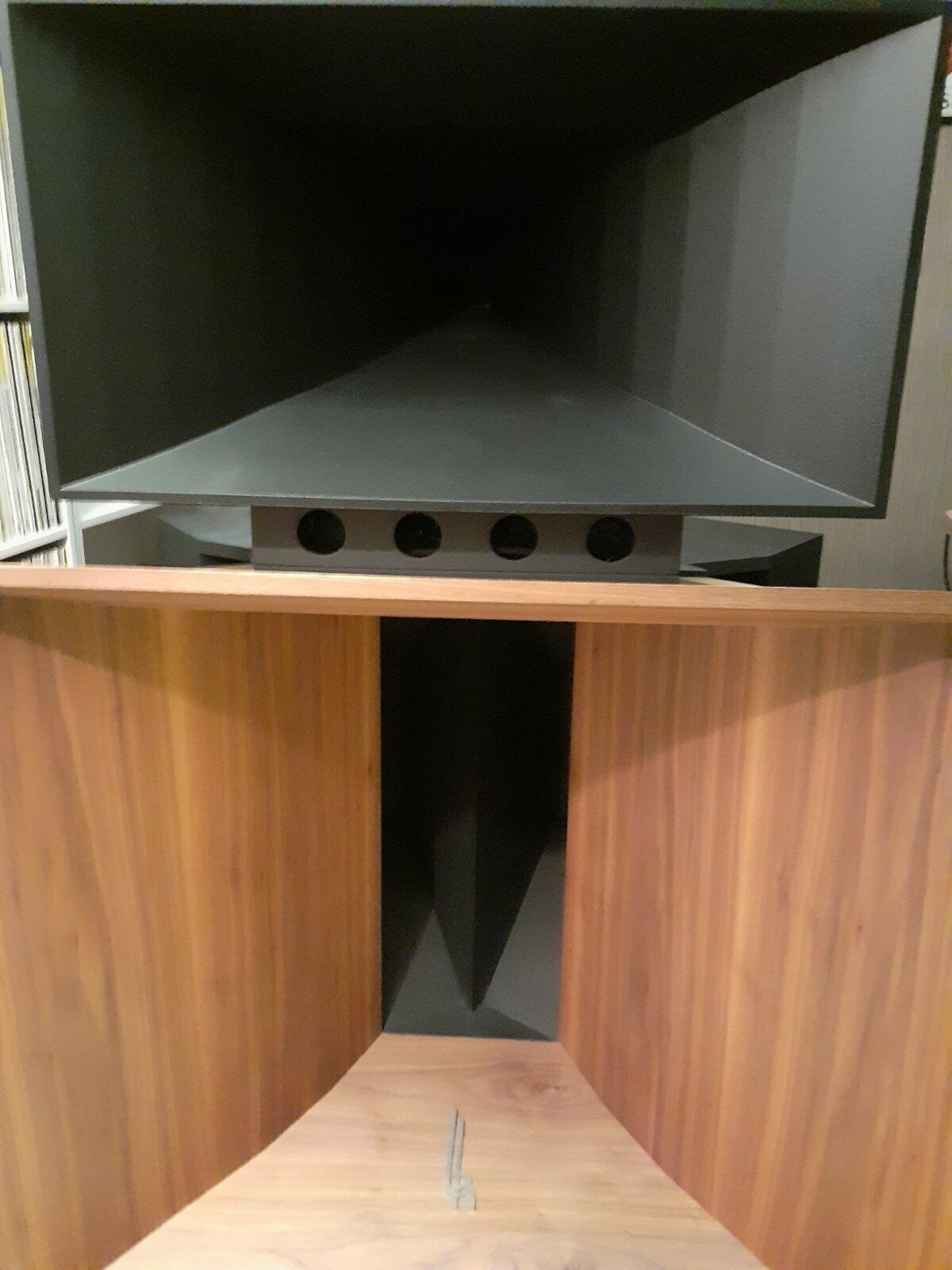

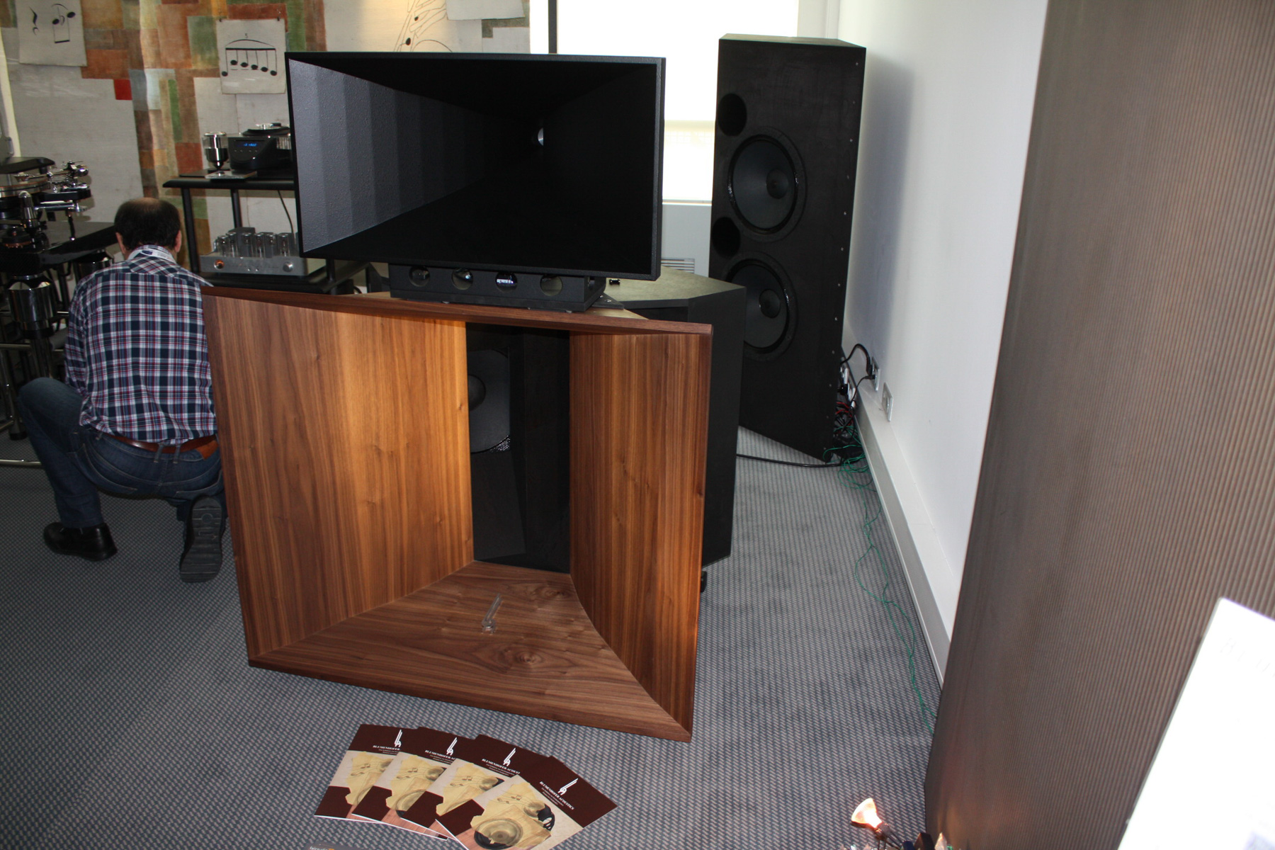

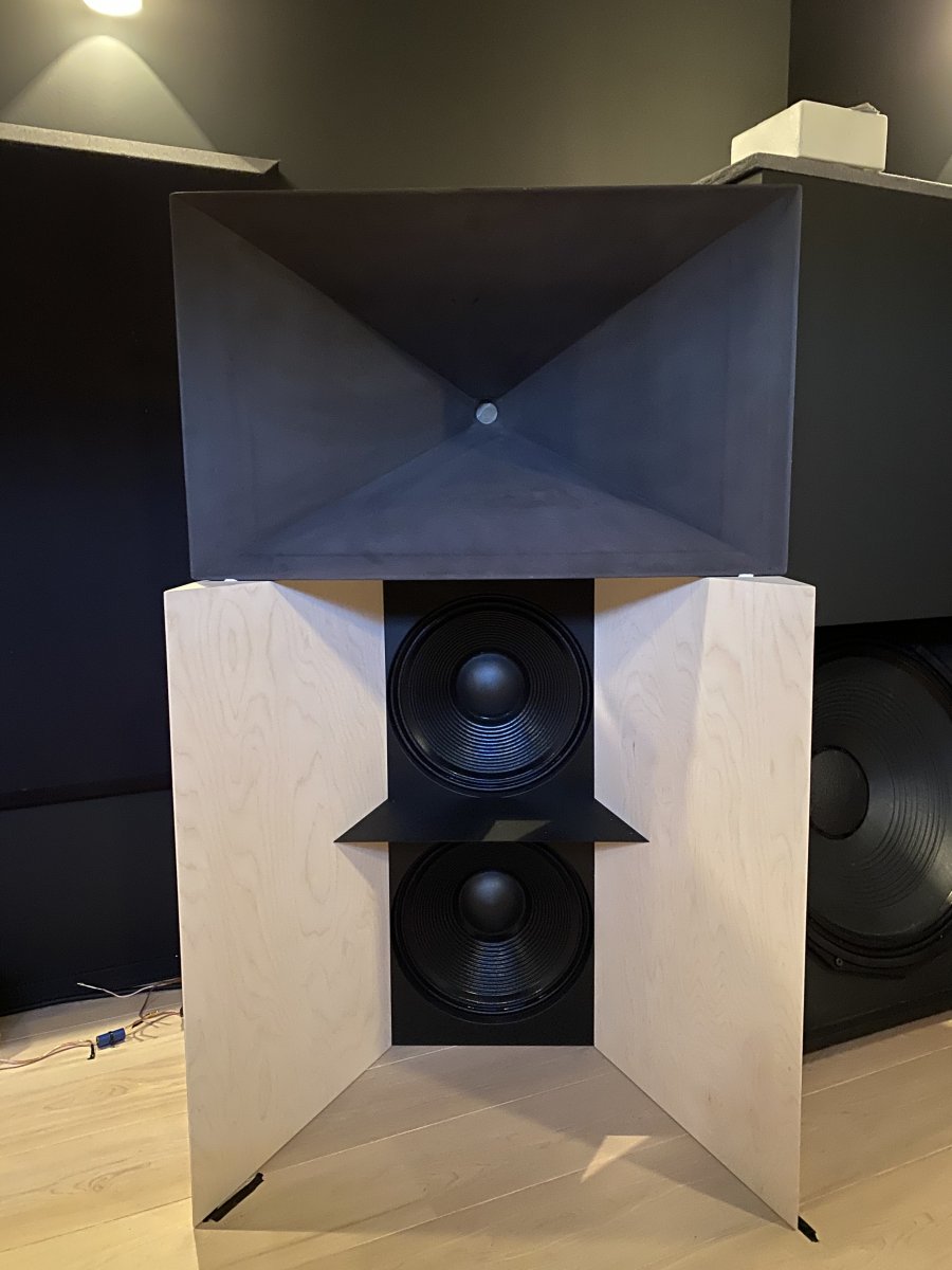

Up to now and for the unforeseeable future I'll be using a 15" direct radiator + horn/waveguide, similar to the Summa (still experimenting with different woofers and horns).
After experiencing FLH's magical mid-bass, space permitting, I might pull the trigger on something like the system above, or the BD-Design Orelo.

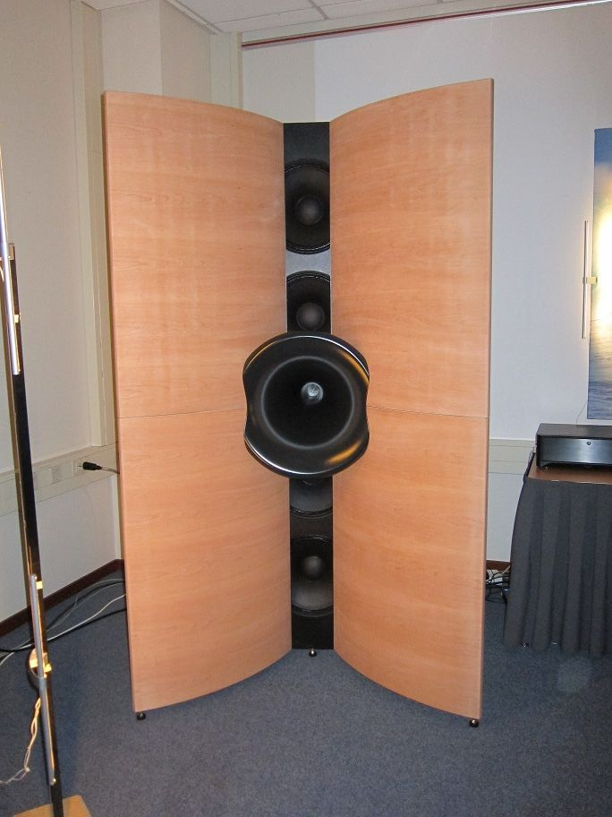

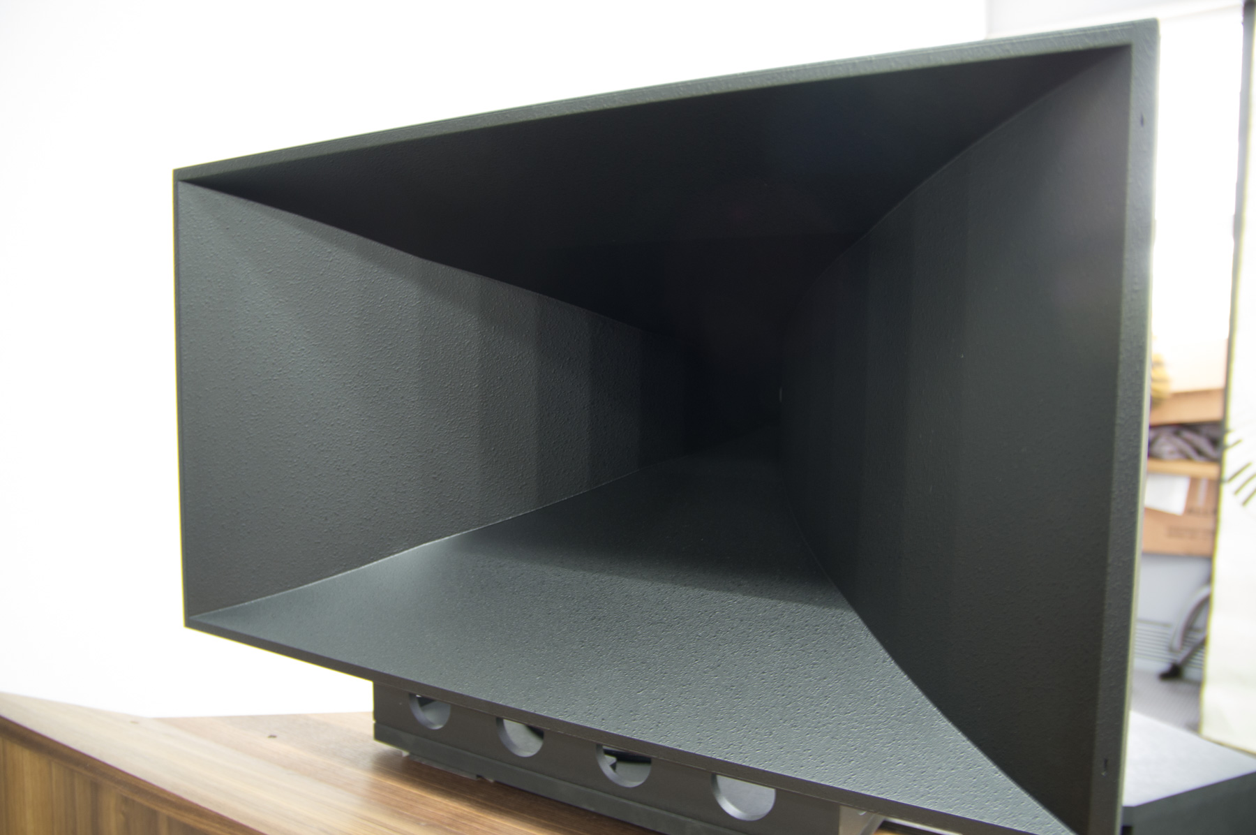

However, I'll definitely use a constant coverage horn, like some Norwegians do (2nd pic.).

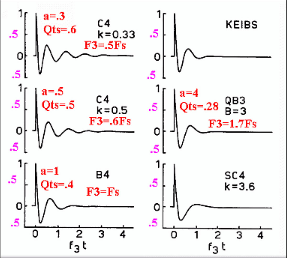

Again, the lower the Fs, the wider its harmonic BW, ergo Dc = infinite BW.
For this reason the lower the system's Fs, the 'fuller', more 'extended' we perceive the whole BW whether or not the HF is equally balanced [extended] and apparently why the pioneers designed speakers tuned somewhat below the lowest notes on the recordings.
Conversely, if the HF signal is prominent up to 20+ kHz our brain will reconstruct a rolled off low end and one reason why some folks claim we ideally need up to 40 kHz systems.

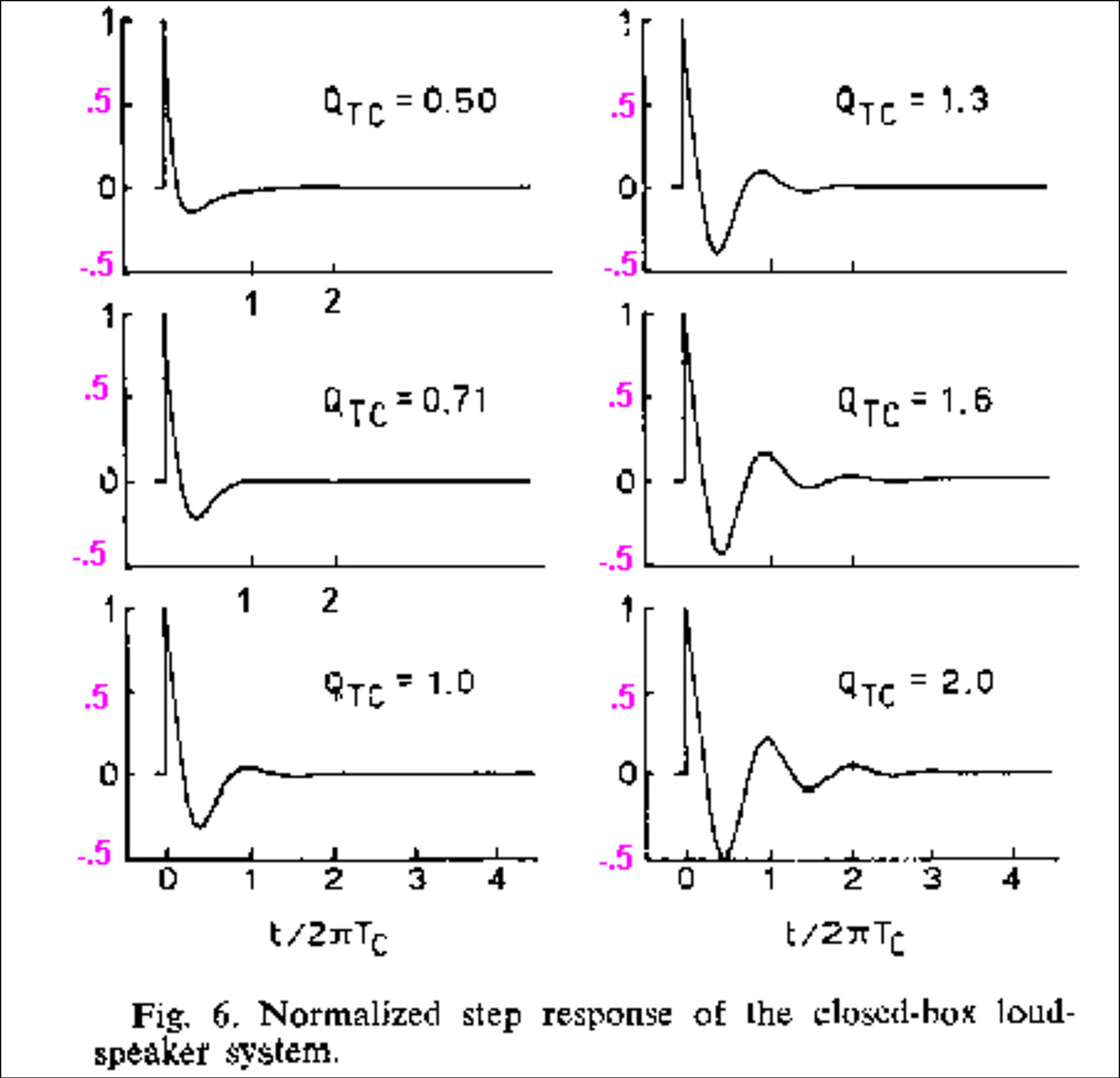

One thing that I did not 100% embrace in the past was the idea that room Q dominates (add in the ambiguous use of the term, driver compliance vs roll off characteristics) This is still the case in nearfield? My next thought was well then room spectral decay dominates as well...might as well throw in room resonate note as well...Call it Fr? I guess this is why excursion and power matter more than Fs!

Well the plan has been to sculpt the desired low end response with eq... what is an assisted alignment.
Here this explains it all.
1983 JBL SUBWOFFER DESIGN
