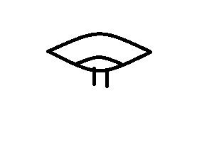

I guess that the loss in impulse is viable for higher frequencies. I assume that putting two saucers together forming a strong elliptical form is quite stiff for lower frequencies.
Dustcaps can also be somewhere in between outer edge and voice coil diameter.

If they would have very big dustcaps this would bring lots of stability like with a 13cm paper diaphragm bass driver I tweaked with a big paper dustcap for getting true piston motion.

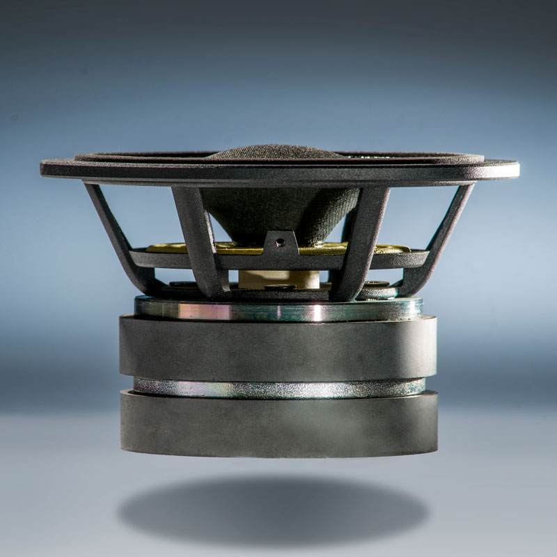

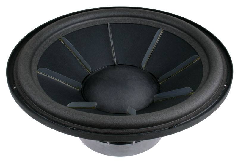

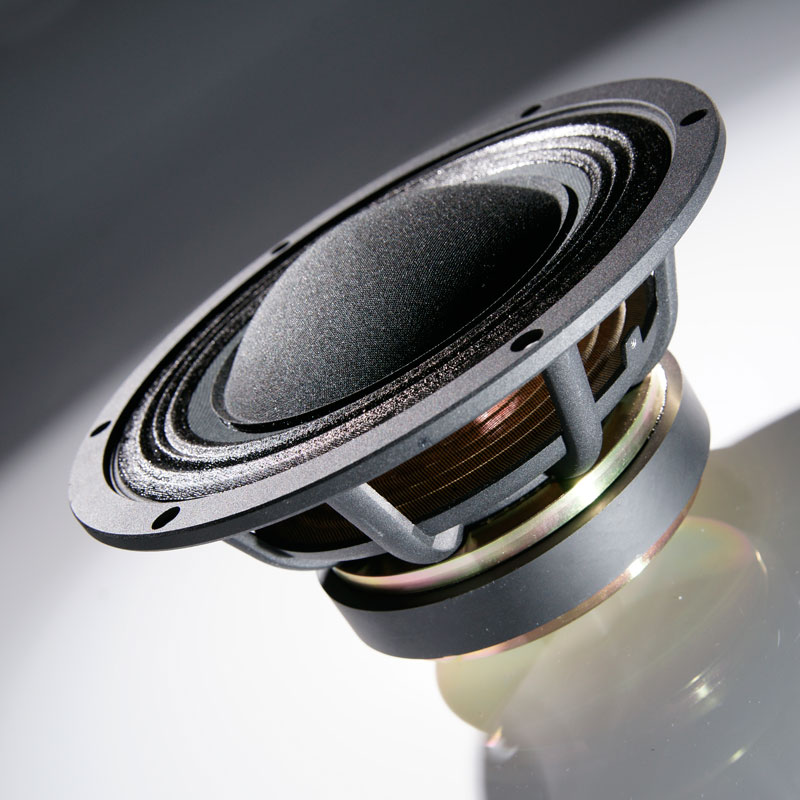

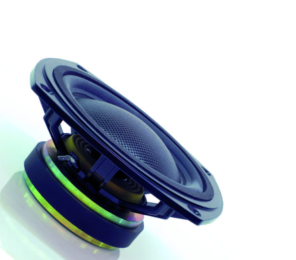

Your driver is similar to the inverse cone drivers Avantgarde uses for the mid horns.
Paper has been by far the most widely used material for cones since the pioneers, and for good reason.
Much research has been done on the almost infinite amount of interdependent factors that affect the working of cone drivers.
A quote:
"Frankfort, also seeking solutions for the membrane vibrations of conical loudspeaker cones, formulated a differential equation that accounts for
bending vibration and made detailed calculations of the sound pressure frequency response, vibration patterns, and driving-point admittance. However, Frankfort’s analysis did not account for the effects of the edge and center cap, which play important roles in cone loudspeakers. Subsequently, the finite element method (FEM) has been used for vibration analysis of the cone. Kyouno et al. analyzed the sound radiation from loudspeakers, accounting for coupling of the electrical, mechanical, and acoustic systems.
In these vibration analyses of cone loudspeakers, the cone maintains a piston motion in the low-frequency region. The biggest difficult point of these analyses is the split vibration of the vibration plate in the middle- and high-frequency regions. Control over the cone and the edge is very important
in the design of a loudspeaker."
In other words: cone drivers are subject to all kinds of disturbances and there is no such thing as a perfect cone driver. The Purifi woofers probably come closest to optimal and, lo and behold, the used cone material is "Proprietary Fibre Mix", what I translate with "advanced paper pulp".

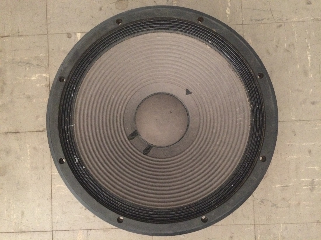

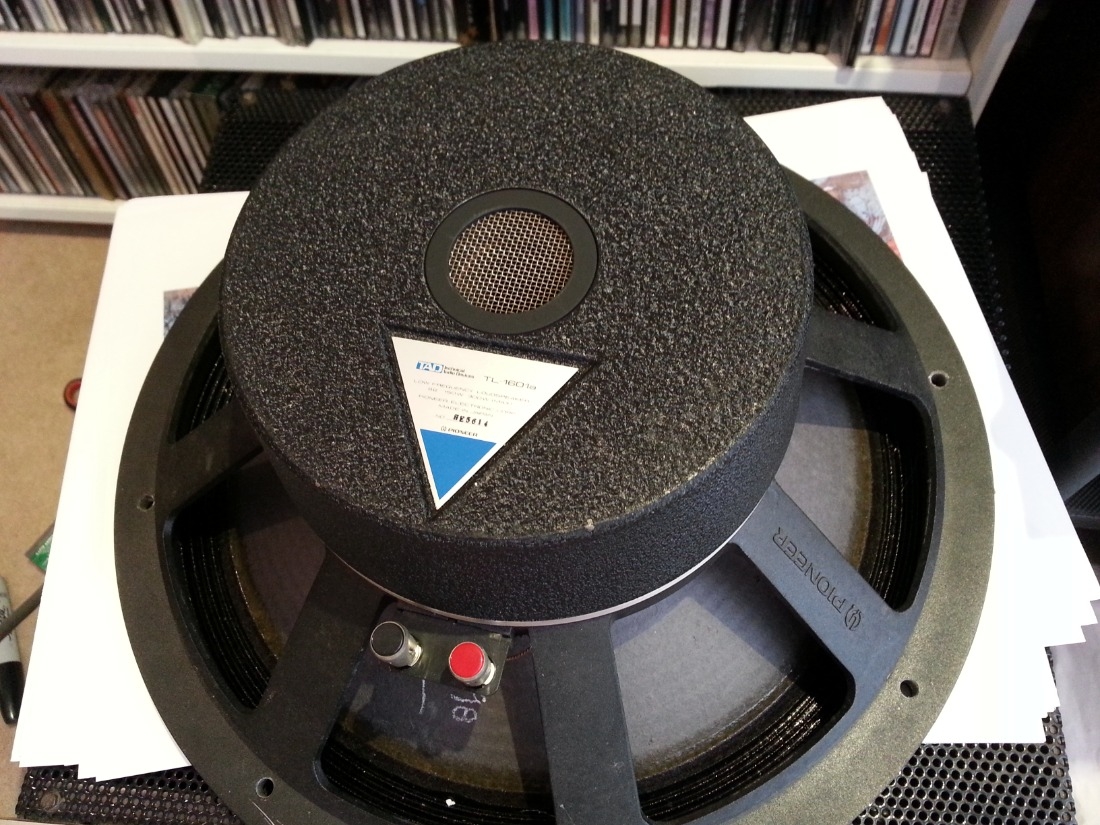

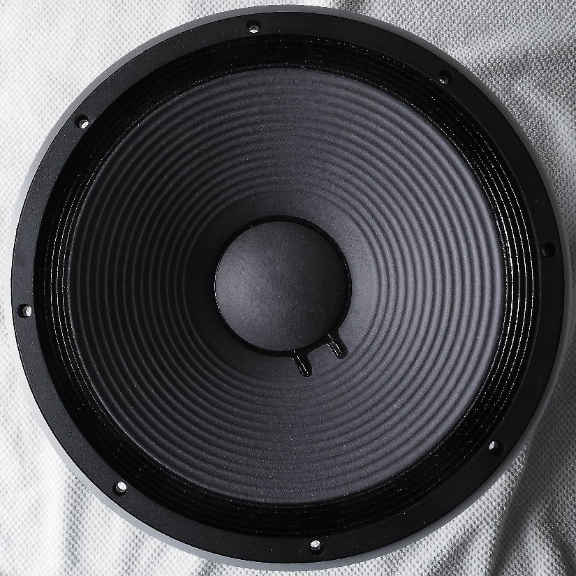

...What i wonder is why they just use simple paper diaphragms for the bass drivers.
I had a chance to examine a broken membrane from TAD 1601 driver, according to my observations, the membrane was not quite simple paper, but covered with some kind of hard polymer coating (like Aquaplas 😕). The membrane seemed quite stiff.

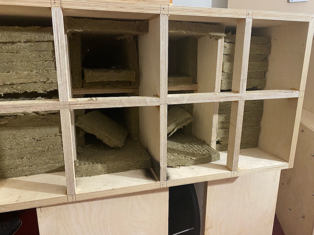

I've got the mid range enclosures almost zipped up...I was hoping to make a little more progress but cutting up the insulation took more time than I anticipated...I am now considering how much damping material to put into the bass bins...I figured that since I intend to use them as high as possible, with that possibility being near 150hz, Damping material would be in order, no less, than the upper bass box, I suppose.

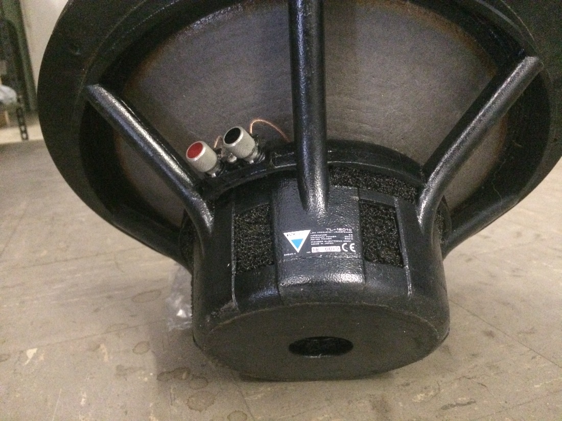

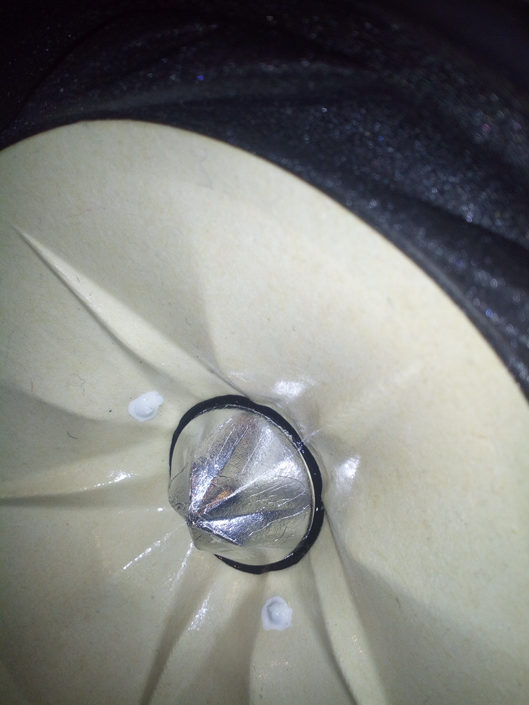

Was it a TL-1601A, B or C?

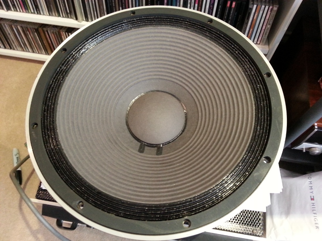

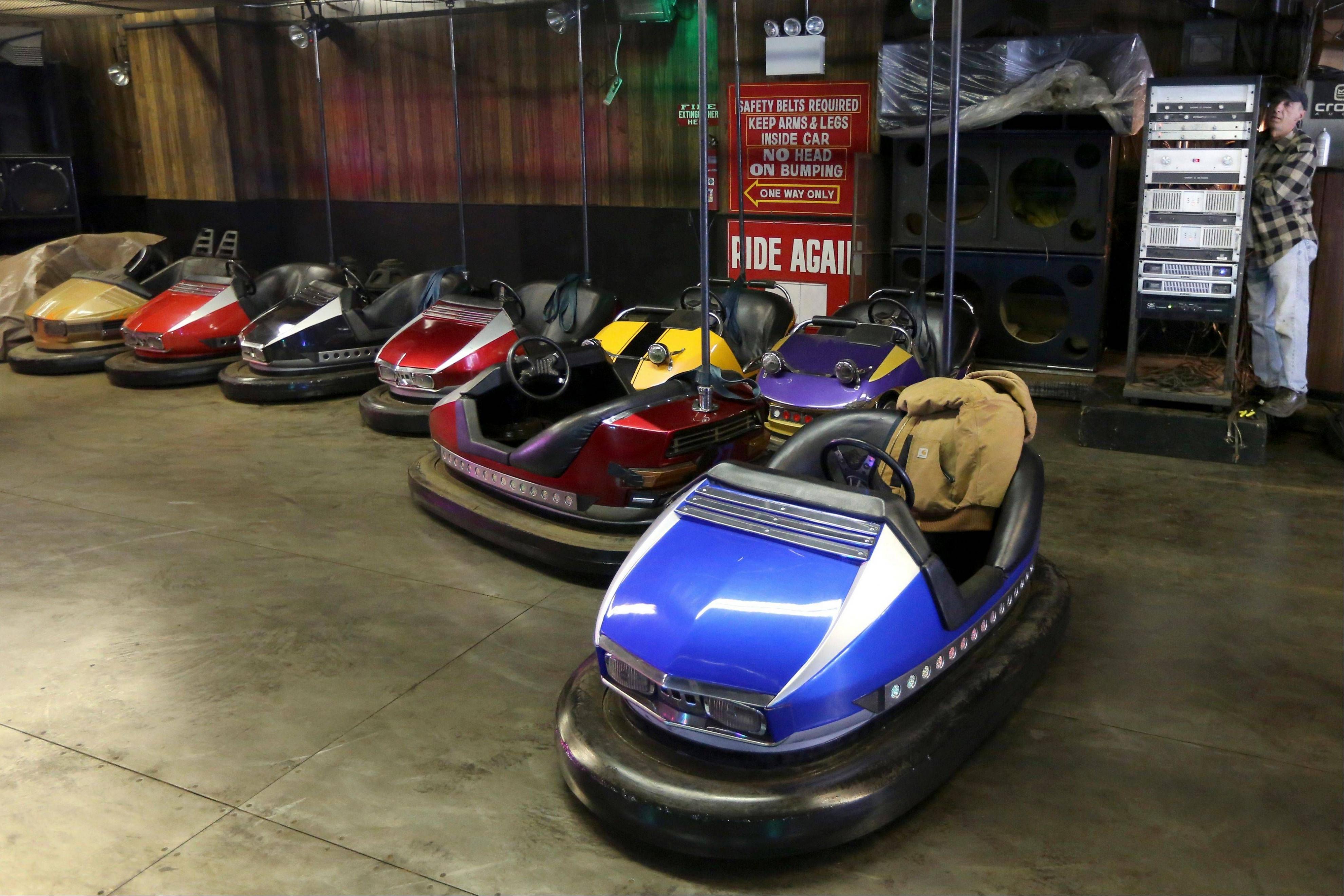

Comment by the late Scott Fitlin that almost exclusively used TAD drivers in his Colorado Bumper Car Disco (Coney Island):
"TAD 1601A- accordian surround, alnico magnet, Fs 28Hz, 300w power handling, 97DB 1w@1m 900hz or lower crossover recommended.
TAD 1601B= accordian SURROUND, alnico magnet, Fs 28Hz, ventilated VC former, 500w power handling, 97.5DB 1w@1m. 900hz crossover or lower recommended.
TAD 1601C- accordian surround, alnico magnet, Fs 28Hz, triangular metal weight to counterbalance against lead weight, 97DB 1w@1M, 500w power handling, was $995 list, now discontinued.
TAD 1602- Foam surround, treated cone, high compliance suspension, 21Hz Fs, alnico magnet, 300w max power handling, similar to JBL 2235.
TAD 1603- accordian surround, ceramic magnet, Fs 28Hz, 500w power handling, 97Db 1w@1m, 900hz or lower crossover recommended.
I have never heard the 1602, so I have no comments.
The 1601 A & B, and 1603 I know well. 1601A is clean, smooth, big deep low end, flat response. 1601B takes more power, and is also an excellent sounding woofer. The 1601A and B sounds great, but PRICEY, alnico costs.
The 1603, I use them, and know others who use this model as well. Deep, heavy, big thump, smooth low mid, very clean, purrs on low notes, handles a great deal of power, very durable, and produces a large amount of low end. I have them horn loaded in my Altec cabinets, and they produce, definitely deeper and smoother sounding to my ears than the JBL 2226. Real drums sound phenomenal through these, as well as bass guitar and keyboard notes and vocals.
I tried EVERYTHING, JBL 2226, TAD, 18Sound, B & C, EV, TAD was the best sounding to me. Low end is HUGE and clean, with a touch of warmth. Price just under $500.00ea. Works very well powered by BGW, Bryston, Crown, QSC, Crest, Lab or any other suitable high quality amplifier with proper power. TAD 1603,s THUMP, and have great low end definition, and are really reliable, they dont break.
I am comparing these to modern woofers, in production today, not vintage drivers, EVERY modern driver mentioned will outperform yesterdays drivers in terms of power handling, thermal compression, and reliabilty, in demanding use.
Sonically, TAD sounds great, JBL,ish, to a large degree, but deeper low end than the 2226H, and TAD paper cones are of great quality. TAD drivers are CLEAN, and play GREAT low end.
The JBL 2226 has more mid bass kick, but the TAD 1603 snaps, and is warmer and easier and fuller sounding. I tried B & C and JBL, 18Sound, The TAD won. What can I say?
1601A is even smoother, but, not as robust, the 1601B is robust, sounds great, but $775.00 or higher, list pr OUCH!
Basically, TAD is the Japanese answer to JBL, cost no object, super high quality designs. They are THAT good, but are very expensive, and hard to get. When TAD is out of stock, you just gotta wait."
1601a
Here it is
Photo courtesy of my friend.
If you look closely, even in the photo you can see a layer of some kind of coating at the site of the cut.

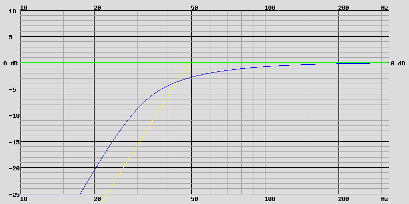

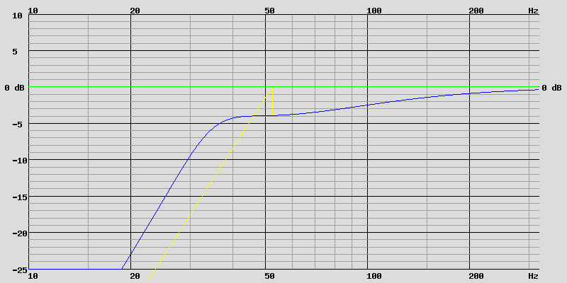

Driver fs, how big of a deal is that? Its not...for a vent...vent tuning is final say (not fs). Sealed box is limited by excursion as well, not driver fs...we typicaly aim for large sealed enclosures stuffed to the brim with damping material, deadening most resonance if possible...maybe the only connection of driver fs to something relevant is the weight of diaphragm suggesting a possibly rigid cone derived from materials that added weight coincidently. Or maybe the thought of keeping a resonate mode towards the bottom or out of the passband...either way the box + driver tuning takes precedence.
