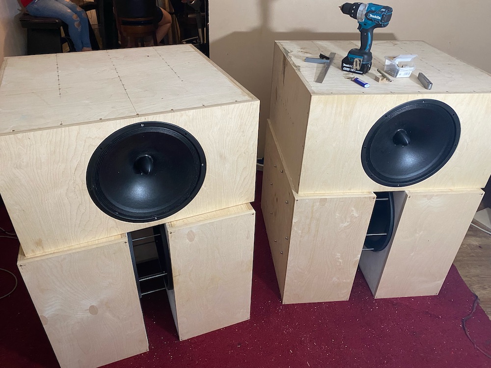

Its starting to look more attractive to me now...probably the with the installation of the front baffles on the subs. The veneer I have is black brushed aluminum. I think it will be very attractive when all said and done. Still more holes to drill and fill, but I'm getting there.

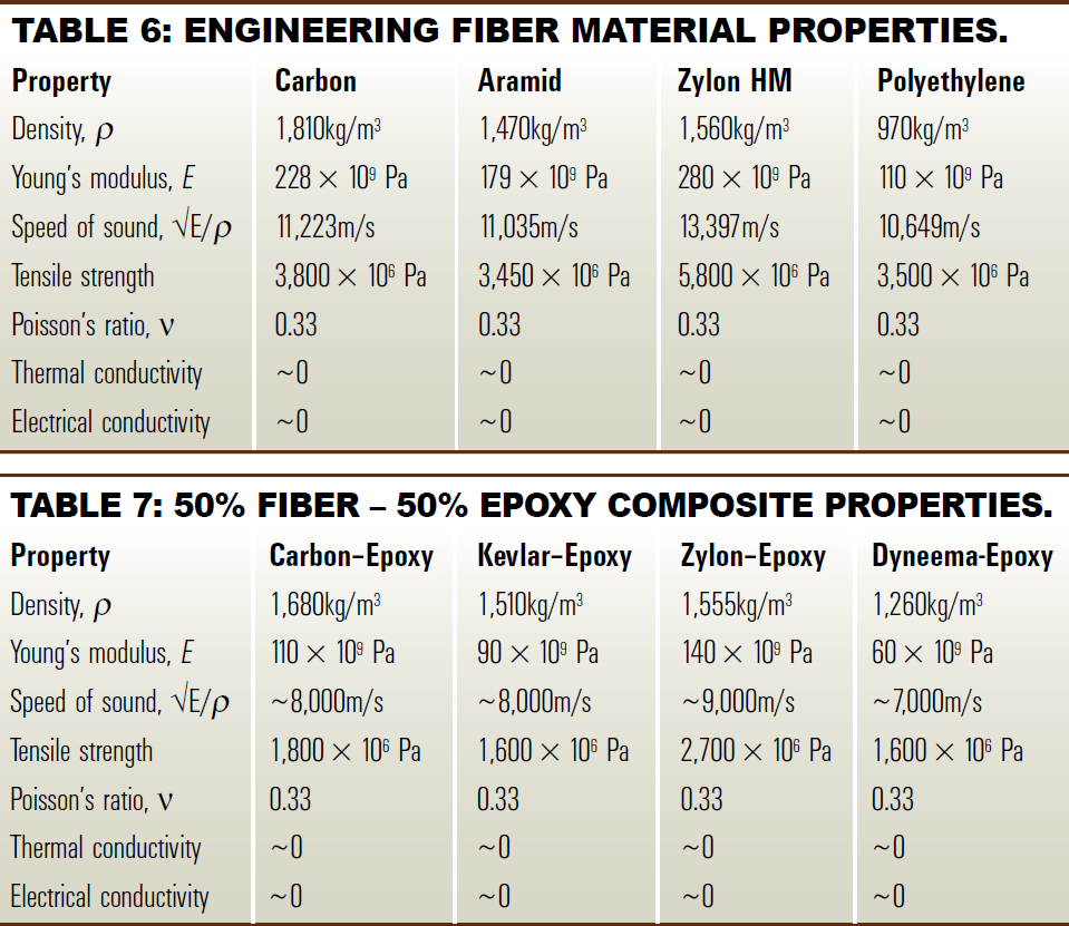

Zylon Fiber is a new high-performance fiber developed by Toyobo in Japan. It consists of rigid-rod chain molecules of poly(p-phenylene-2,6-enzobisoxazole)(PBO).
Zylon and Dyneema were developed for the ballistic and armor applications and like Kevlar have found their way into loudspeaker diaphragm applications already. Kenwood touts adding Zylon fibers to some of their PP cones and Dyneema’s manufacturer is recommending speaker cones as an application.
Zylon's properties are very appealing apart from the UV sensitivity.
Yamaha's solution is a Monel alloy coating that also serves another purpose.

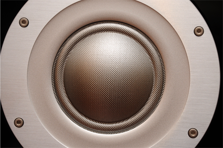

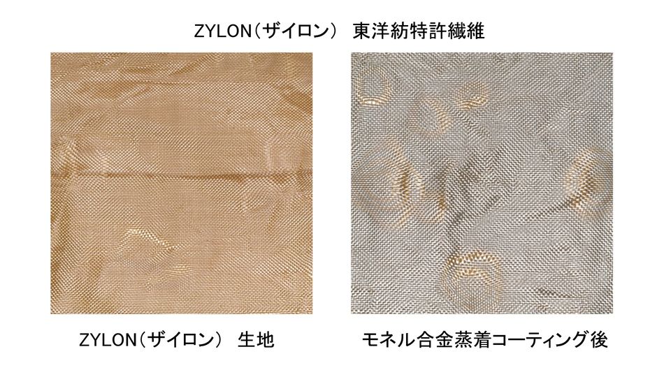

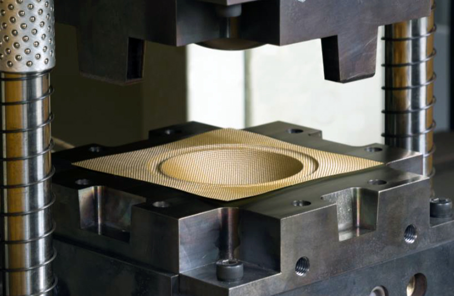

YAMAHA thought that all units of the new NS-5000 had to be made of the same material in order to create a new generation of music monitor speakers. Fortunately, Toyobo released "ZYLON, a high-strength fiber with sound quality comparable to that of berylium," and YAMAHA decided to use this "ZYLON" for the diaphragm of the speaker for the first time in the world. However, there was one problem that had to be solved when using Zylon.
Diamonds and beryllium can exist as "plates", but Zylon is a fiber and can only be used as "cloth". No matter how fast the speed of sound is, if it is processed into a "cloth" shape, the friction between the fibers will impair the sound velocity energy, and "air" will leak from the gaps between the fibers. YAMAHA responded to this problem by "depositing" "Monel alloy" on the fibers of Zylon shaped into a unit shape. In other words, the surface of Zylon was covered with metal (Monel alloy). Fortunately, ordinary fibers melt at that temperature when metal is vapor-deposited, but Zylon has a very high melting point of 600 degrees.

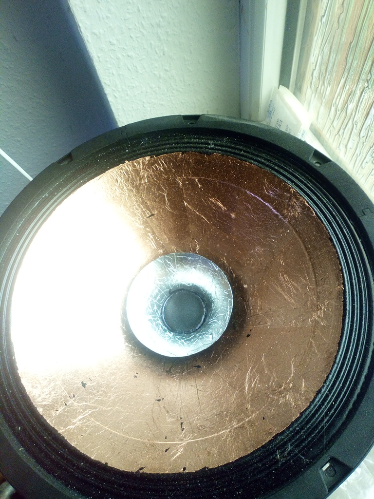

You can cover the complete frequency spectrum 20 Hertz to 20Khz with just one driver with high spl:
Fane Sovereign 15-300 TC
I would cover both sides with aluminium foil (like with a Sica 12 D, also a good driver for high spl, here with foto, diaphragm covered with copper foil).
You can make a dsp correction of frequency response put the Fane 15-300 TC into a nice reflex box and it would cover the complete audio spectrum.
You can also take a real bass driver and put a crossover to 80 Hertz. And the Fane can get much louder if necessary.

I just wanted to show a driver which is rarely built, a true 15 inch fullrange driver with high spl.

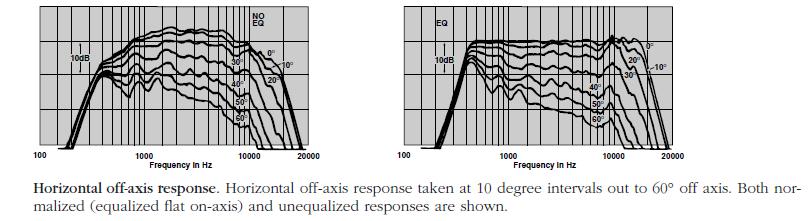

If you use dsp correction the driver will be linear on axis. Off axis is a different thing.
The modified driver will be always linear after dsp use.

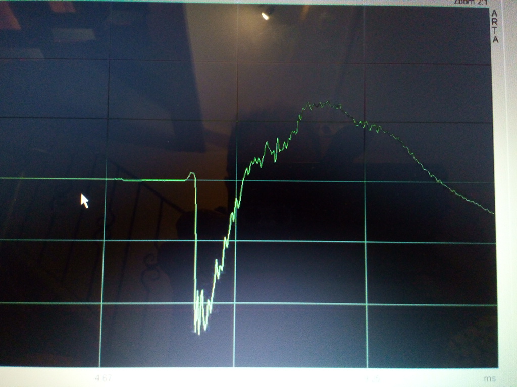

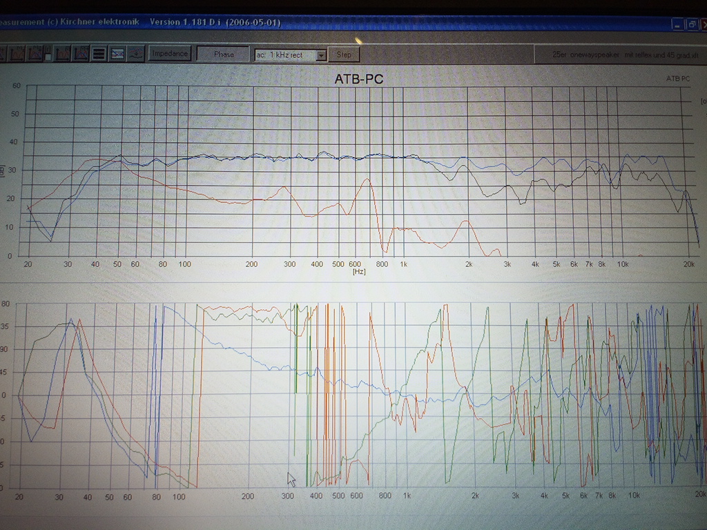

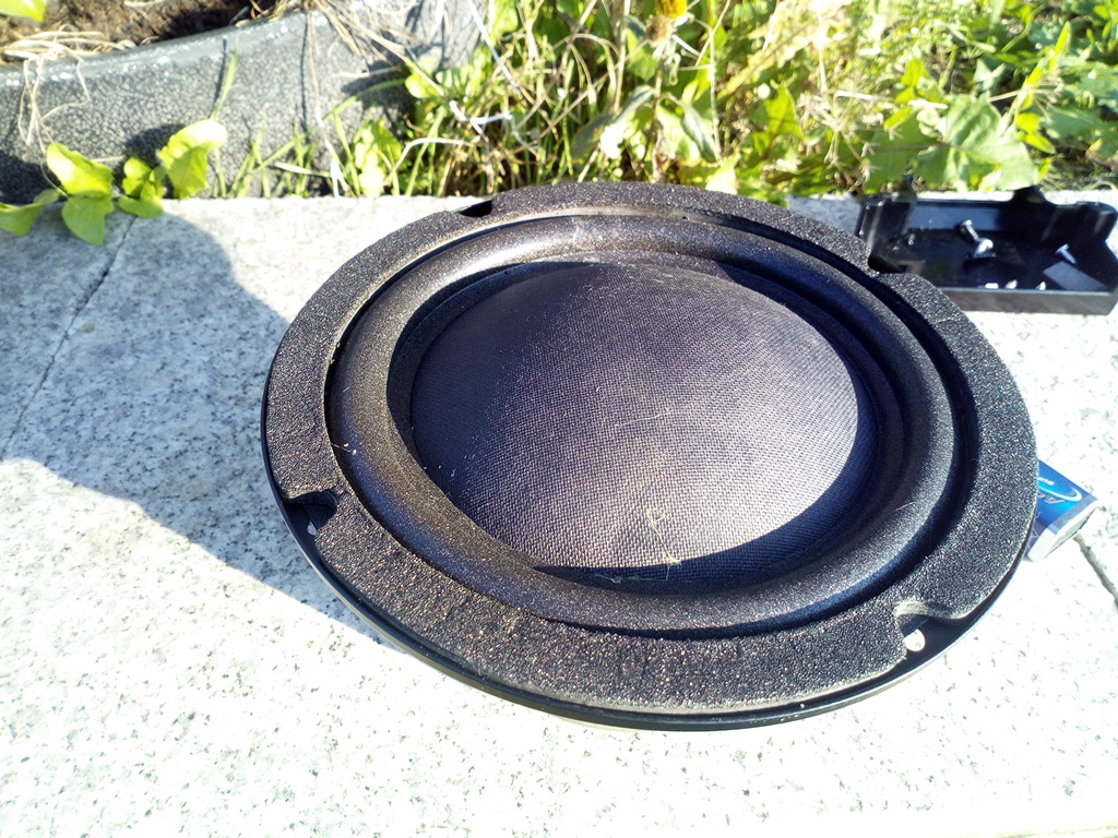

Here you can see a 10 inch driver fullrange going down to 35 Hertz in Reflex, dsp corrected, both sides of the diaphragm is aluminium covered. Dustcap is aluminium hand made. It is not optically perfect but acoustically its o.k.
The ringing in the high frequencies (burst decay) is inaudible so I left the aluminium dust cap untreated.
I is phase linear from approx 200 Hertz to 8 Khz. This is due to the point source - always perfect time response after linearizing the frequency response.
Frequency response of this 10 inch fullrange sandwich driver:
Blue curve on axis
brown curve is 45 degrees off axis
red is bass reflex
There are no tweeters active. It is a fullrange driver.
Burst decay is measured down to -25db

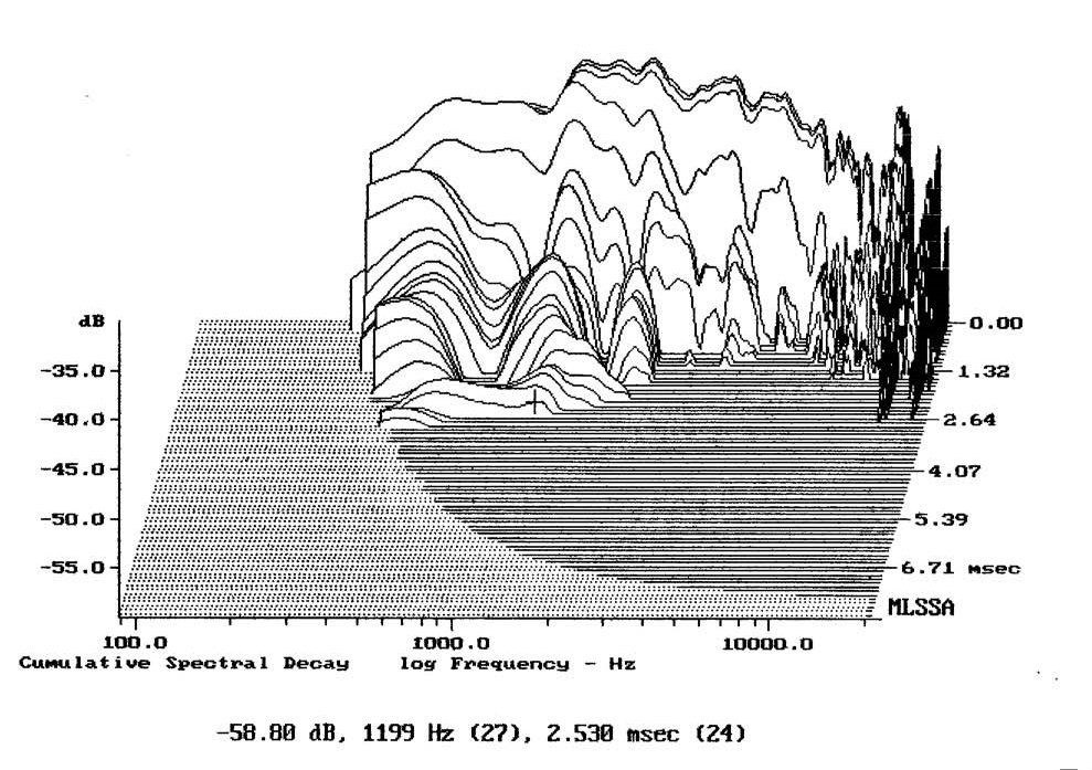

Thanks for the data.
It looks decent up to about 10k, the top octave is quite messy though. That doesn't necessarily means it sounds bad, but I'd prefer less ringing.
The point source nature is desirable, true.
This is the CSD of a 3" comp. driver that I considered buying, because it's suitable for a low crossover point. However, imo the top octave isn't clean enough.

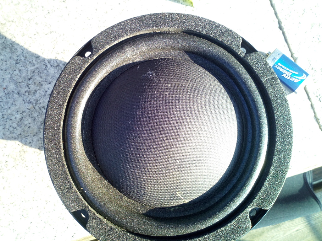

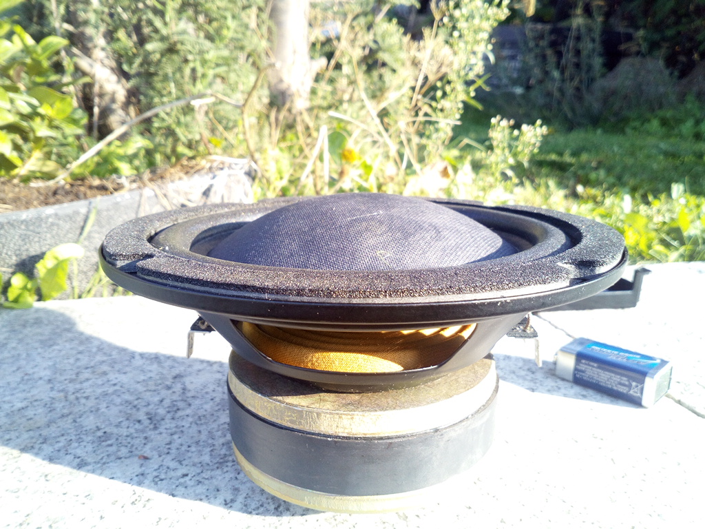

What i wonder is why they just use simple paper diaphragms for the bass drivers.
As far as I know paper has not enough stiffness for a really good sound reproduction - especially big drivers suffer from bending forces in the diaphragm.
If they would have very big dustcaps this would bring lots of stability like with a 13cm paper diaphragm bass driver I tweaked with a big paper dustcap for getting true piston motion.
Hi Dragan
While the assumption that a dome is stiffer than a cone could be right I assume that the whole setup is less than ideal. Your dome is driven by the outer edge of the cone which is probably not following the voice-coil motion exactly. Furthermore the added weight is incleasing the effect.
It would work well if the dome was driven by the voice-coil directly. But this would make an expensive driver.
