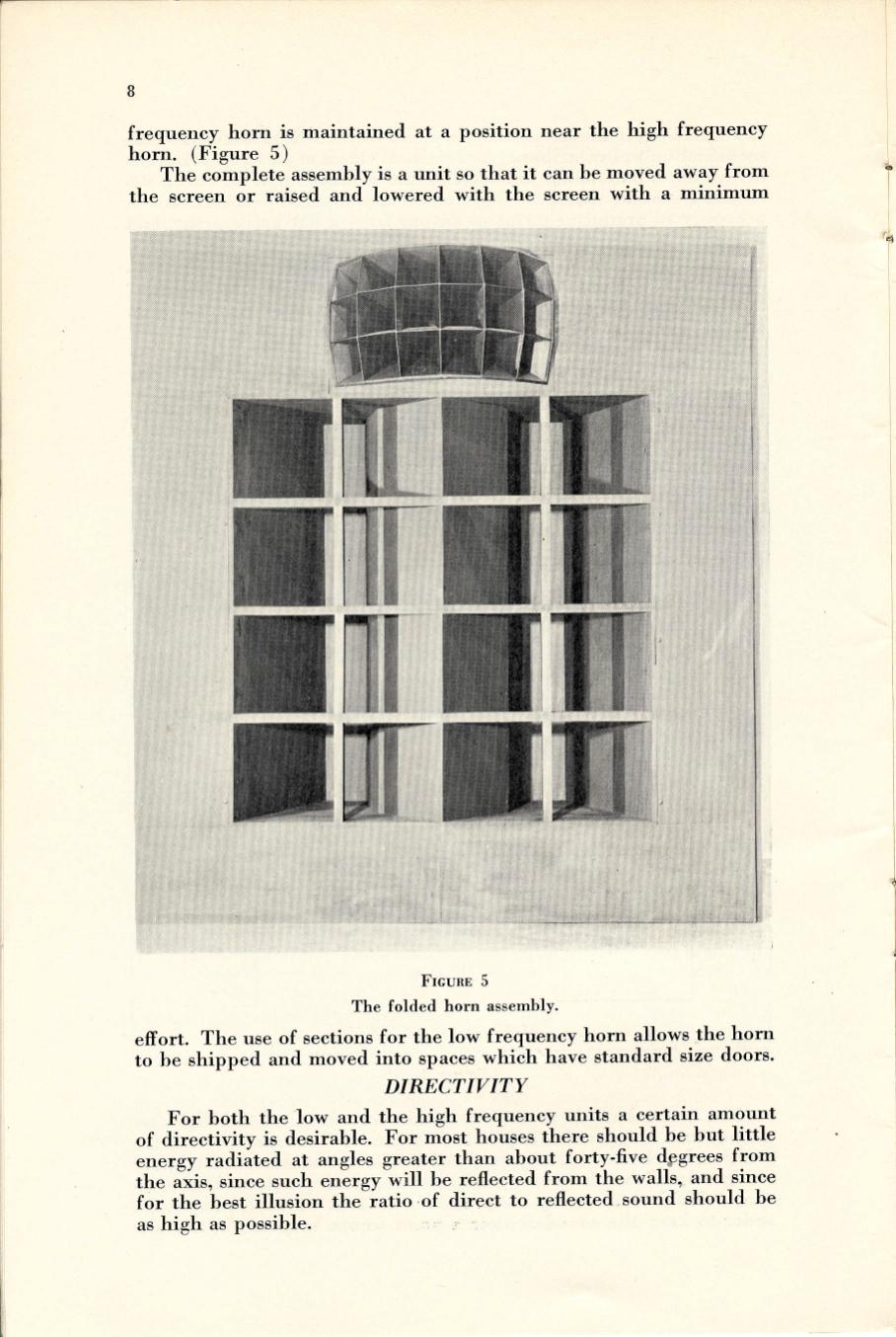

Shearer horn:

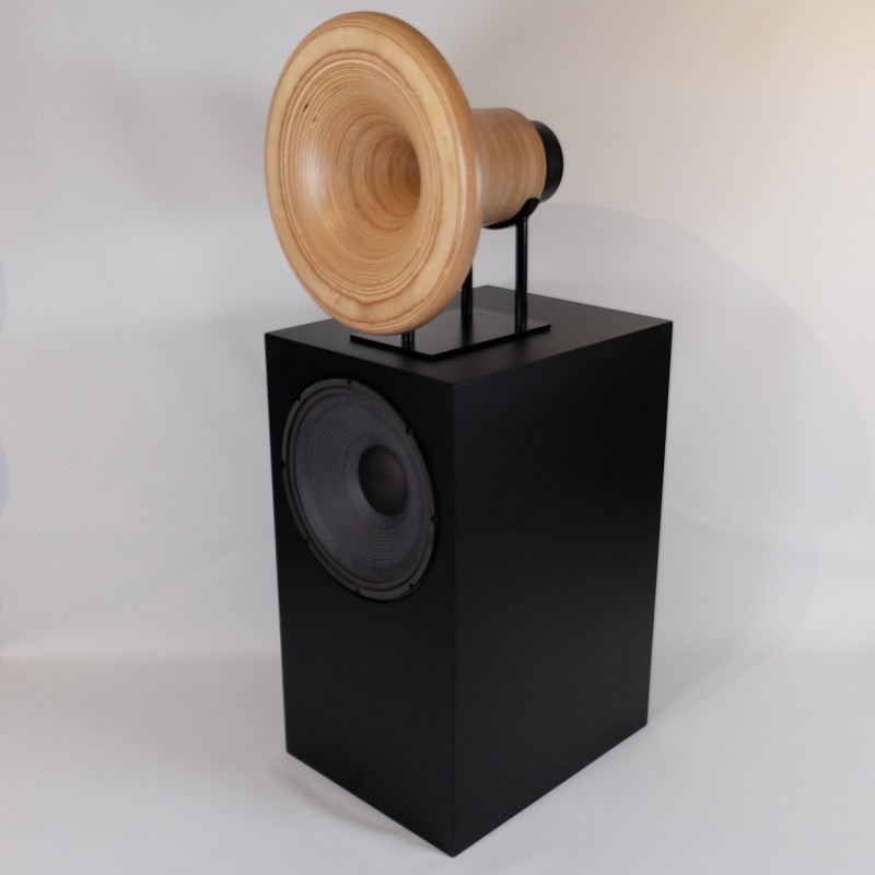

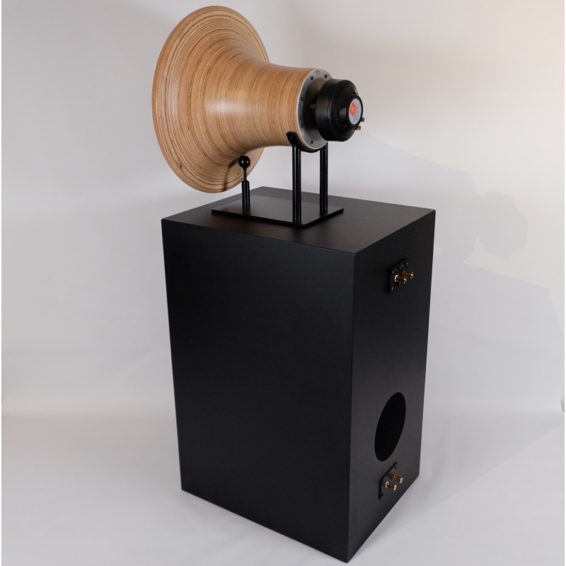

A 2 way system from the same manufacturer as the MTM, that was posted a few pages earlier.
There are few specifications available for this system, but I assume (given the horn) that the crossover is below 1000 Hz, presumably close to 500 Hz.
