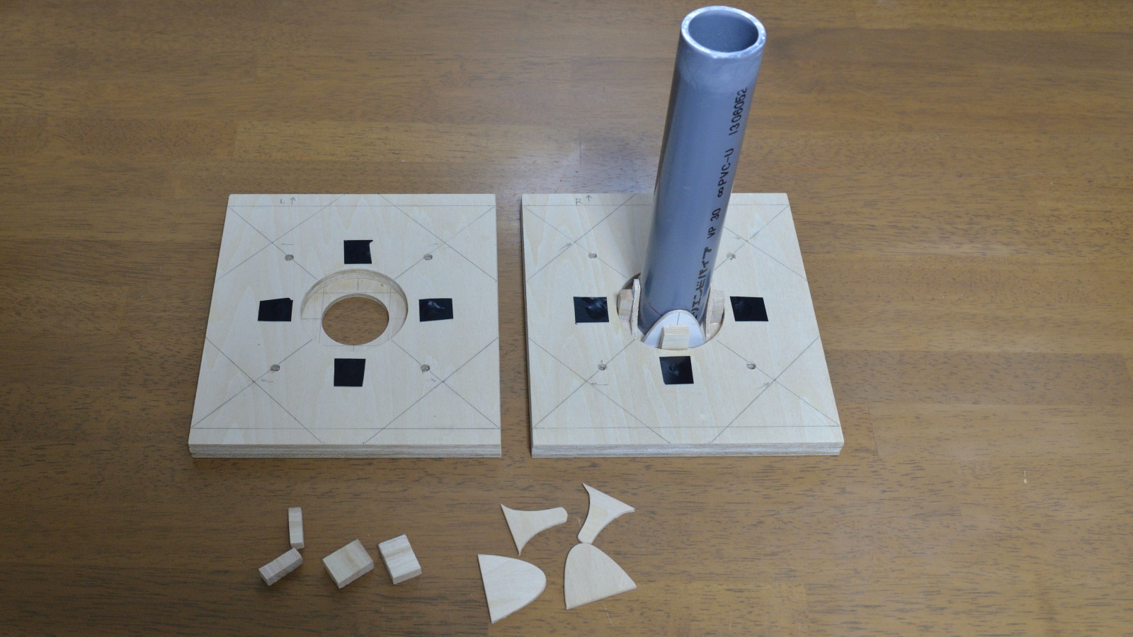

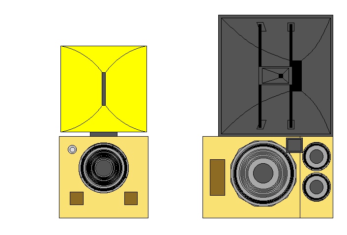

.... You don't think I could build something like that myself with the horn we are designing. If I remember correctly, if I'm only looking to come in around 300hz, with a hole in each of the 4 corners of the horn, as far from the throat as possible....easy peasy?
It is not just hole in the horn. Size of the holes matters as well as phase plug that goes toward the cone of the midrange to fill the cavity made by the cone bolted to the horn.
It can certainly be done (Paul did it looking at Tom Danley's synergy) but not without some scrap pieces and prototypes.
There are lots of examples of M.E.H.(multiple entry horns) now, though not all that many using a 2-way approach.That is easily the simplest solution to the problems stated herein. Very nice idea. Any of something like this that you could show?

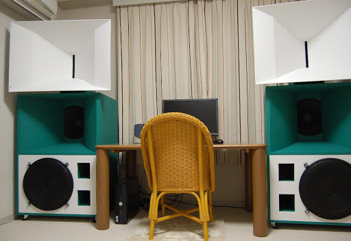

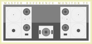

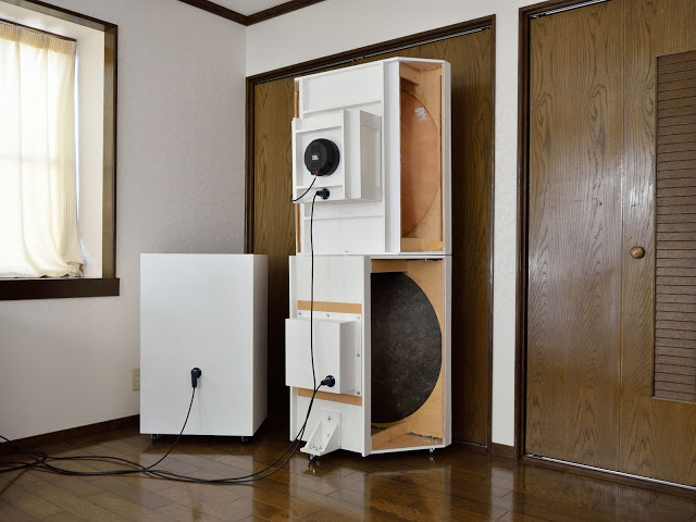

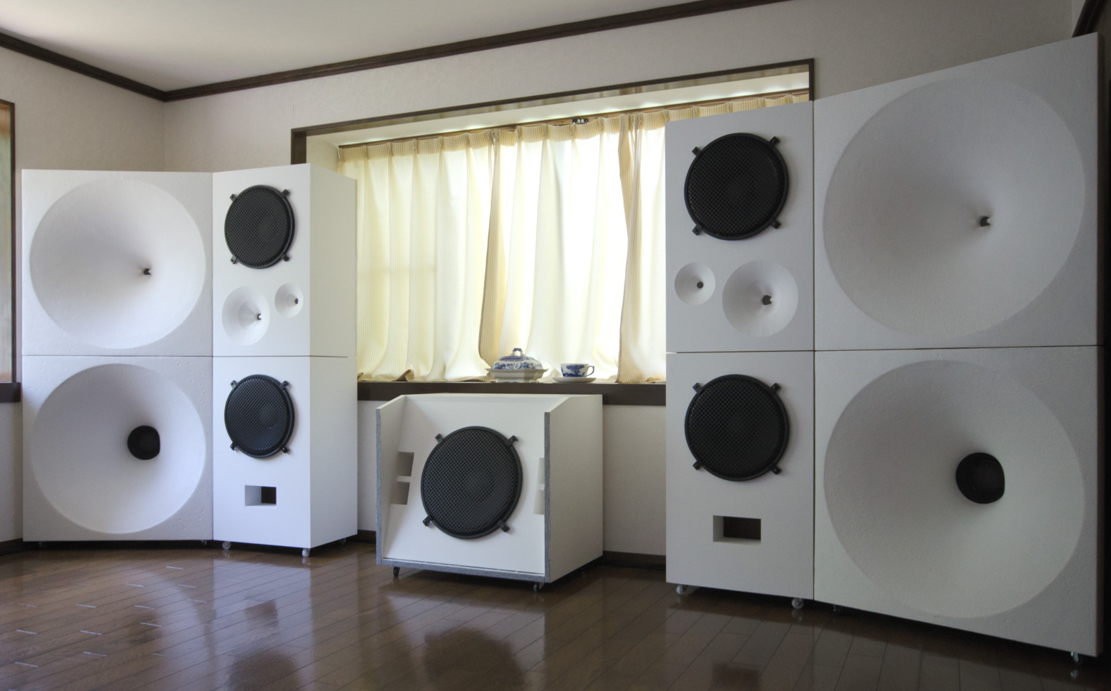

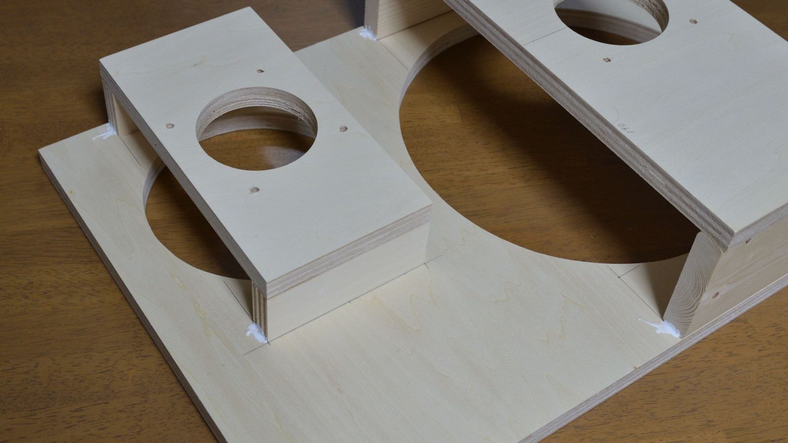

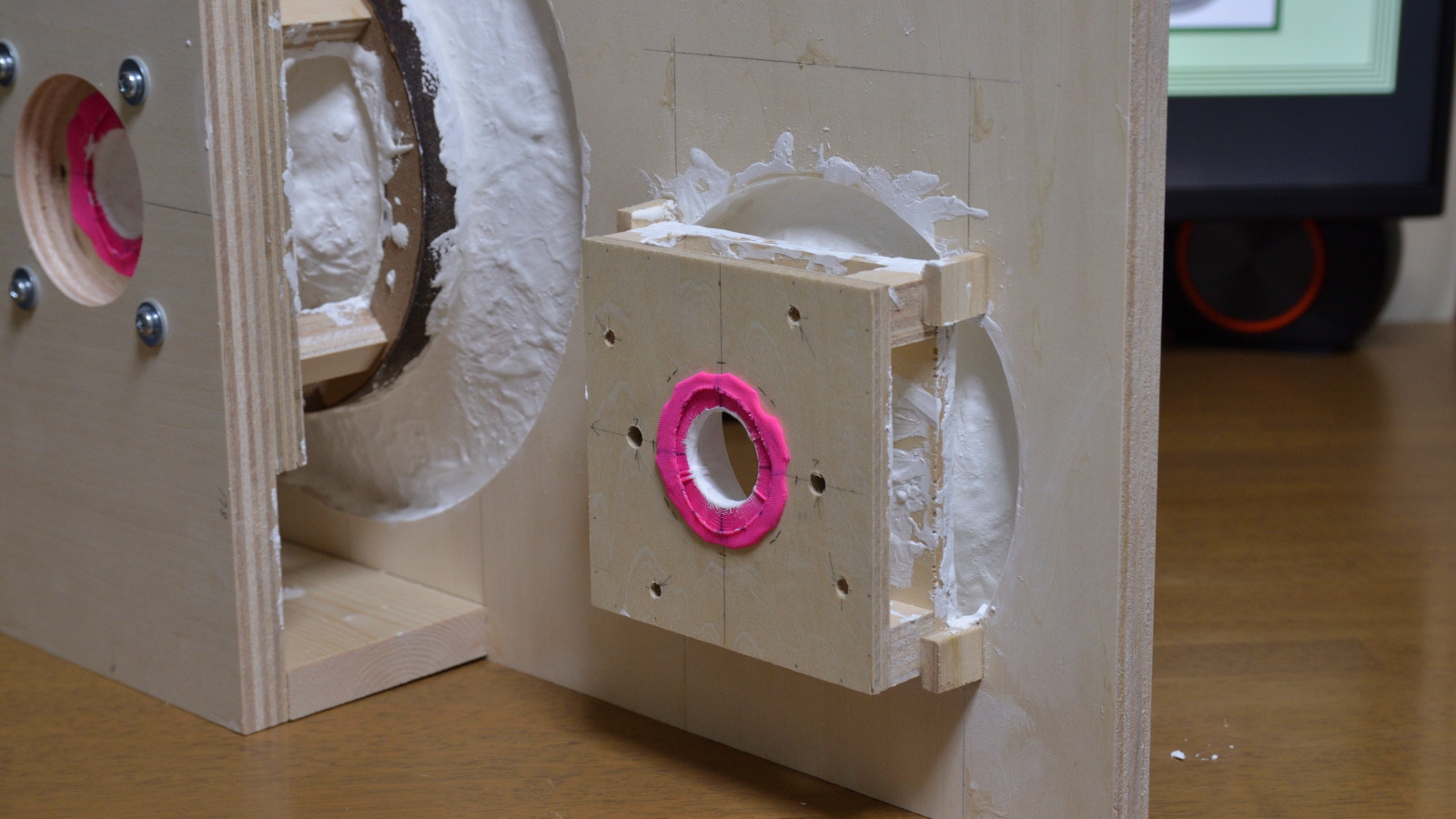

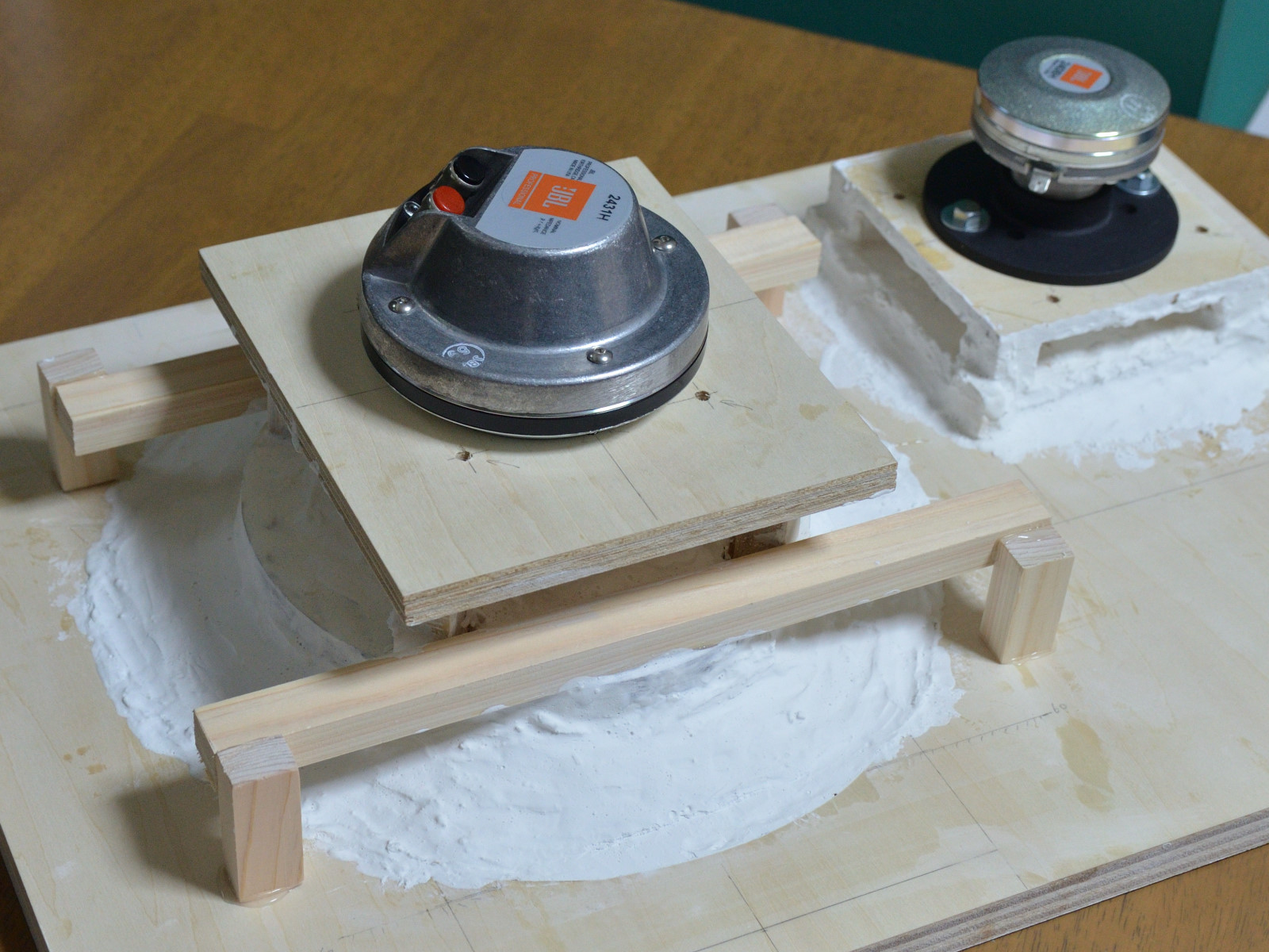

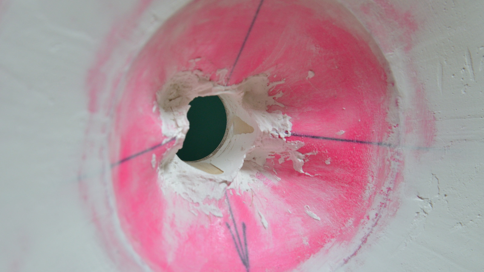

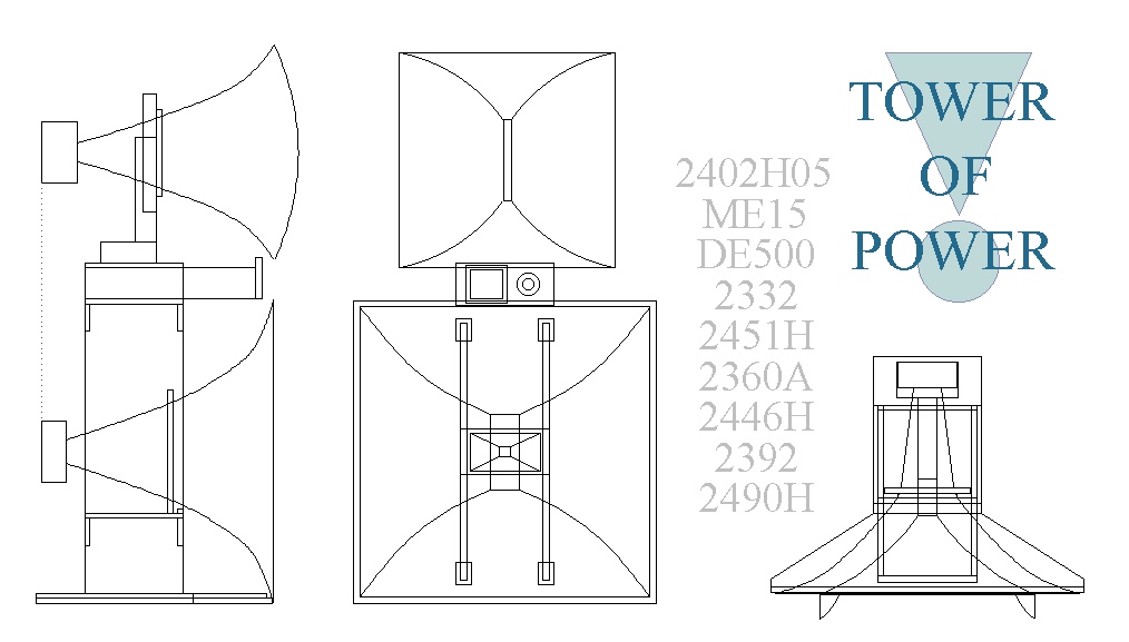

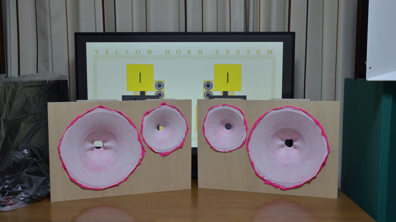

It seems kiiro is finally settling for a M2 (waveguide) inspired setup.
He calls it a paradigm shift.

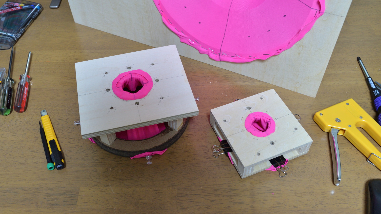

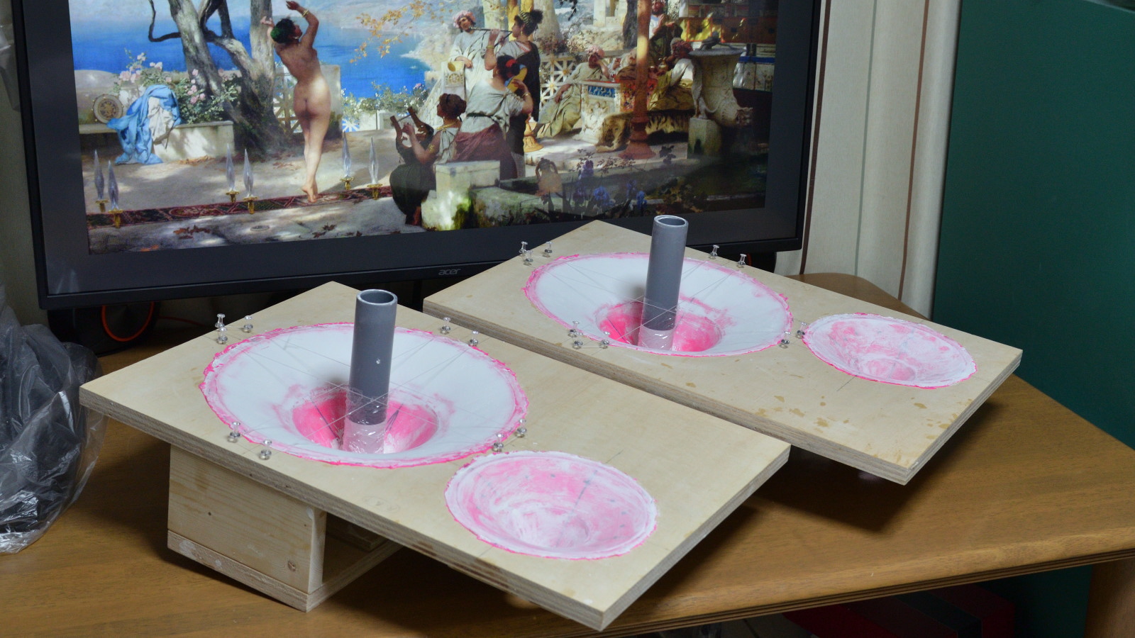

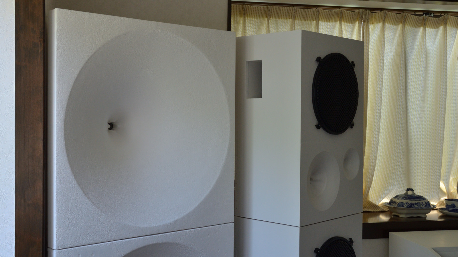

And some construction pics.
Pretty impressive pieces of work, right?
This is his website and here's his old blog. There's lots of interesting info to be found.
A comment (google translated):
"The sound of the two horns (2451H, 2431H) of the M2 type was a clearer new sound, while maintaining the high freshness of the 2360A and MR94.
2360A and MR94 are horns 45 years ago, so I think this is inevitable.
J2 technicians may not have heard of the M2 type large format horn.
Probably one of the world's most advanced large horns.
