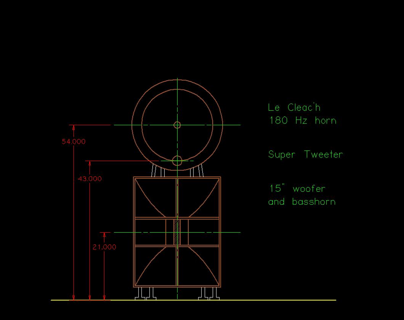

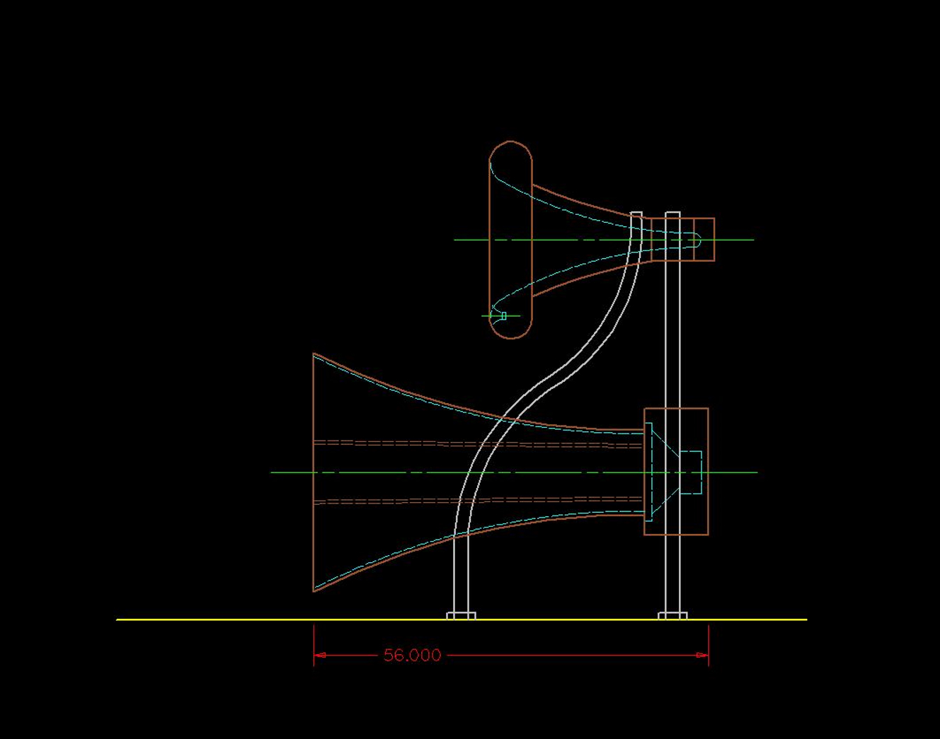

For Camplo's inspiration:

There are lots of examples of M.E.H.(multiple entry horns) now, though not all that many using a 2-way approach.
Sometime during 2014, Chris (Cask05 here on DIY) followed some suggestions in this thread:
Pros and cons of different midbass horns
And added 15” drivers to his Klipsch 402 horns resulting in much better polar response than the usual easy to build straight walled conical expansions typically used for DIY MEH.
He later used coaxial compression drivers on the same horn for even better response:
A K-402-Based Full-Range Multiple-Entry Horn - Technical/Modifications - The Klipsch Audio Community
Thanks Art - unquestionably the simplest approach that I have seen in this regard. Buy a premade large horn and just add some woofers to the sides - how much simpler could it possibly get!!
Is it simple? I guess you could use horn resp to envision some aspects considering cavity volumes and hole size....but someone did tell me that the holes should be as far away from the throat as possible.
When using a large CD that goes low it is pretty simple and much easier to get a good result. The further the woofer ports are away from the throat the less impact they have on the tweeter response.
You can certainly use Hornresp to get a very good idea of the low pass filter that will be created from the mass of air trapped under the cone and the response of the woofer with different port sizes depths.
When you are looking at crossing at 500Hz or lower you might be able to get away without any cone filler depending on the shape of the woofer cone, Mark100's latest synergy attempt is using a 10FE200 with a shallow cone and he is getting 500Hz without a filler.
Slot loading a woofer outside the horn can work too look at bill waslo's small syns. But that was smaller drivers arrayed to extend the directivity of a small horn.
Big horn with holes in the side works well if you have the space 🙂
