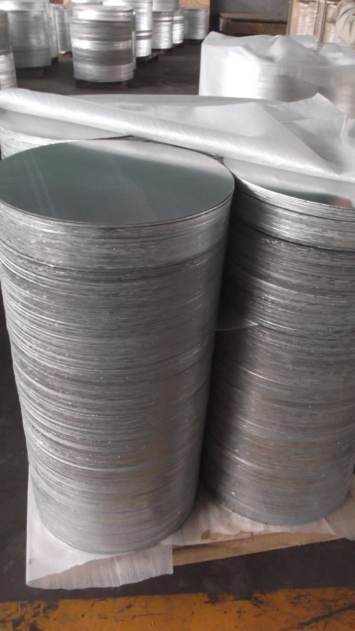

"The finest aluminum domes are made by Radian in the United States of America with a alloy nuance developed by Mitsubishi in order to build Japanese military planes during the war"
Yep I'm familiar with the origin of Duralumin, its applications and the Japanese successor: (Extra) Super Duralumin.

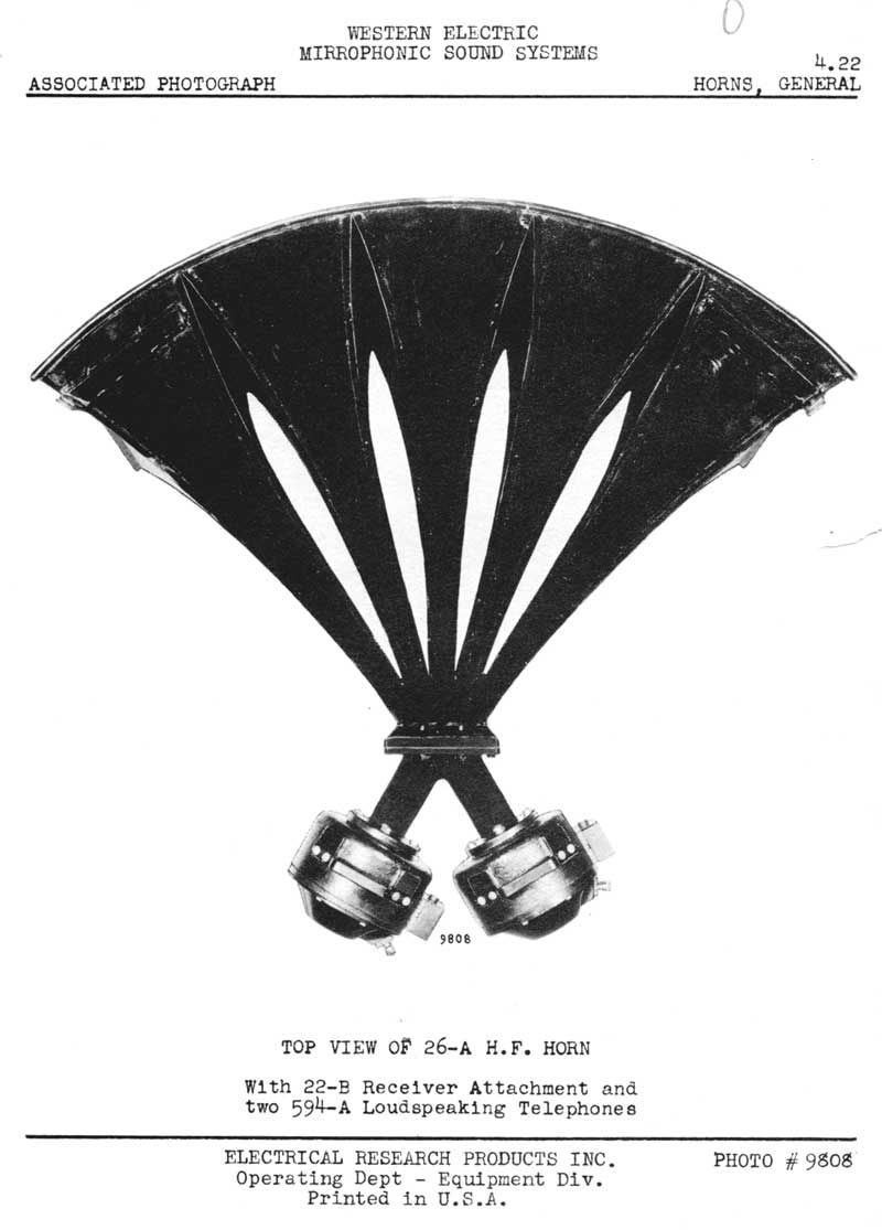

Agreed, but I guess the HF extension was more related to the use of modern drivers than to the horns.
In 1934 WE engineers already got the 594A flat to 13k, controlled within 0.25 dB and with minimal group delay.
It is known WE modified a few 5.. drivers to let them play up to 20k for some of the experimental setups.
803729d1576912797-western-electric-horns-594a-erpi_small-jpg
803730d1576912797-western-electric-horns-26-jpg

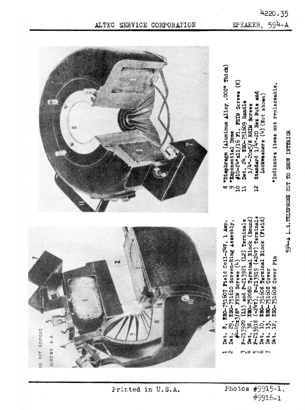

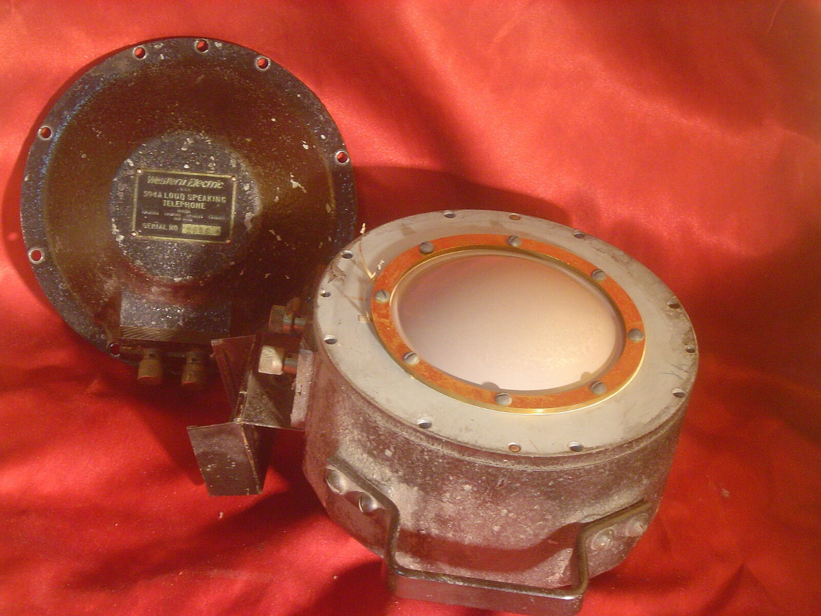

Part of the 594A's secret sauce, still not fully decomposed after 85 years:
