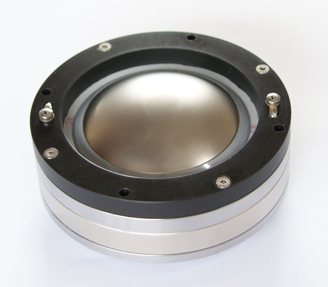

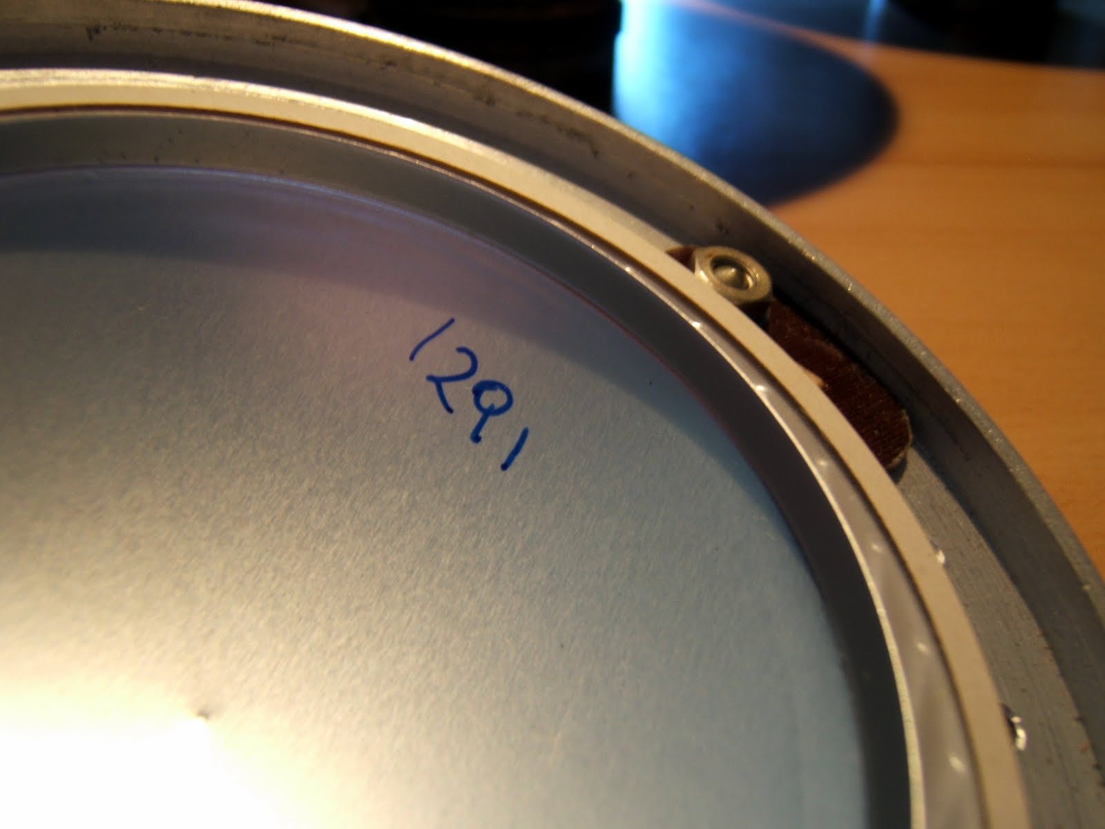

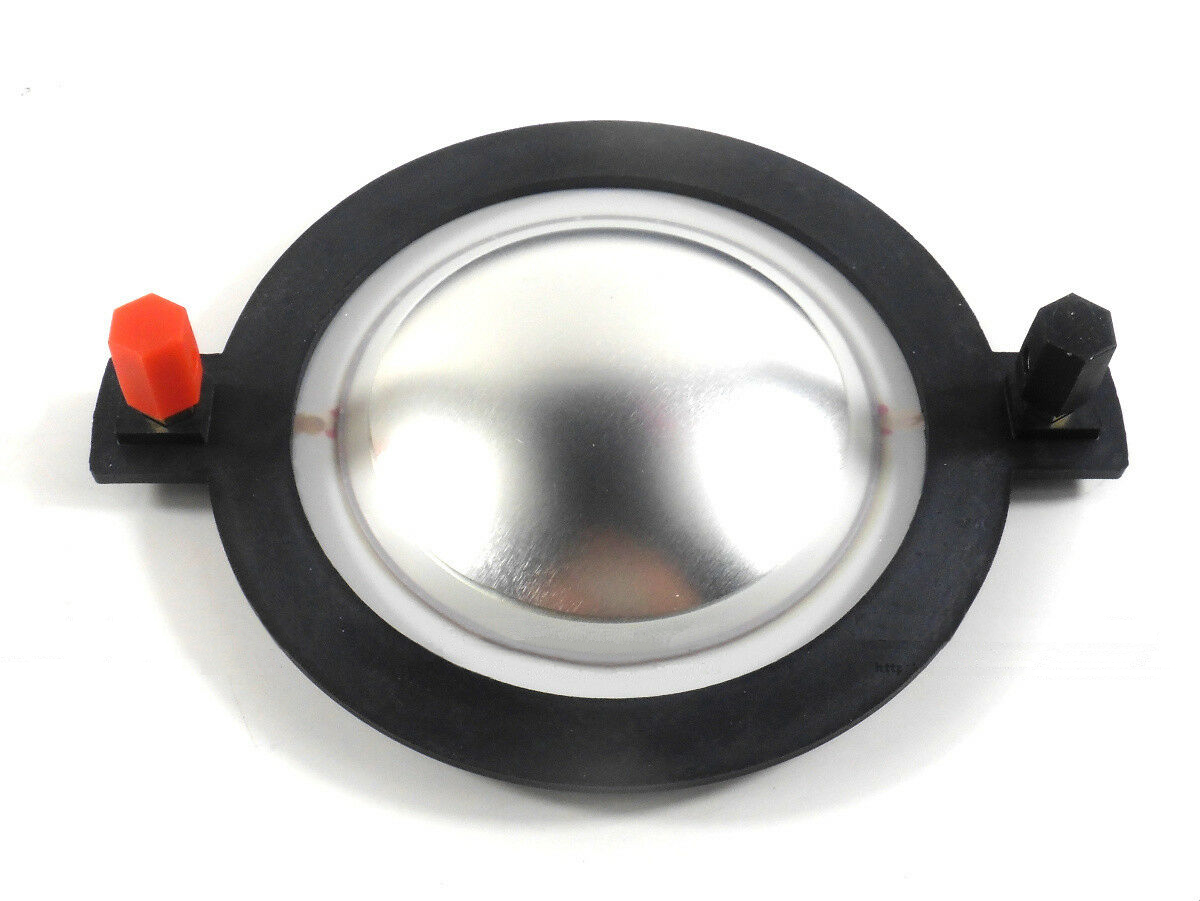

All kinds of modern diaphragm materials have come along, but how about good 'ol Aluminum?
This one is less than €20, instead of €120 for the original B&C Titanium shown previously:
Call me obsolete, but I don't believe in fixing what isn't broke, so other than Be [and even then JMMLC told me he could only just barely tell the difference between it and alum], I'm leaving well enough alone. As for Ti, I've only auditioned a few versions and all sounded like a metal shop brake shearing sheet tin.
Makes my teeth hurt, but then a lot of folks like sibilance to the point of boosting it as much as 6 dB, so can understand why many folks prefer Ti or similar.

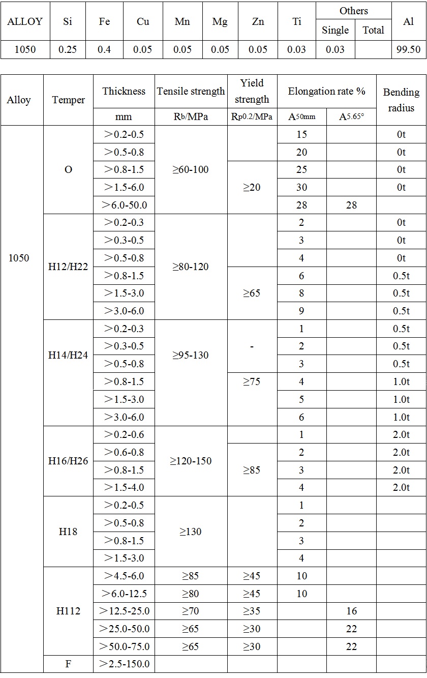

It looks like stamped 1050A part, the lamination creeks looks very deep, this finish is often used for alimentary parts like dining plates.
Thanks Silversprout. This is the kind of comment I've been waiting for.

The Radian diaphragms seems to be made of 7075 with a post forming heat treatement for stabilisation and hardness but i don't know anything more about the process. It is the only way to build a durable and stable dome made alumnium submitted to a gigacyle stress.

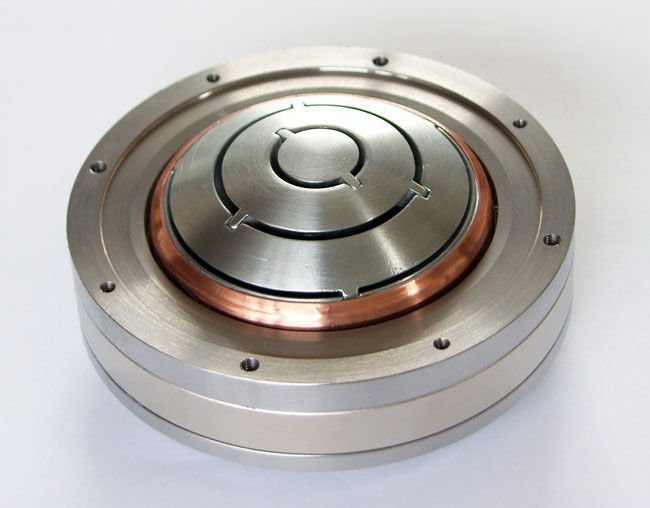

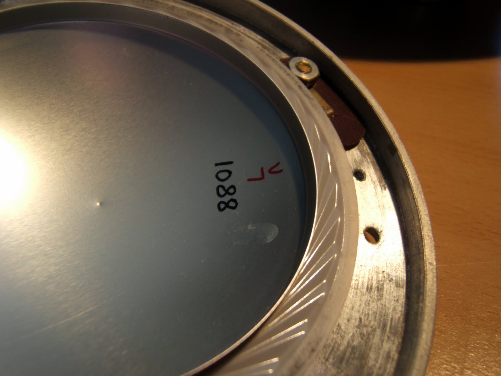

This Vitavox diaphragm doesn't look very different, even though it's 15-20x more expensive. Evidently, the VC and its fixation is a piece of art.
Multiple drivers can really be added to a single horn, but getting good results is not uncomplicated.Can I really add another pair of drivers to a horn? No complications?

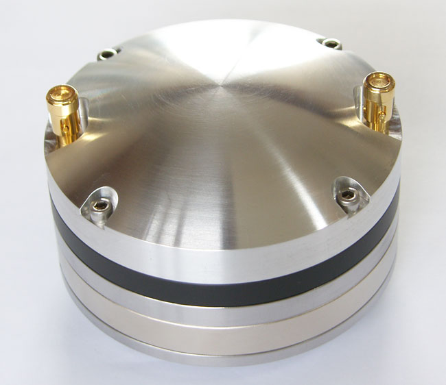

Dimentionnal sprecifications tolerances can change the cost to X1000
Geometrical sprecifications tolerances can change the cost to X1000
An alloy specifically developped for an application change the cost to X1000
The assembling process performed by trained experts change the cost to X1000
IOW, it's expensive 😀

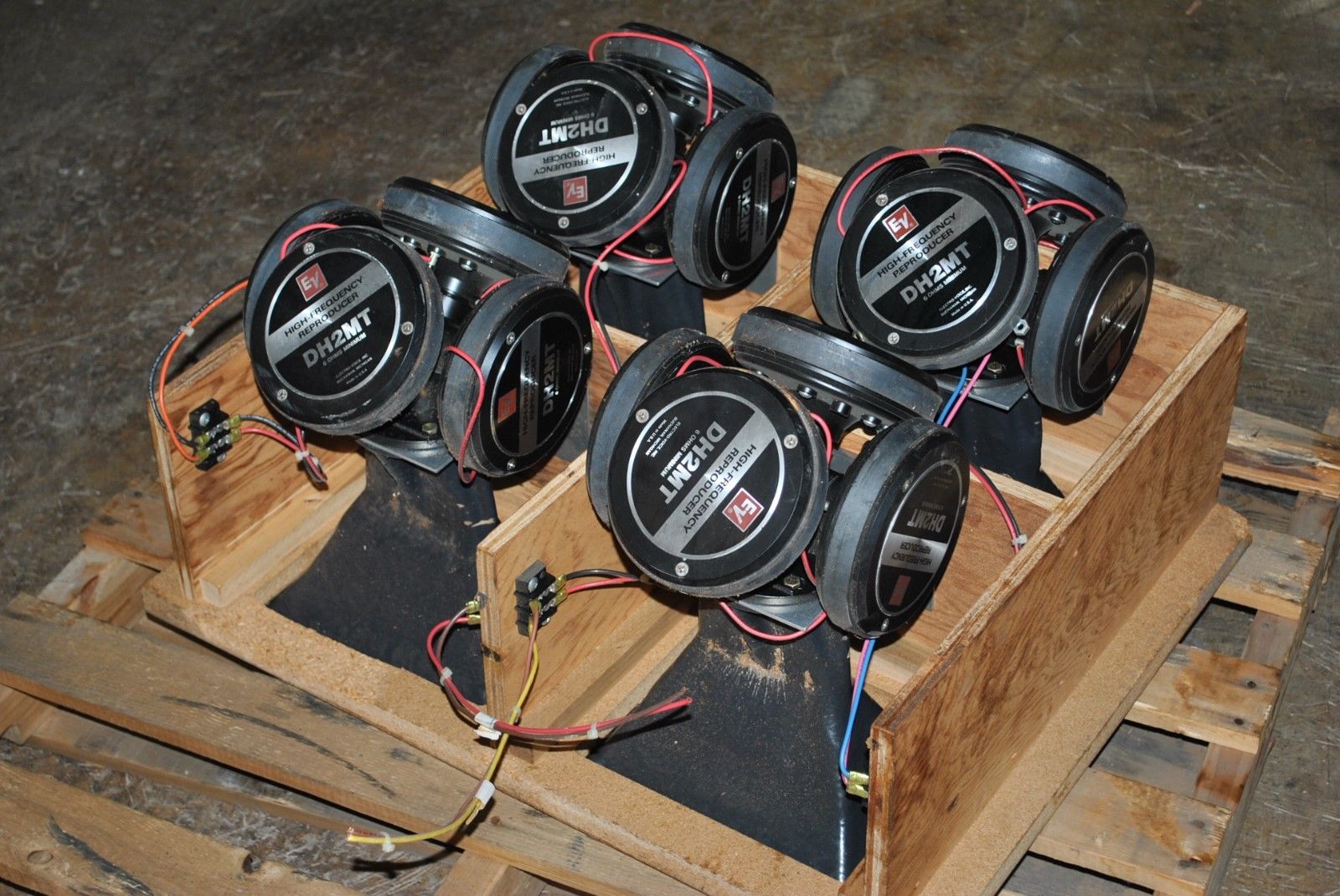

...To terrorize the neighbourhood.
And once you get started..IOW, it's expensive 😀
Well GM made that suggestion that I use multiple compression drivers to guarantee that I reach my low crossover.....and theres the pair of used Axi's for sale...idk?

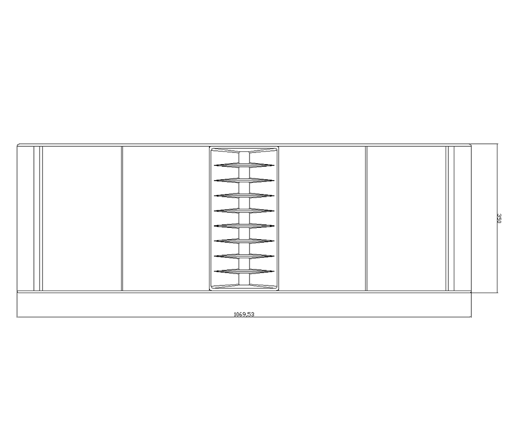

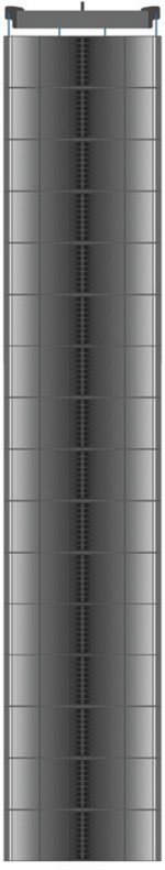

How about a line-array?
9 compression drivers in each cluster (element) X 16 for the full (supercluster) array = 144 drivers.

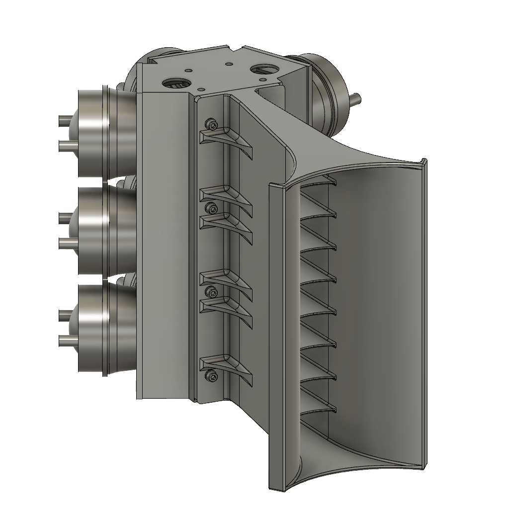

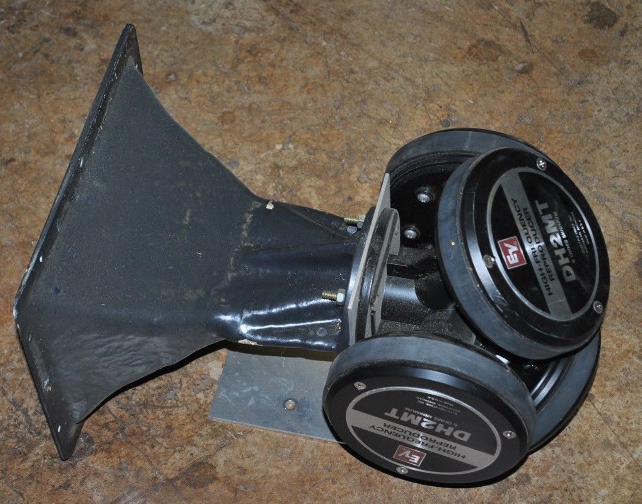

Seems like a good opportunity to revise this concept:
Here's an article about dual versus a single driver attached to one horn. It doesn't seem worthwile, but the manifold (adapter) looks like a huge bottleneck with its sharp angles and pinched throats.
For dual-Axi2050 duties, a traditional WE/Altec type short exponential manifold might work better, perhaps with vanes near the exit. The manifold could be attached to a properly sized (conical) mouth section, think: Klipsch K402. This way you'll end up with good loading as well as decent directivity.
Or just clone an 18-cell WE/Vitavox/Altec horn 😉
