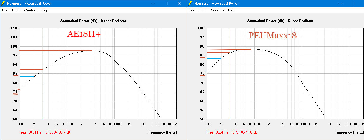

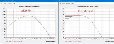

This driver has more output at 30hz than a Dayton Ultimax18.

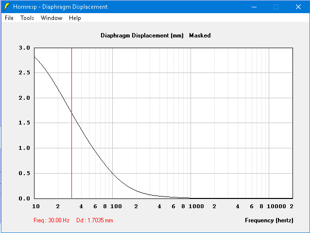

Heres excursion at 100db 30hz in a 380 lt sealed box.
That graph illustrates exactly my point. The difference between the horizontal lines is much greater on the TD18 it wants to thump out midbass and above, you can flatten the response out by EQ'ing the higher frequencies and you end up with a response that looks a lot like the Ultimax as is. The Ultimax is designed to be a subwoofer the TD18 is not. But in a sealed box with a lot of power or a lot of box and some EQ you can end up at the same place if the volume displacement is there. So the TD18 is flexible it can do both things, the Ultimax not so much.
Very low frequency reproduction comes from a sealed box with enough volume displacement to get to your desired SPL. That is either cone area excursion or a combination of the two.
For these sorts of comparisons I like to use Jeff Bagby's Woofer Designer spreadsheet as it has a linkwitz transform option. That allows an apples to apples comparison of drivers when EQ'd to the same target and Q. It shows how much box or how much power is needed to get to the displacement limit. Maybe Hornresp can do the same with the active filters I have never really tried.

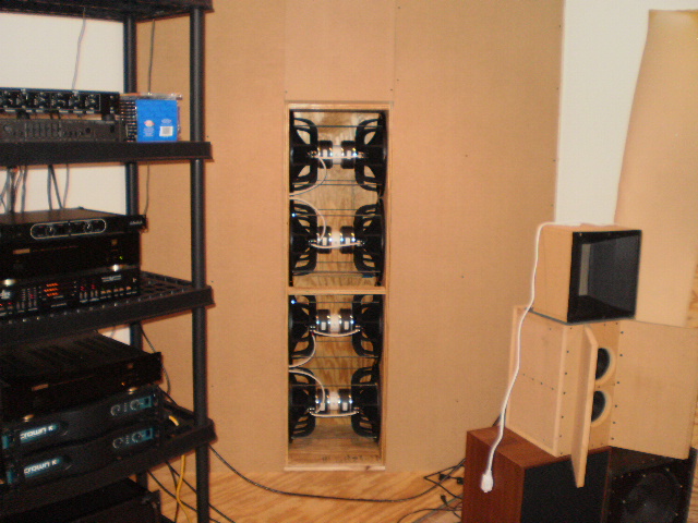

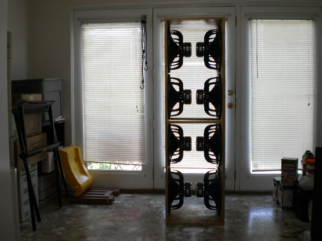

Ime, the big advantage of opposed sub drivers is the very large drop in cabinet vibration. This is of course for either push-push or push-pull.
I did not measure any significant difference in THD between push-push and push-pull, so I'm not in the crowd that thinks THD is reduced by push-pull.
I do hear more coil vent noise with push-pull, where one driver's coil is in the slot.
So imo, push push is the way to go, especially since the td18th+ has a phase plug that may be a problem clearance wise for push-pull.

Honestly I think cabinet vibration reduction is the only real advantage....but it is a huge advantage imo.

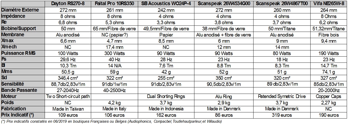

Earlier in this thread, the subject of (woofer) intermodulation distortion was discussed.
A French guy thoroughly tested a bunch of 10" woofers, mostly typical hi-fi drivers, and included IMD.
It's interesting to learn (though not surprising) the most expensive and overall best performing woofer
scored worst wrt IMD, notably with the double sine 30Hz + 500Hz.
