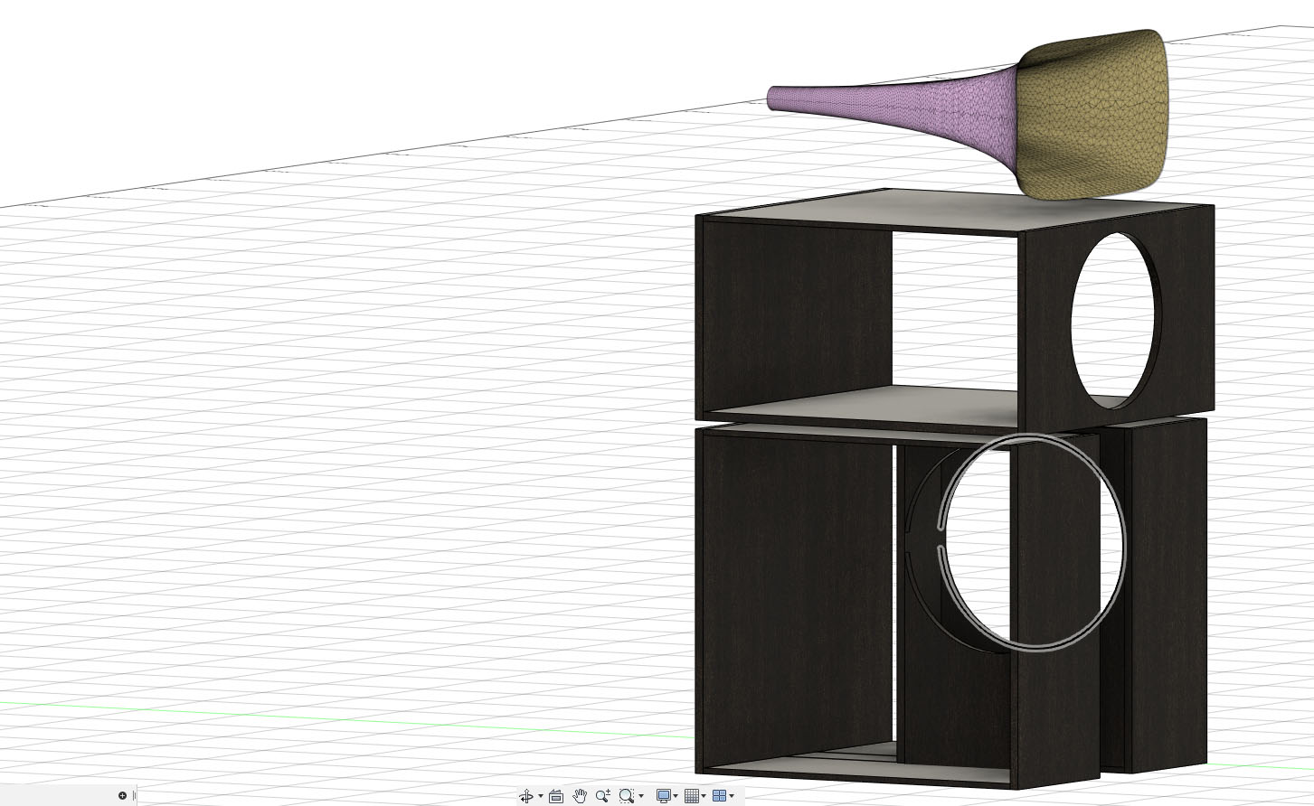

Thank you for posting that again! While playing with slot loading, I had the thought, "that one guy told me about slot loading, but I couldn't model it right".....you are that "one guy" lol. Sorry, not the best memory.
My issue is what to do with the 2 18"s...Slot loading vertically, face to face, reduces their foot print. I can do that horizontally but that forces the distance from ear down a little and distance from the above source. In the near field, minute changes like this do make a difference, whether these specific changes are detrimental or not, I don't play that game, I just try and error towards SQ.
- you're a cheaterI made the slots V shaped and got the TD15s to play past 600 Hz.

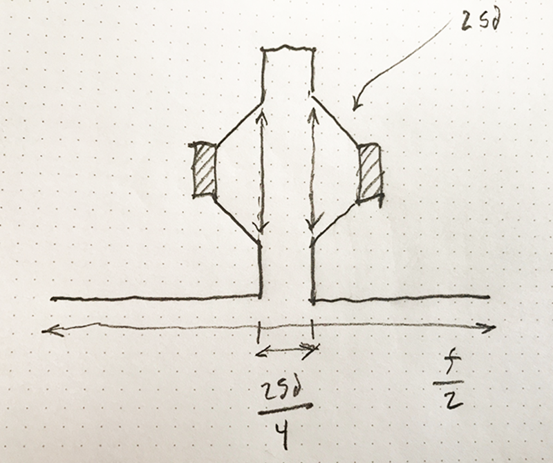

Just like but with a vertical slot. It is Djk, if I recall, who experimented with different slot width ratios, including 1:2.
Here's the configuration I commonly come across showing 1:4 gaps are used too.
I haven't encountered any discussion about slot width vs diaphragm diameter before....or any ratio thereof...interesting...
I've always thought slot width is simply the width of the slot between the driver baffles...and that it's 1/4WL size is the upper end of usable response..
I just made it a front loaded horn with the initial CSA the height*width of the slot. length, the literal length of the slot, even though its not exact since a part of woofer is right at the mouth. To simulate pressure of anothger woofer firing at another, halve csa, for an estimation, I'd say.
