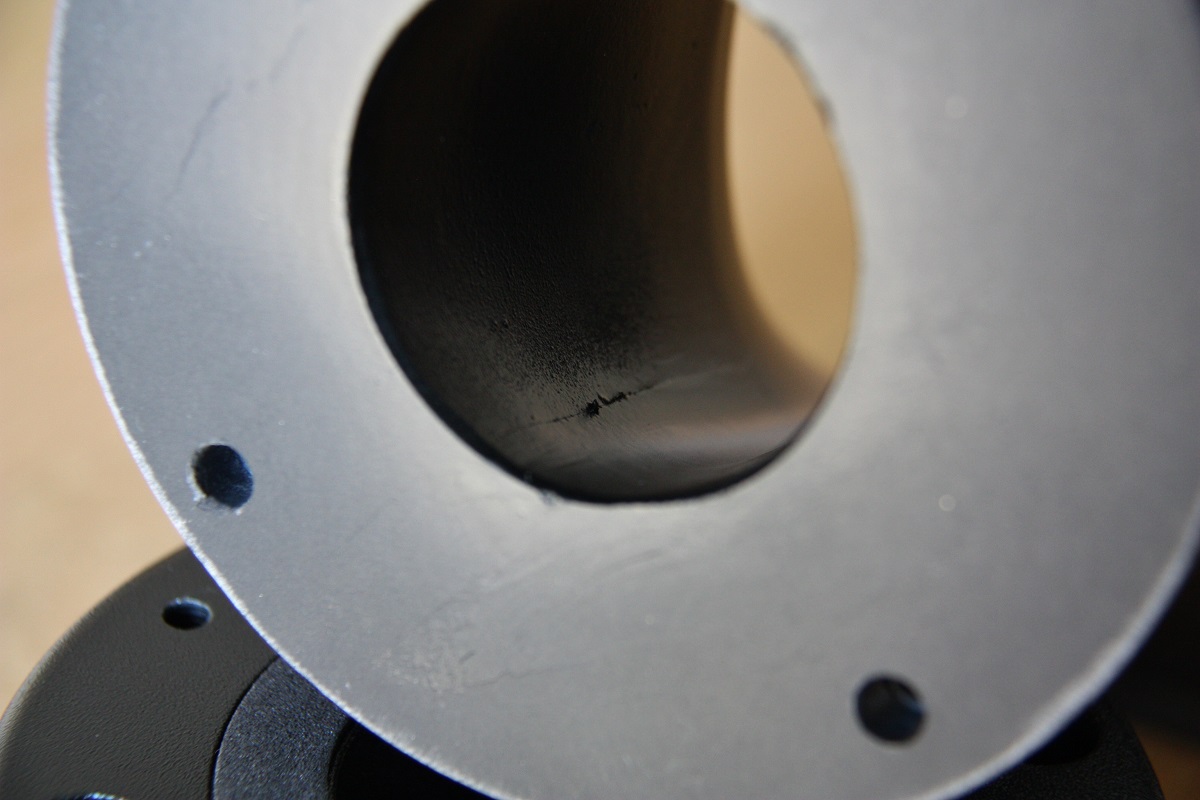

Back in the day, Be diaphragms were blown regularly (poisoning everyone near the horn mouth), mainly due to poor sound system / FOH management, or other forms of abuse.
The diaphragms literally cracked, so indeed: mechanically.
Example of a cracked "cheap" aftermarket Be diaphragm. I believe this one was damaged during shipment.

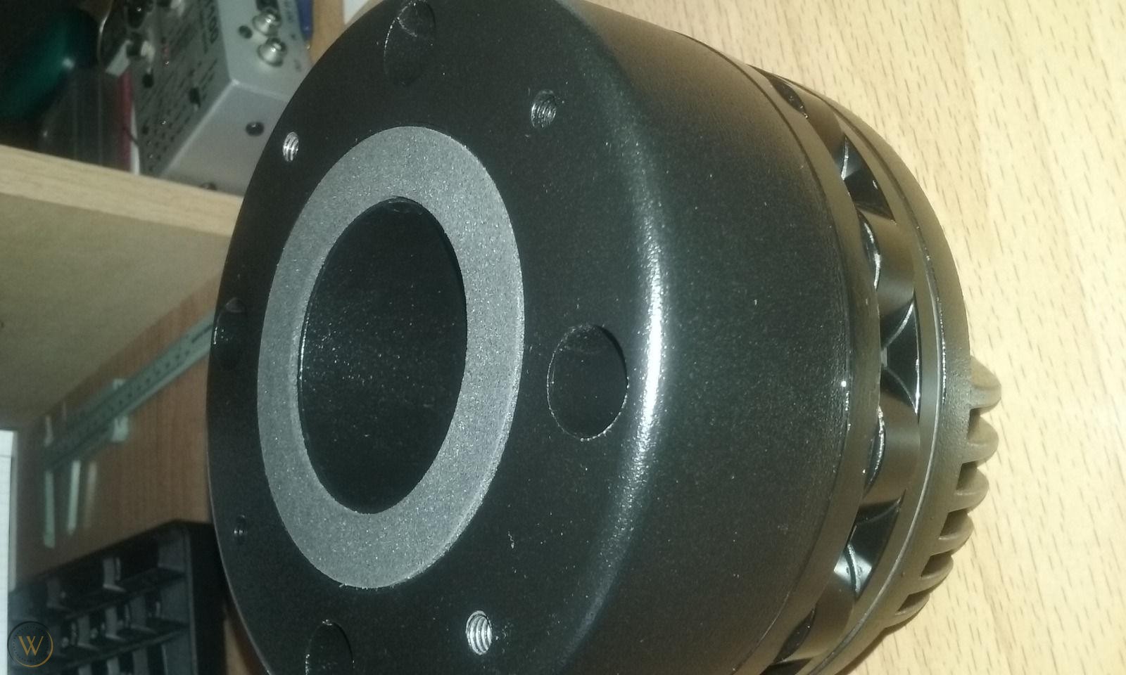

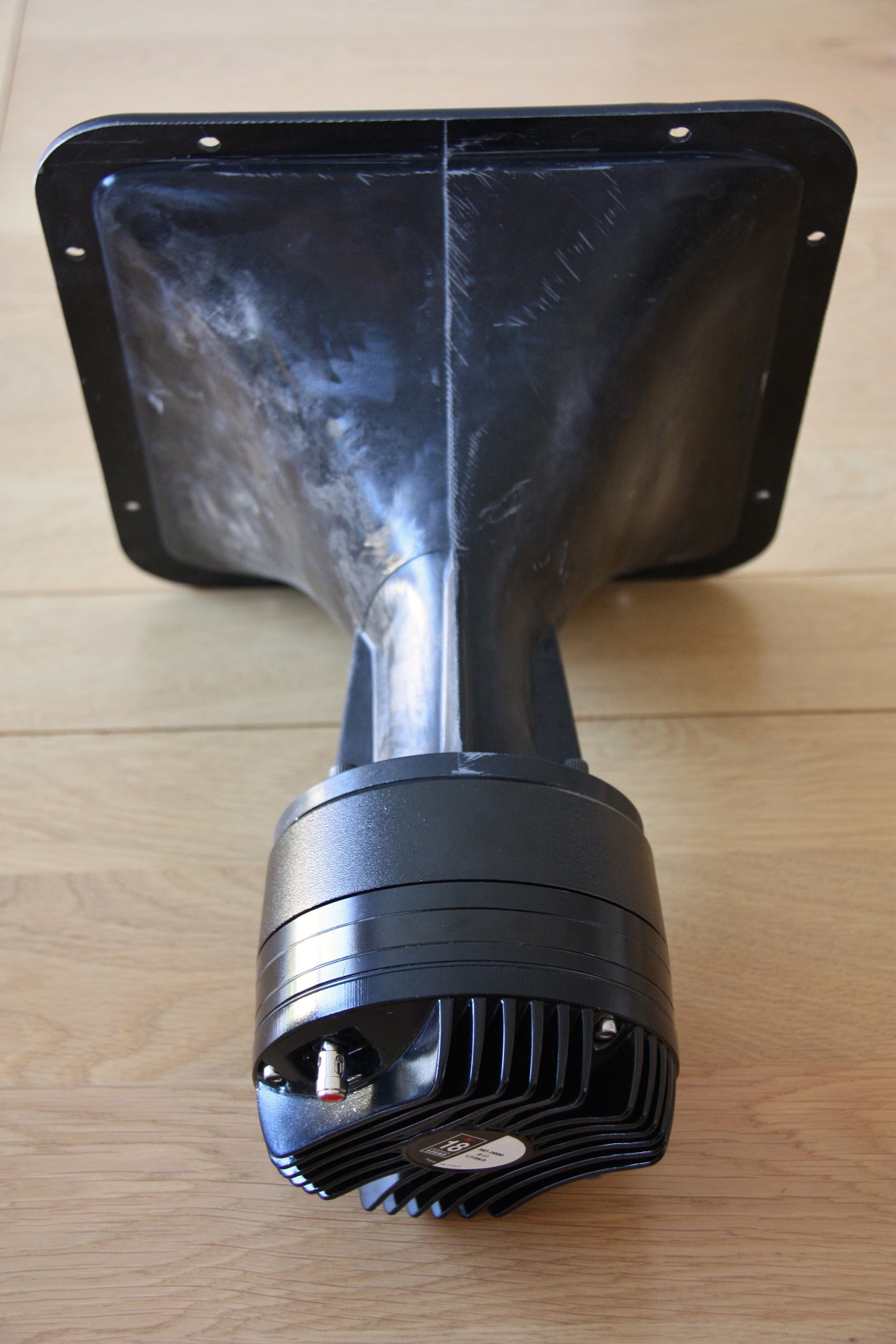

Strauss presumably used some smart (crossover) tricks. One clue is the lower sensitivity of his MF2.2 compared to its predecessor. For the latter, the big old Sony SUP-T11 was used, which features a generous exit section, whereas the comp. driver in the .2 is pancake-like.
Pancake drivers (phase plugs near the exit) are likely to combine better with the rather short horn path and approx. 25° entrance angle of the 2380 (a). However, loading should theoretically suffer.
