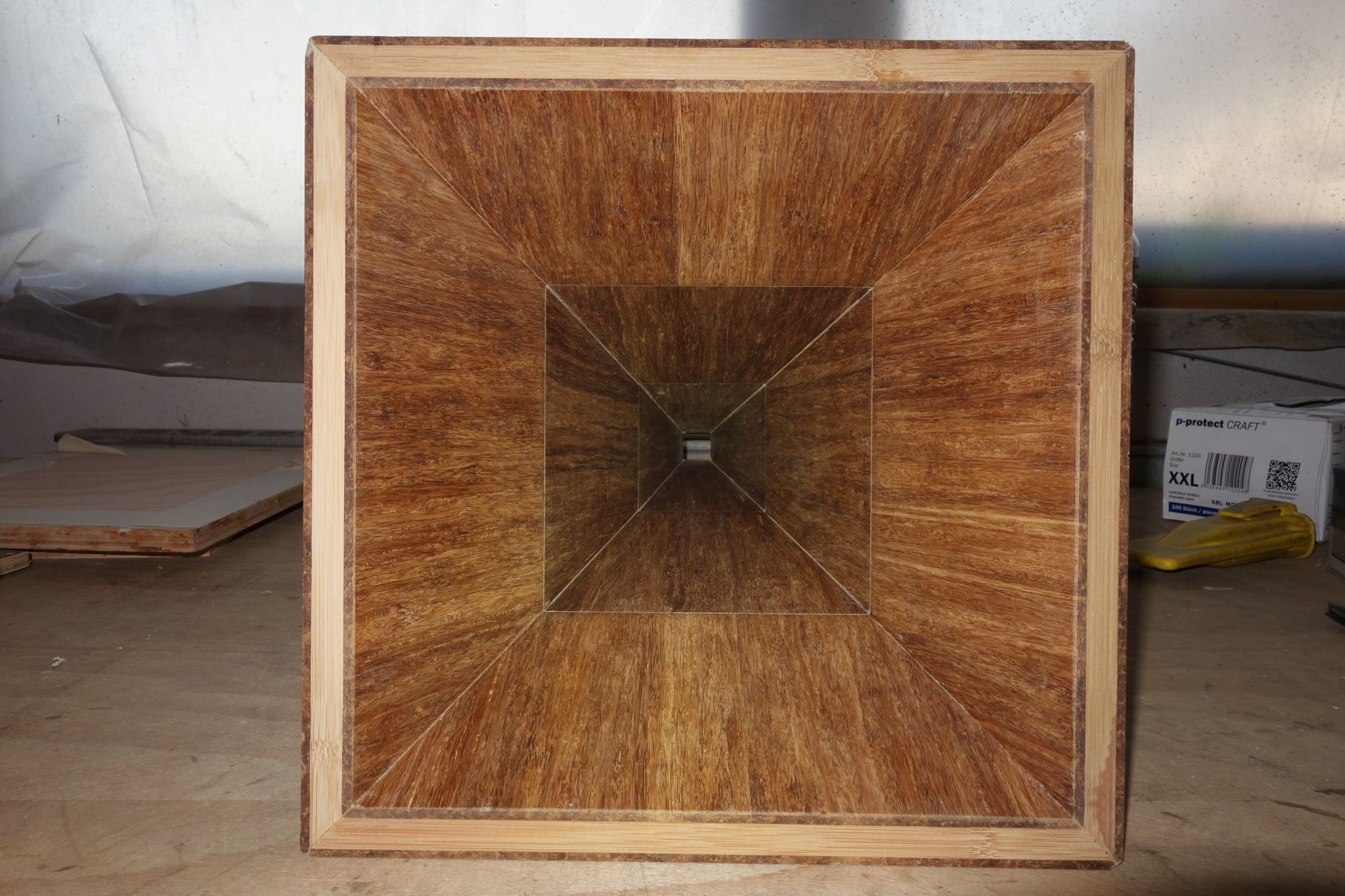

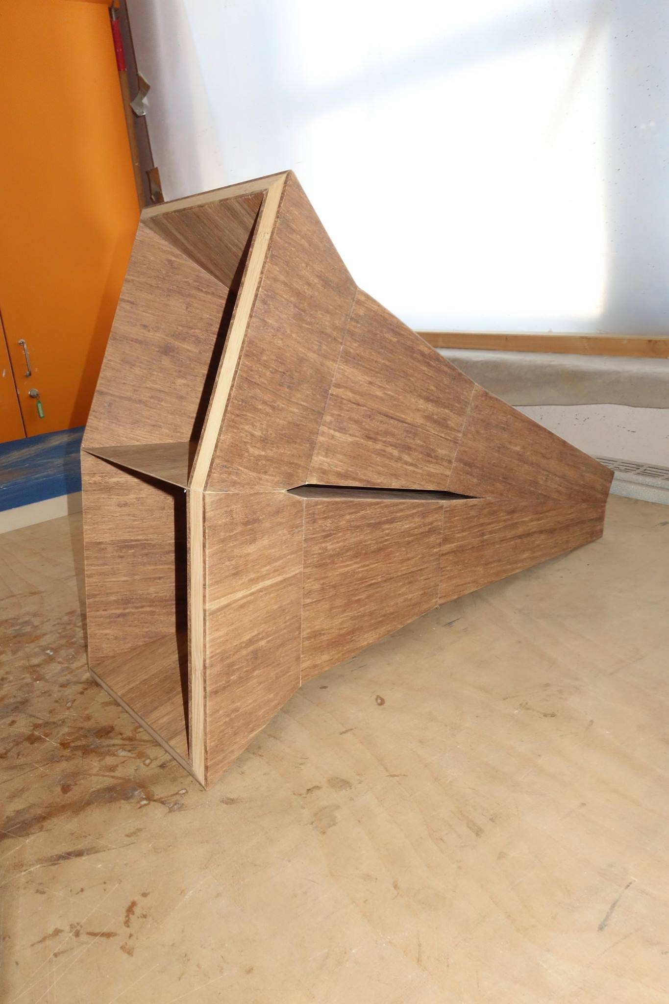

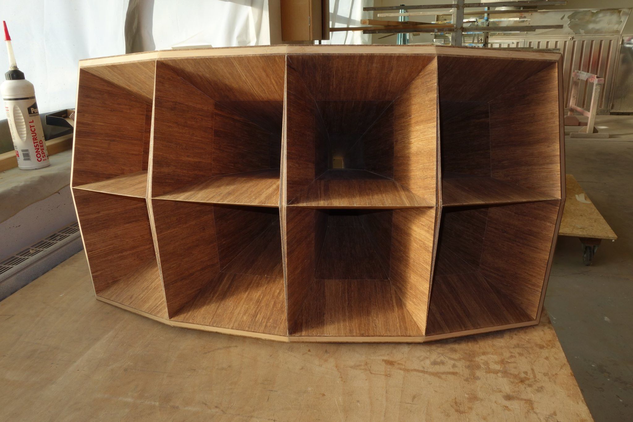

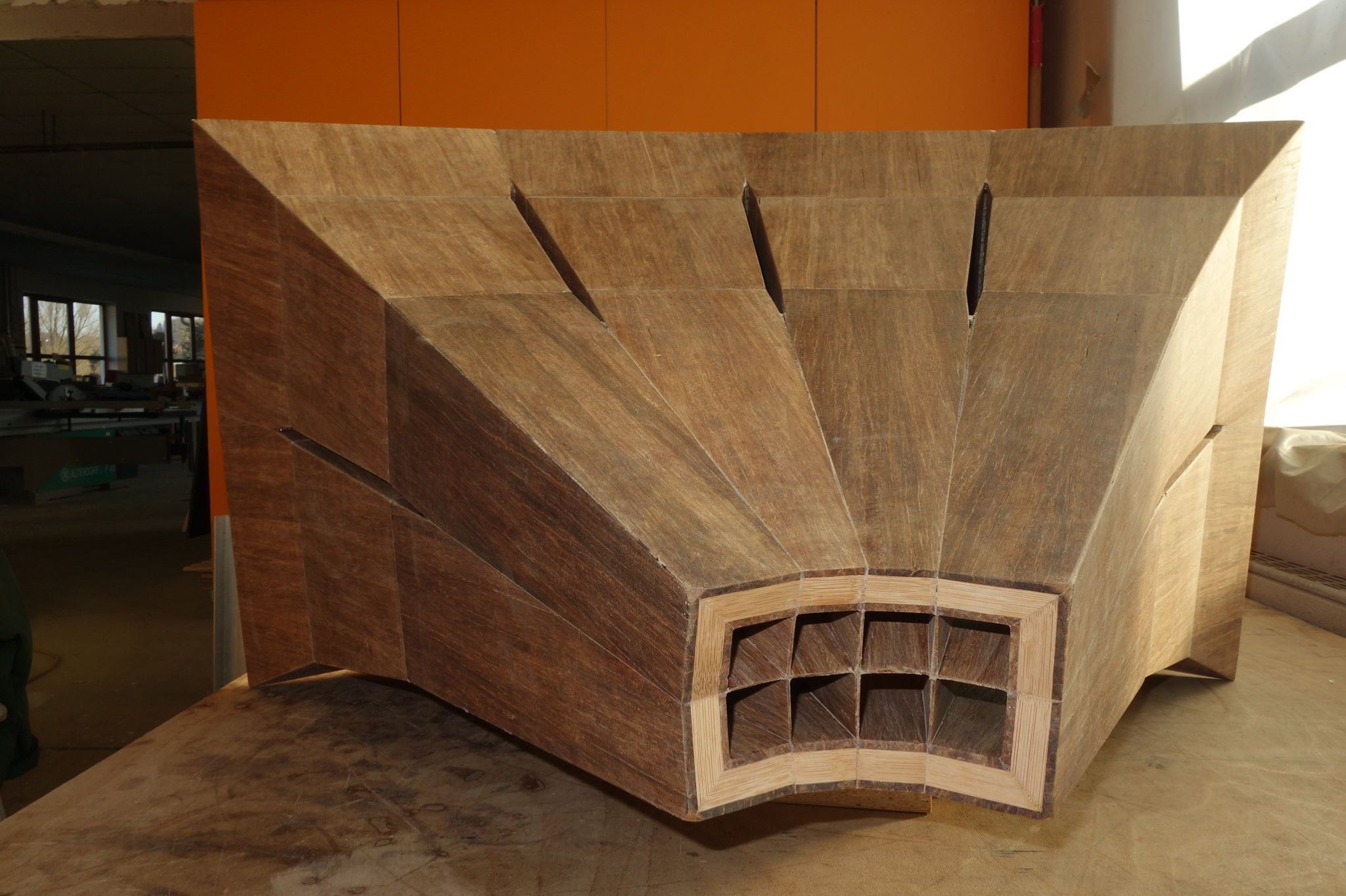

Since it is quiet here, I drop some proper dual manifold horn porn.

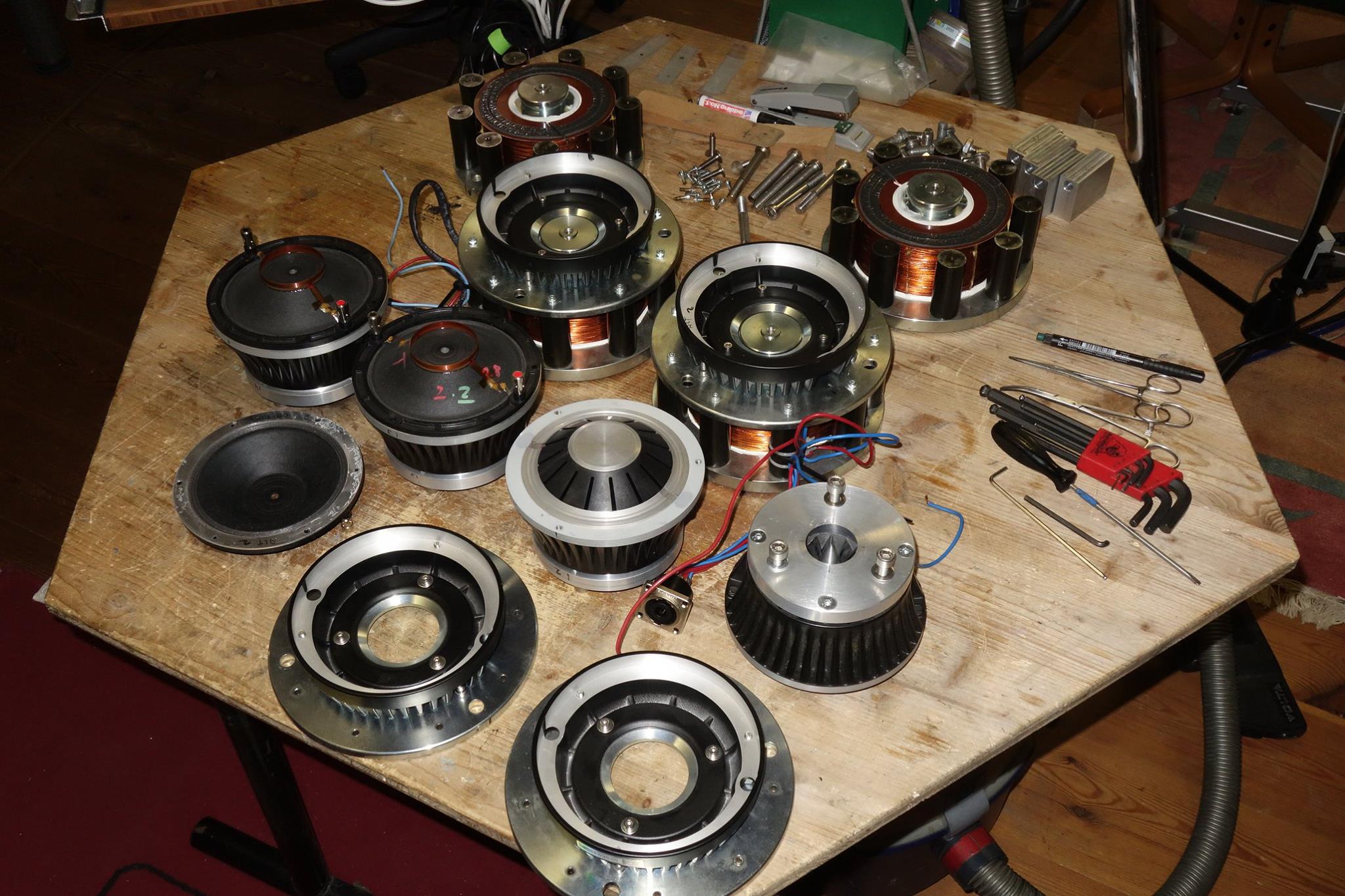

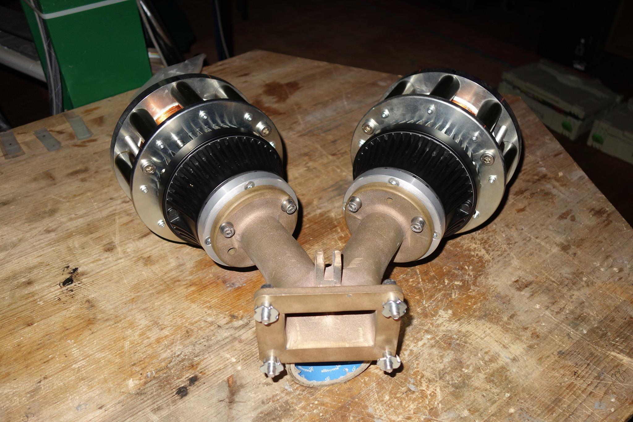

B&C DCM50 converted to field-coil by Wolf von Langa.
A flange was made to attach the drivers to the Altec dual throat adapter.
