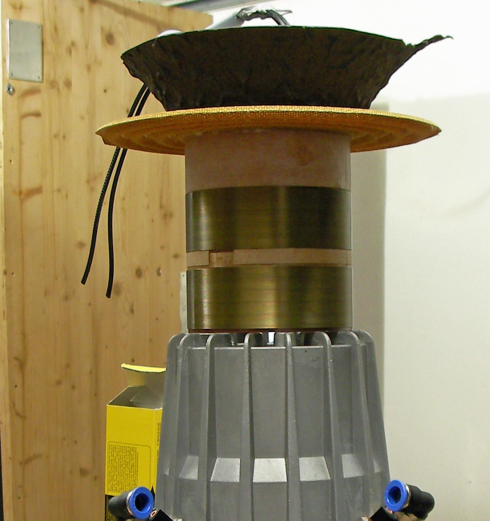

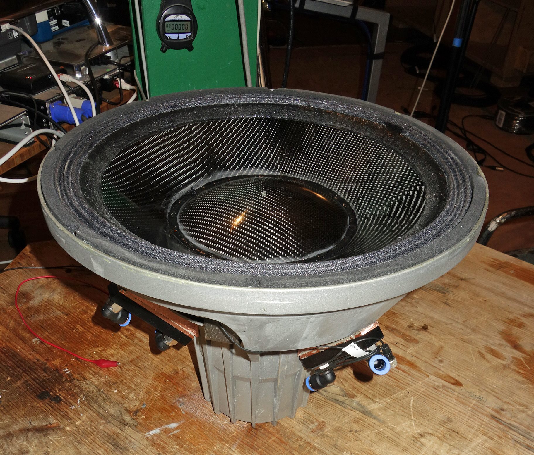

The big 18 kW bass horn is loaded by 6 x liquid cooled JBL 2267 with custom (made by Miller Instruments) carbon diaphragms and includes an optical diaphragm displacement sensor.
Liquid cooled...forgot about those...and here I am thinking about putting a computer fan on the back of the magnet structure.

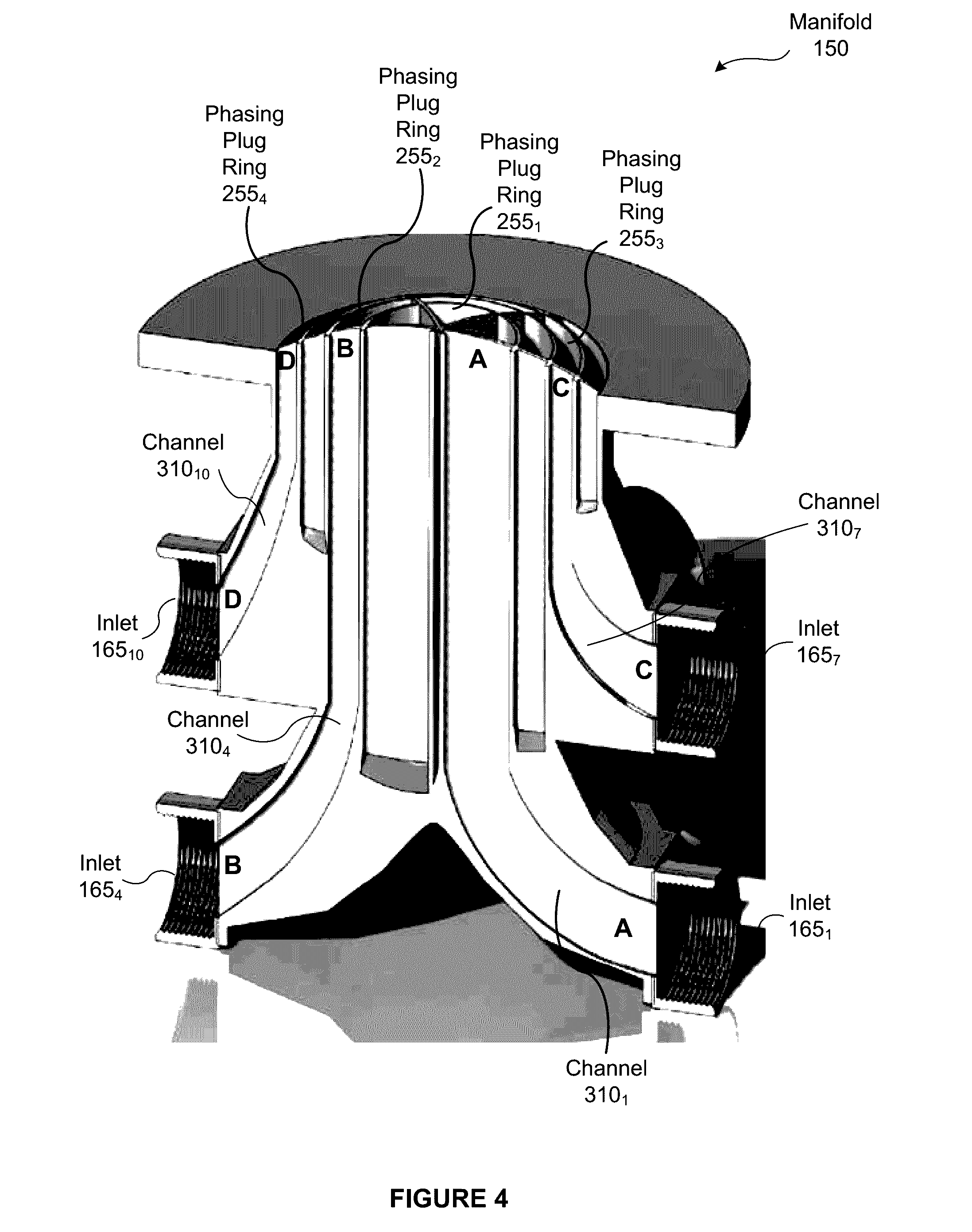

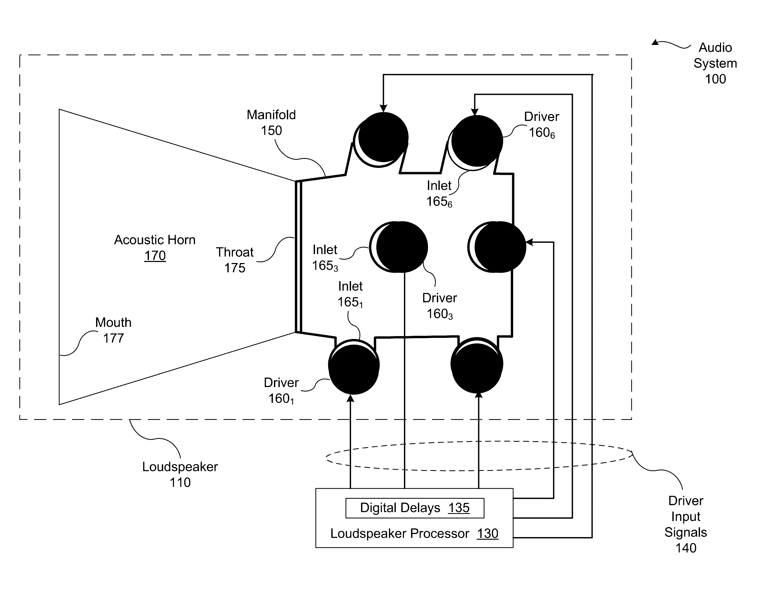

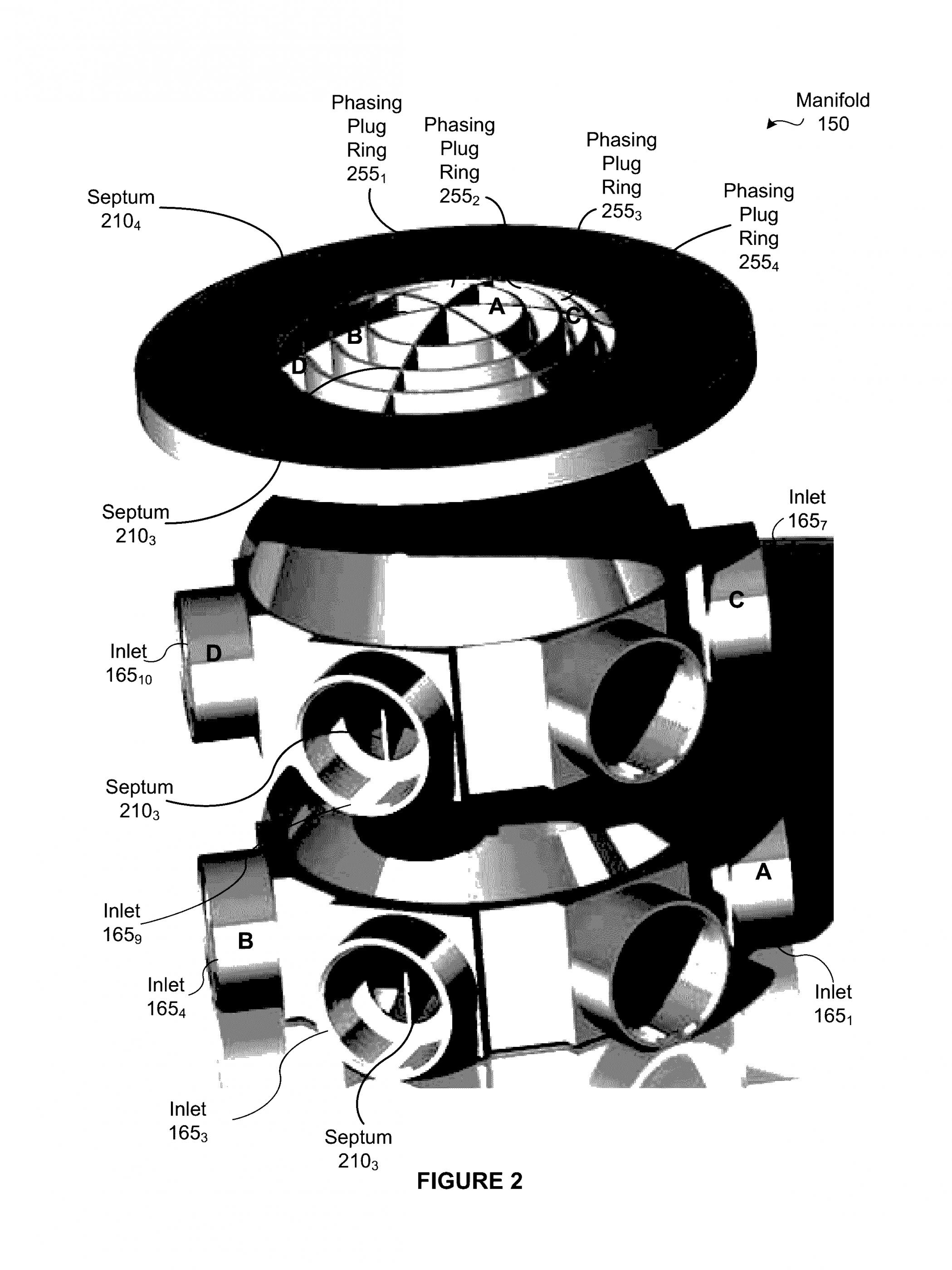

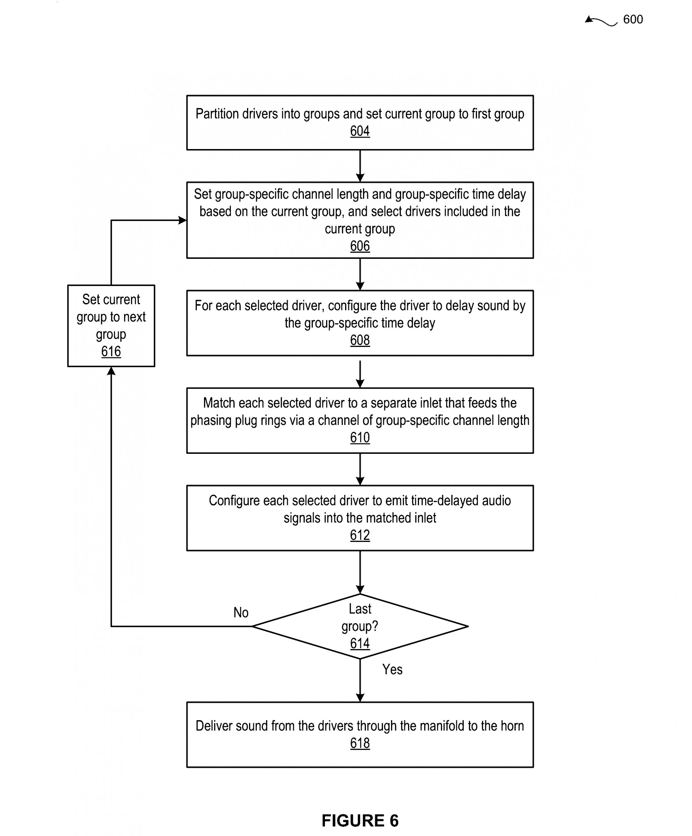

This seems to be a more sensible approach to manifolding multiple drivers.
US20160366510A1_Manifold for multiple compression drivers with a single point source exit, Dougl.pdf1.8 MB · Views: 116

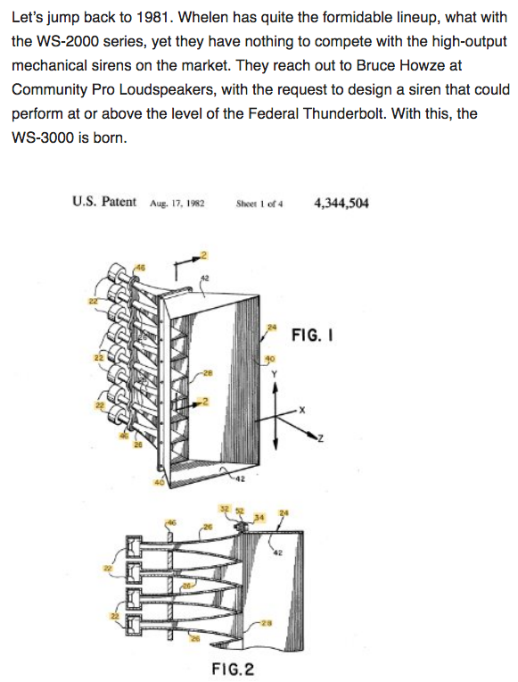

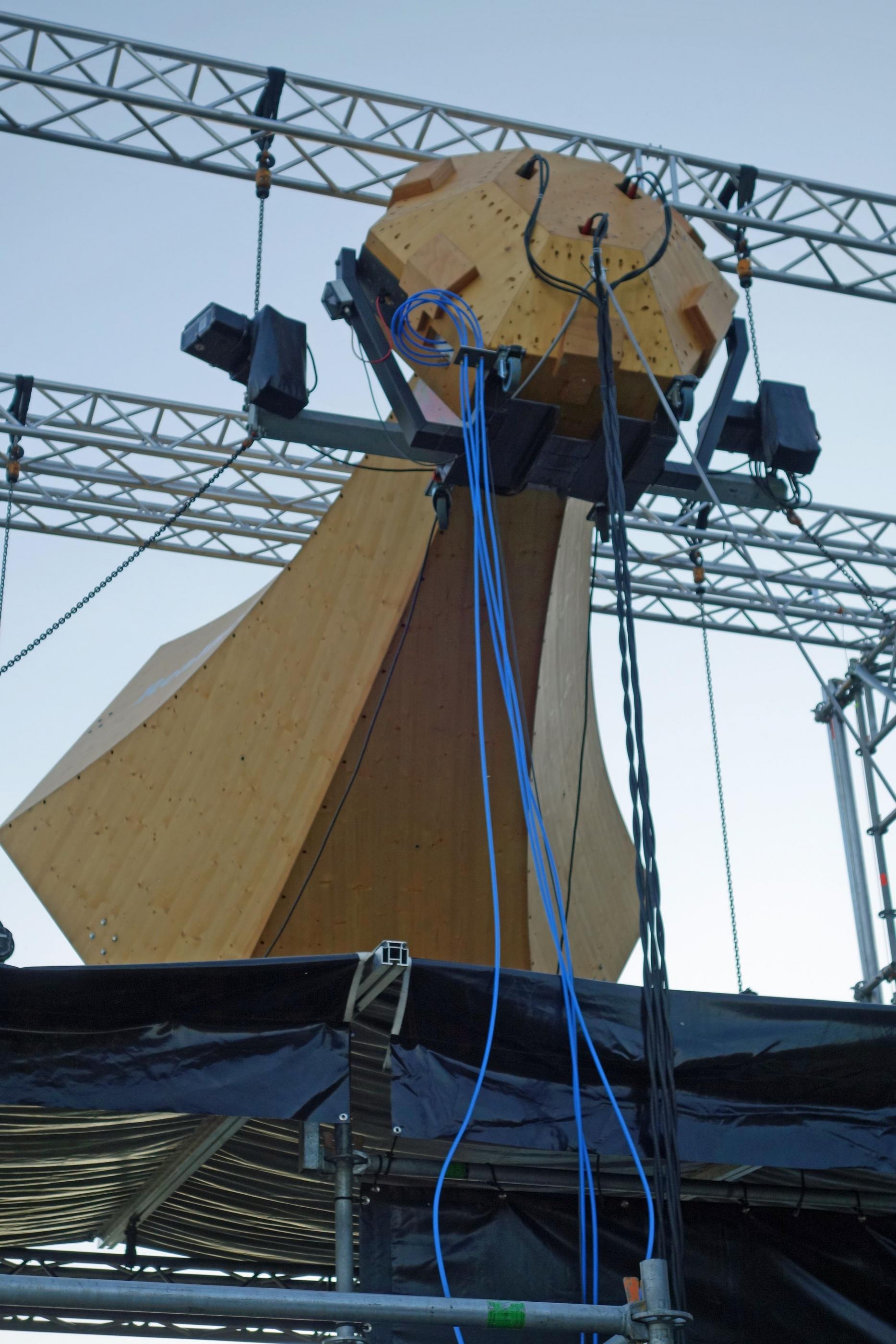

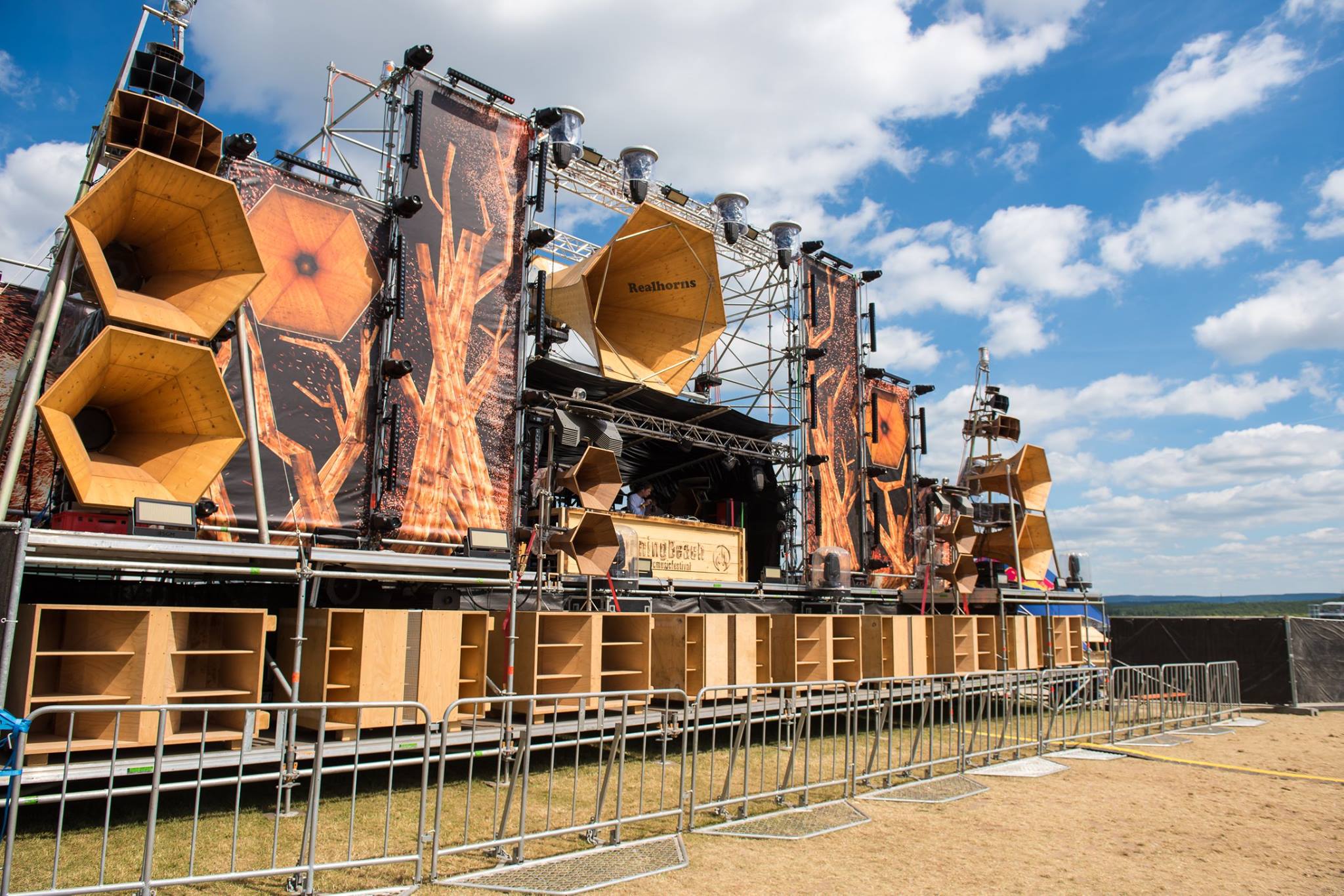

Not as sensible as Bruce Howze's 1981 approach, later adopted in the MTH-4.5/42B after EV's engineers realized the combining the output of too many drivers through a small throat does not work very well.This seems to be a more sensible approach to manifolding multiple drivers.
That said, for a two-way design of the SPL required by the OP, multiple HF drivers are not required anyway.
Art
That is indeed a smart solution, albeit with limited coverage (presumably for stacking purposes).
Were your own Maltese horns inspired by the MTH?

The inspiration for systems like the Maltese or MTH date back to multi-cell horns. Instead of one driver split between multiple horns, the large venues and higher SPL expectations required each narrow-coverage cell to have it's own driver.Were your own Maltese horns inspired by the MTH?

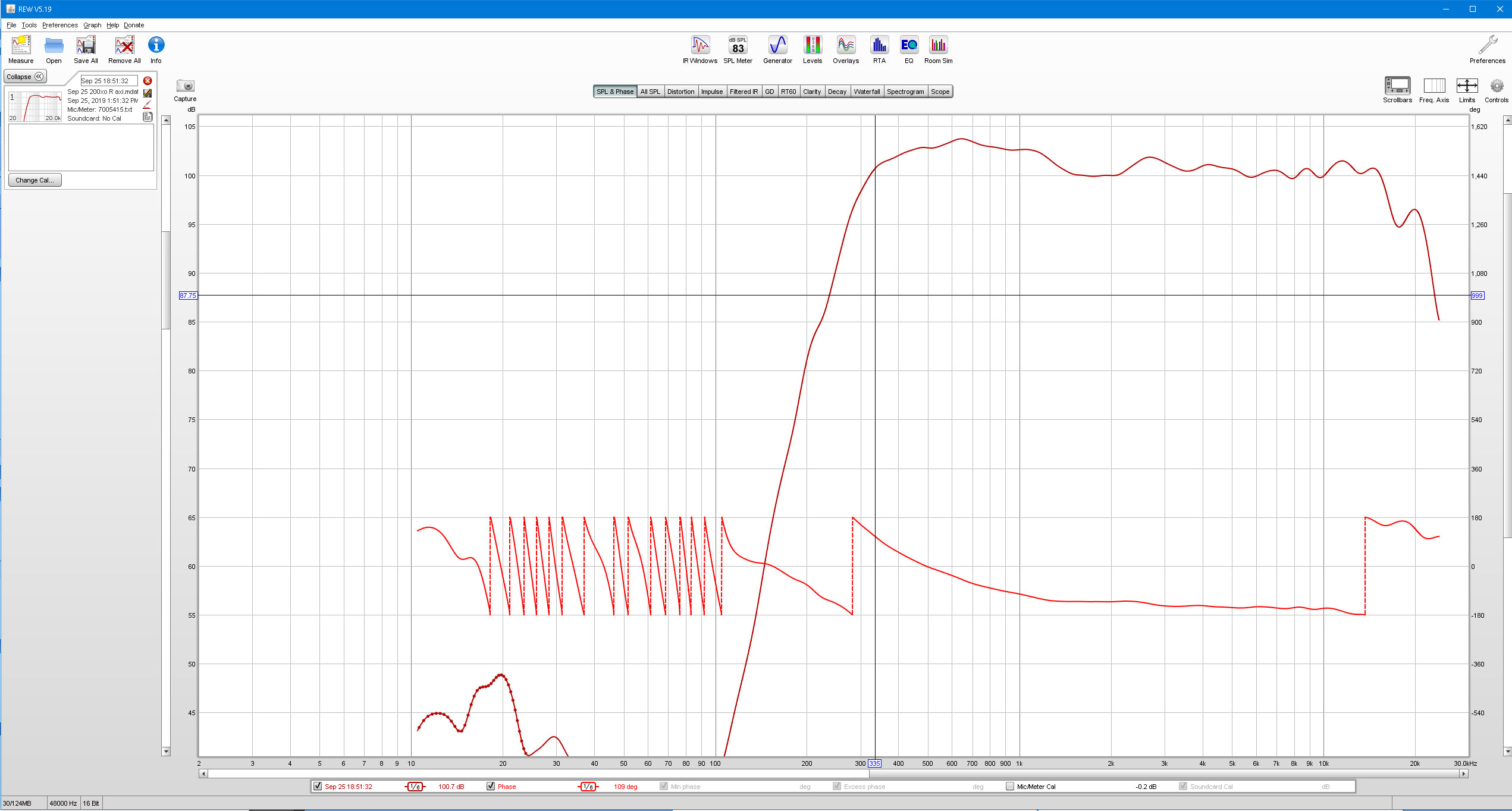

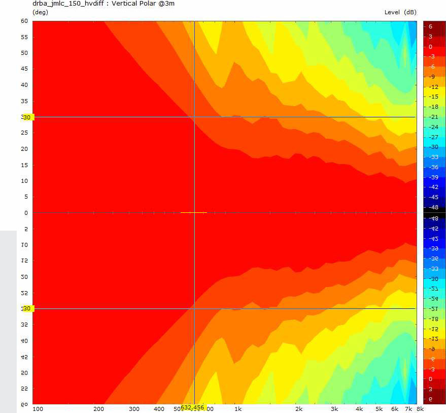

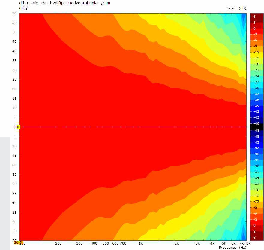

The dbra_jmlc polars look good/usable, provided they do not turn into a laser beam > 8k.
Considering your objectives and the room, some (but not excessive) narrowing may even be beneficial, as it eliminates the need for excessive eq. in the top octave, amongst other things.
The sophisticated phase plug of the Axi2050 might also help (a little) to reduce narrowing.
