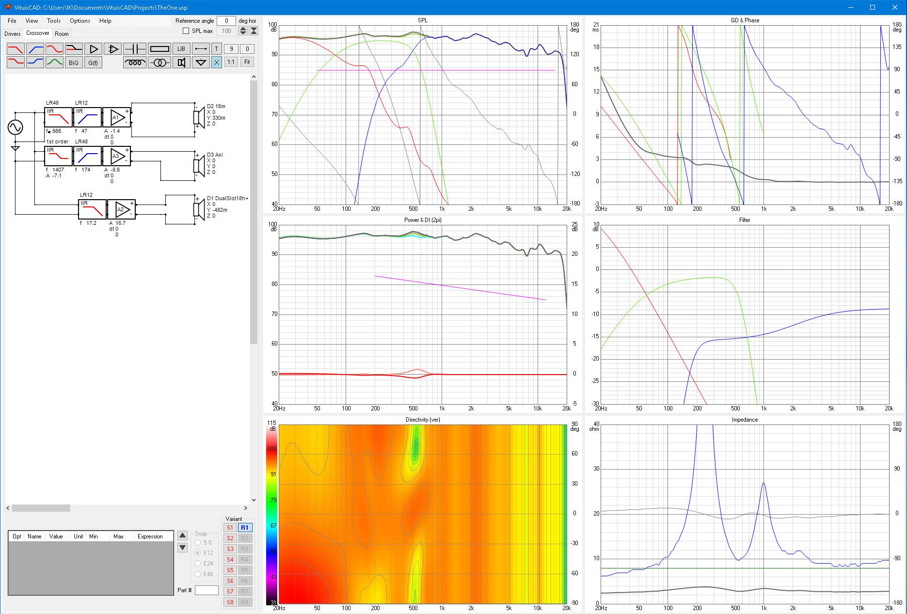

Playing around with VituixCad, is there a way to enter driver diameter? Or another free program that will let me get a little more intimate with the polar modelling...something that is user friendly, not Abec....
Also, I either heard or get the notion that having to eq over the crossover band (voicing or room eq)....sucks?

Hi, quickest way to success is to build a prototype, measure the polars (aka. spinorama) then model the crossovers and listen. Tweak, built better proto if needed, rinse and repeat. No amount of modeling will be as accurate as measurements. Sorry, no shortcut to happiness 😉 A single prototype box will also tell you aspects of mechanical challenges with such a big speaker build. Eventually, you'll get so much more satisfying speaker with one or two prototypes than without. Have fun!
Hi Camplo:
Vituix will do all you ask and more but you might have to RTFM to find out how🙂 To save you time, I will give you some hints.
If you don't have axial measurements, use its SPL Trace tool to get equivalent from the data sheet FR graph. Then open Diffraction tool to enter piston diameter, baffle shape, etc. Then in lower right, point diffraction tool at your measurement or trace data, check all the boxes to synthesize directivity based on piston diameter, and check export. Back in the main screen, point the driver screen at that synthesized directivity then right clock on the directivity graph and ask it for a polar map. After you take detailed measurements, replace synthesized directivity files with measured equivalents.

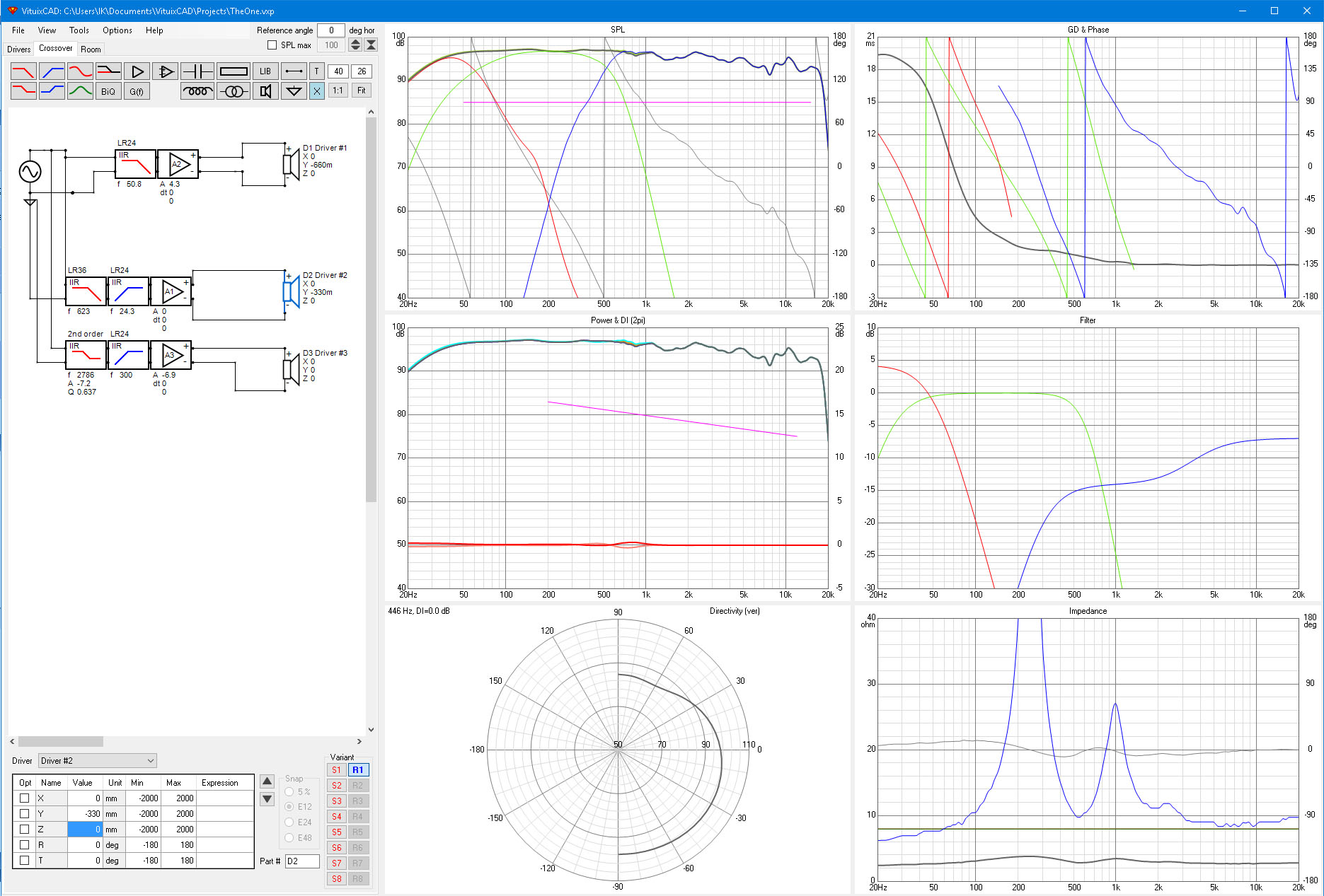

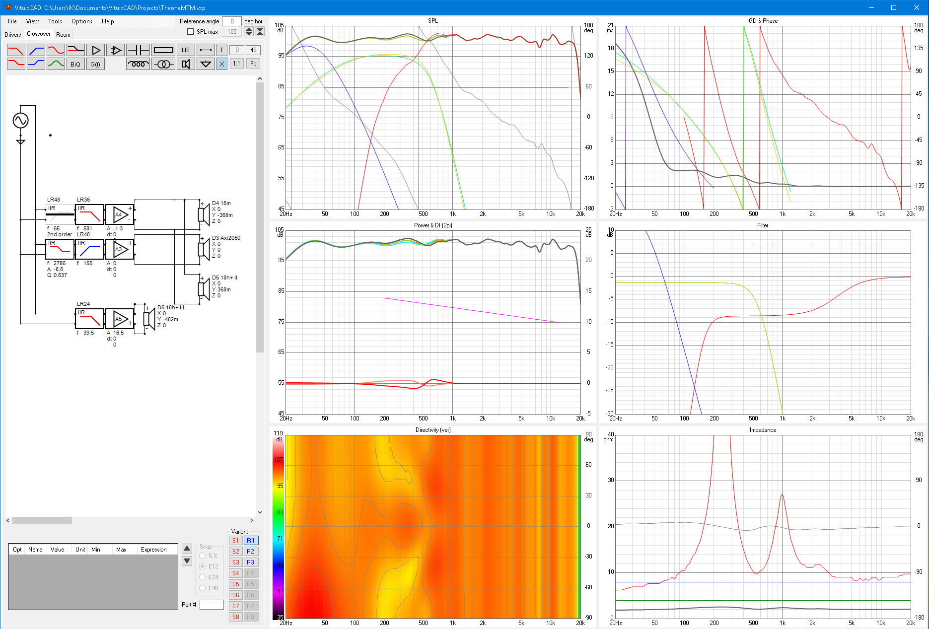

Nc535, ty for sharing, I've been up trying different, I'll have intake your info and go at it soon. I really like how things are turning out with puting the 15m about the Axi...the first sim has the 18h+'s combine in slot, the last one is best I could model to represent one 18 facing forward and another facing the floor, both crossed different...a strange mtm vs a mtw of sorts...
attachment.php
attachment.php
I'm just experimenting, this is the Axi response on Soes 30, hopefully I can get a better idea of what I'm about to try build after I learn more about the program.

Yes, there is a learning curve and the way to learn is what you are doing.
I can see you don't have good directivity data yet, if using SEOS30, I can see why.
Below pattern control frequency, mouth size controls polar response so use it in diffraction tool following Vituix advice for a planar radiator - model it as a number of horizontal slices stacked together

A basic representation of my 18"

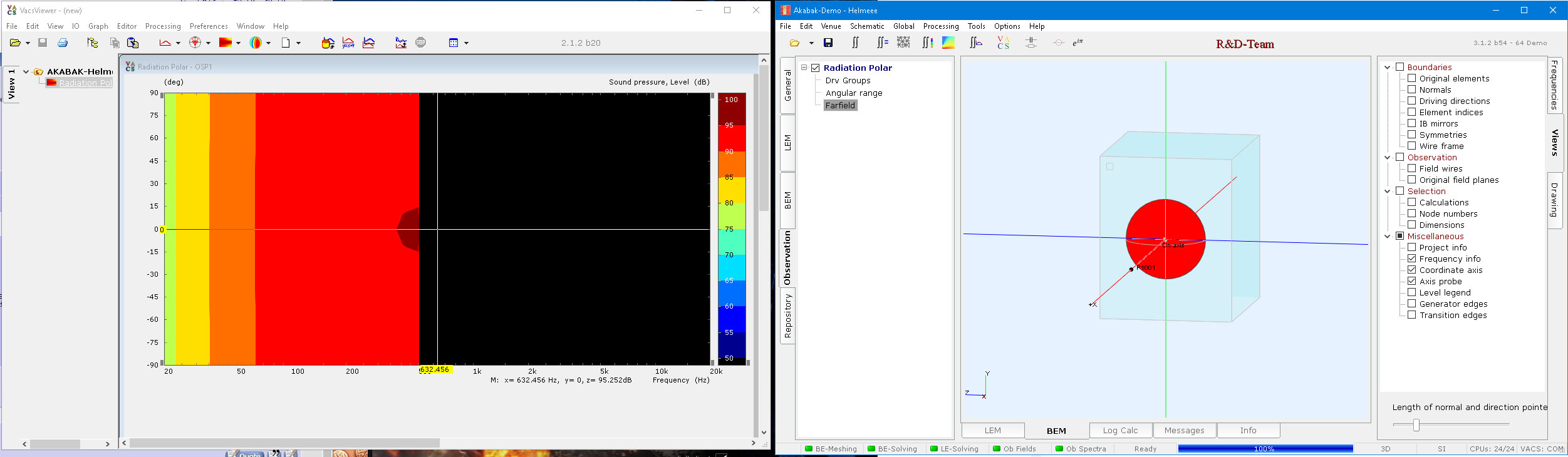

Making a little progress.... this video might helped me get the ball rolling...I'm not sure I could create a box with 2 drivers yet...cause I have no idea how it knows to be where its at dont his model lol! This is more than I could do yesterday though...progress!

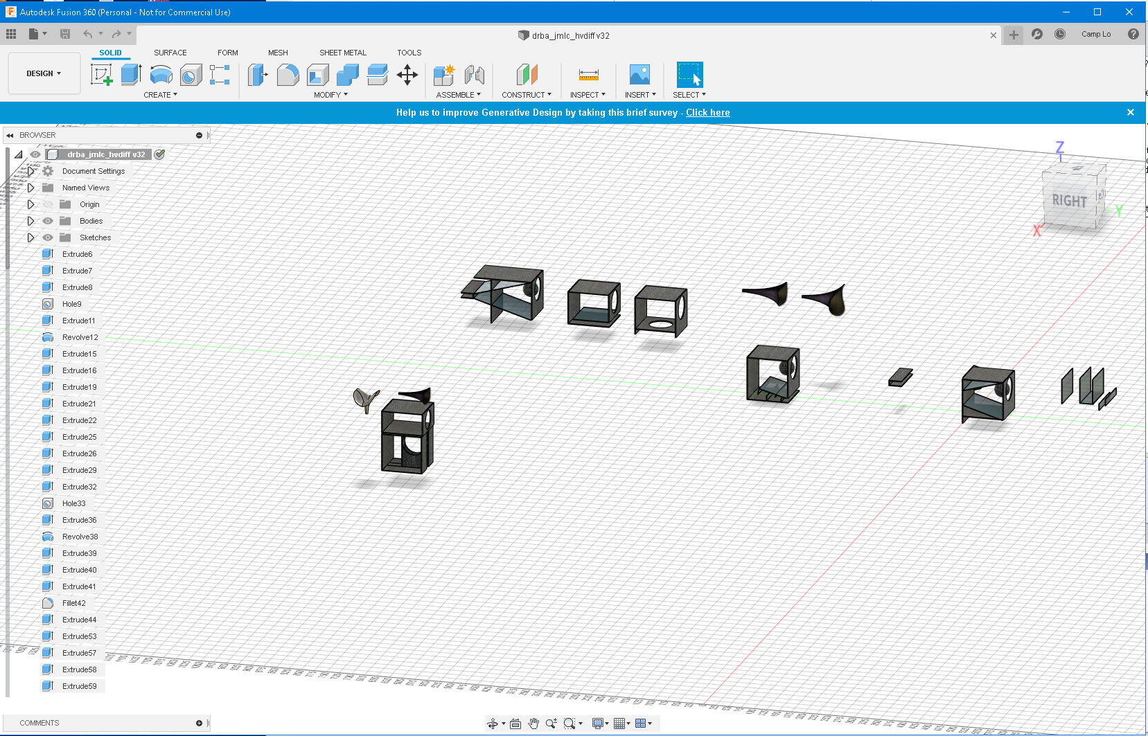

Wood cutting time aaaggghhhh.....almost a year later....supposed to start back to work monday....I don't think I'll find anything else to debate...I looked up my guy Bill Fitzmaurice and grabbed some wisdom on box building approach....that combined with my newly acquired knowledge of TL....bracing should be most effective. TO use screws or not...I have always used wood screws...I see a lot of people using glue...I could see myself using glue.....looks like I'd need about 40 bucks worth of clamps...the JBL2386 will be the first key note speaker for the build...I think I'm ready....

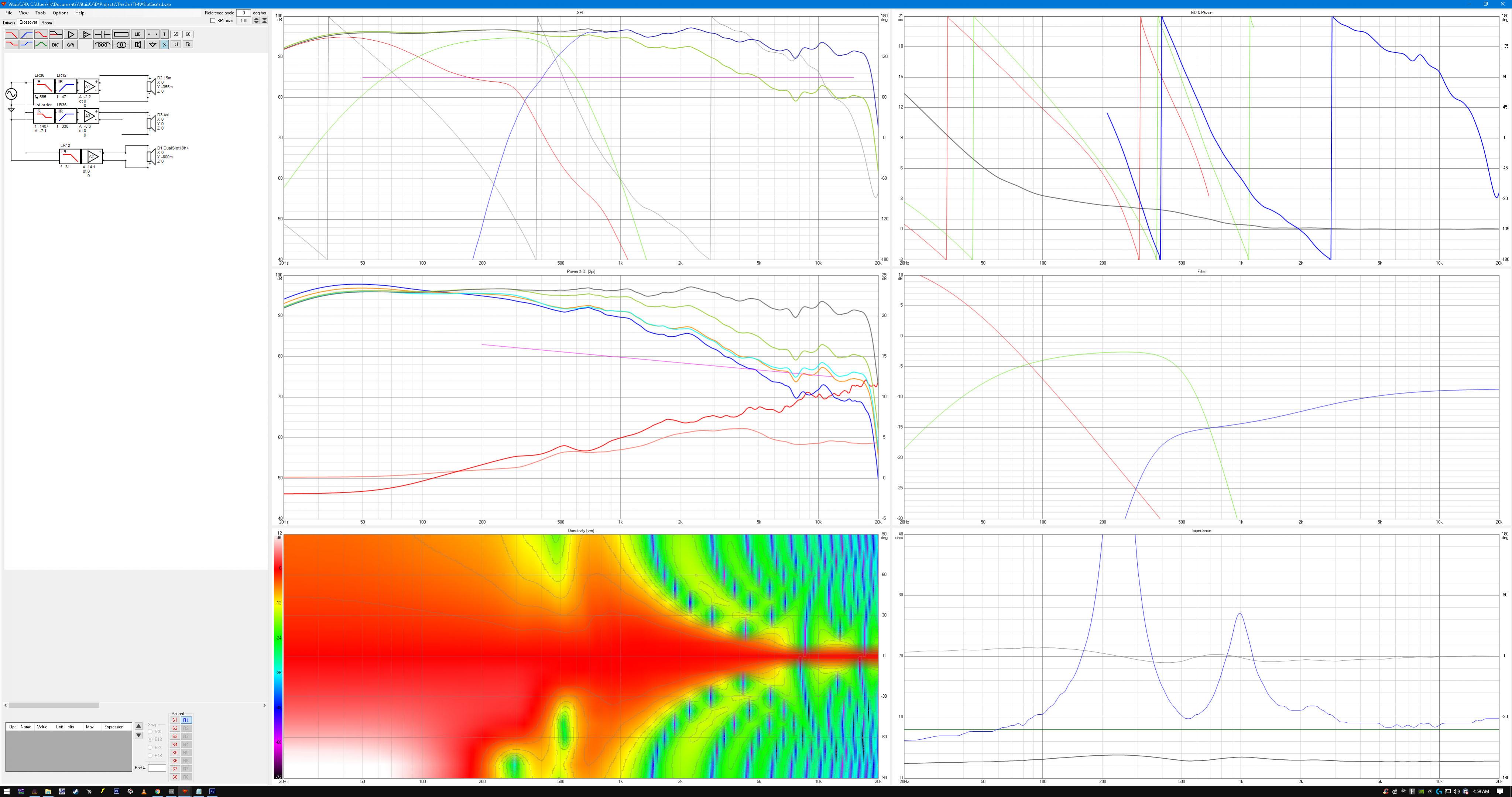

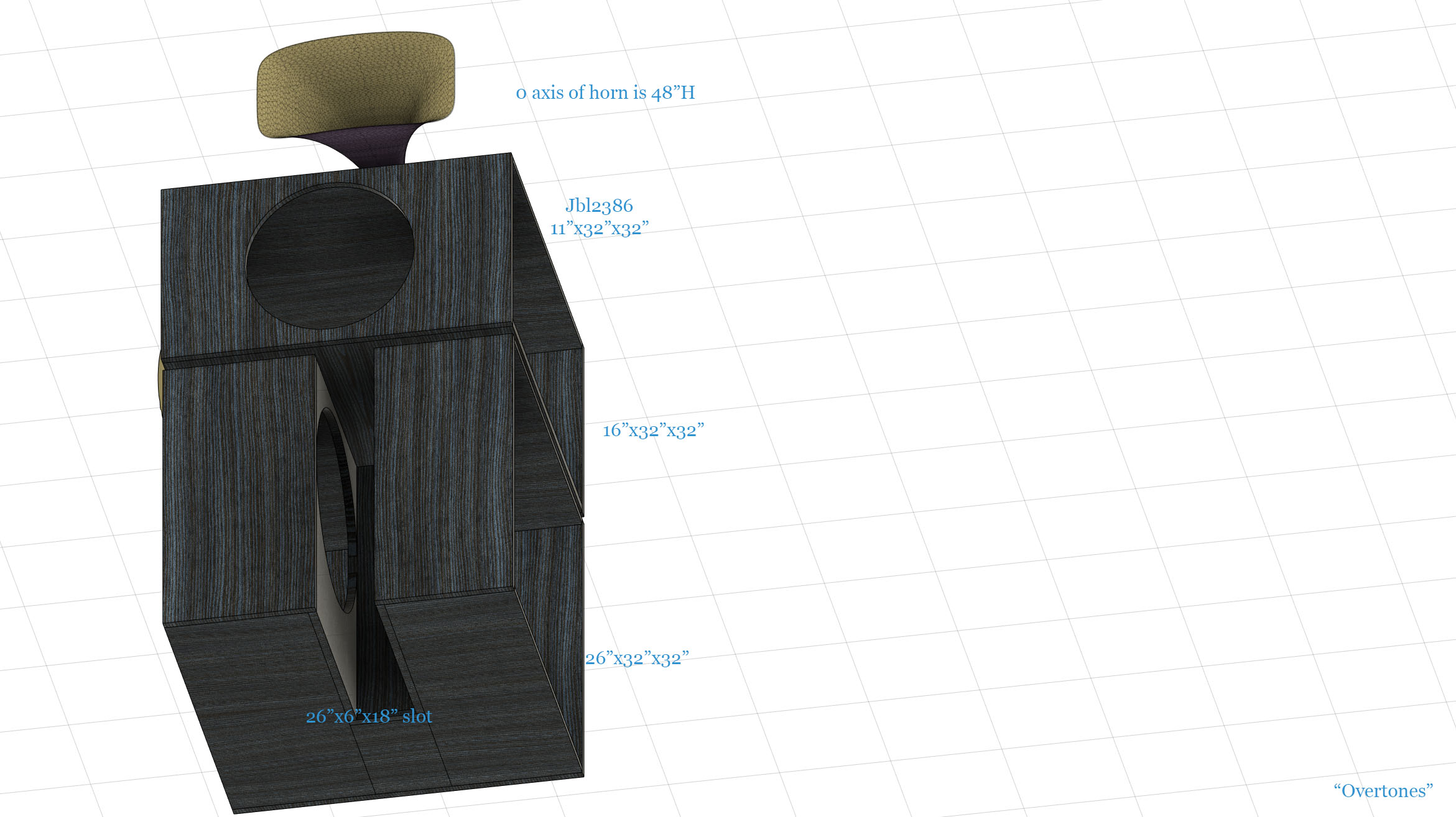

This is a glimpse into what may happen...this response represents the Axi2050 on a Seos30 but I used the dimensions of the 2386 for the modeling which skews things a little since the radiator is actually inside the horn, so the polar beaming is exacerbated....I could also try and model the 18H's as the slot dimensions but...you get the idea... I could probably play with the eq and get flatter response from the Axi2050 down to 300-350hz but...this is what I've modelled so far. Thanks for the slight kick in the butt nc535...
attachment.php
attachment.php
attachment.php
Qts of both mid and bass are somewhere in early the 0.5's

Nice picture of the arrangement!
Could you also provide another picture with the rounded mouth horn on top?
I would consider to use a Ripol for the lowest third, so side walls closed and back slots open. This loads the chassis a lot better and should provide a more dipole like radiation towards the listening position. The same for the middle chassis as u-frame or should this be a closed box?
