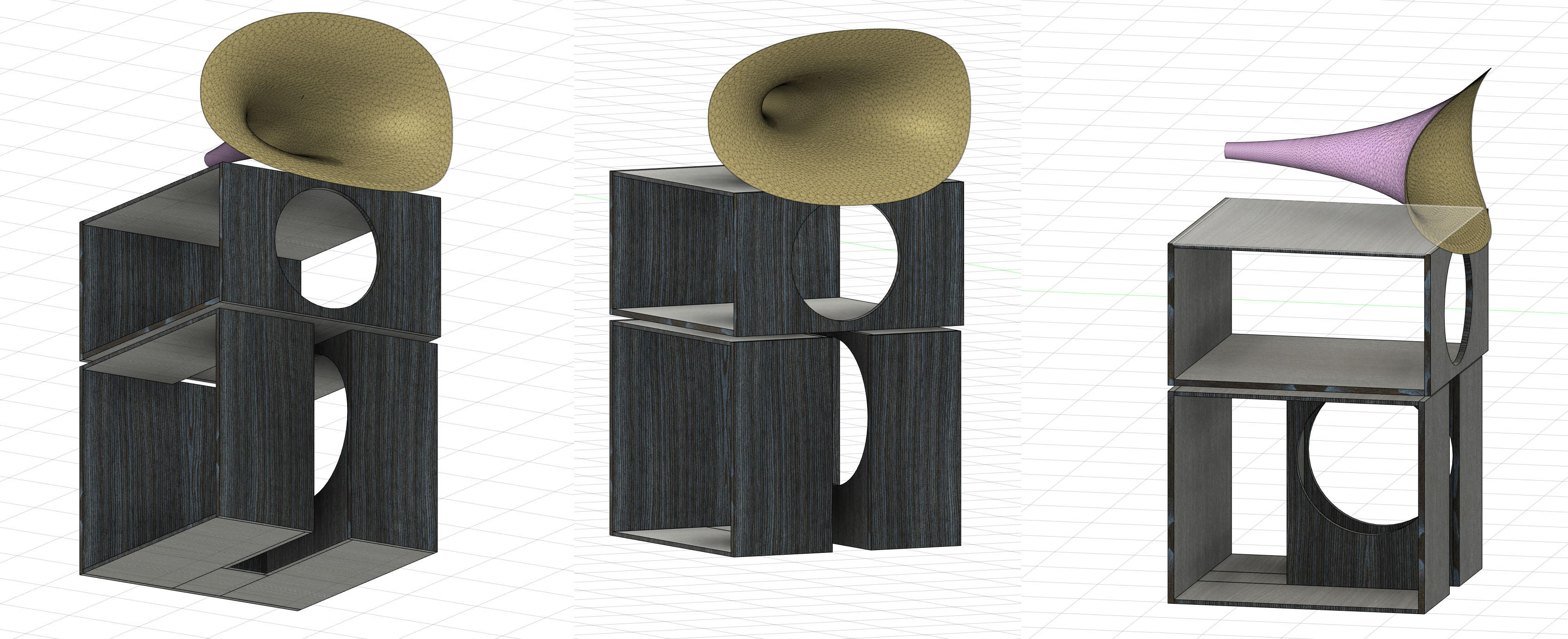

Here is the horn before the roll over. The o-axis of this horn, set up like this, adds ~2" of height
Optically, I would prefer the first version but the first horn seems to have a smaller mouth: It's already some time ago when I created them.

It would be interesting what is the optical effect of this radial type horn on top of your woofer chassis.

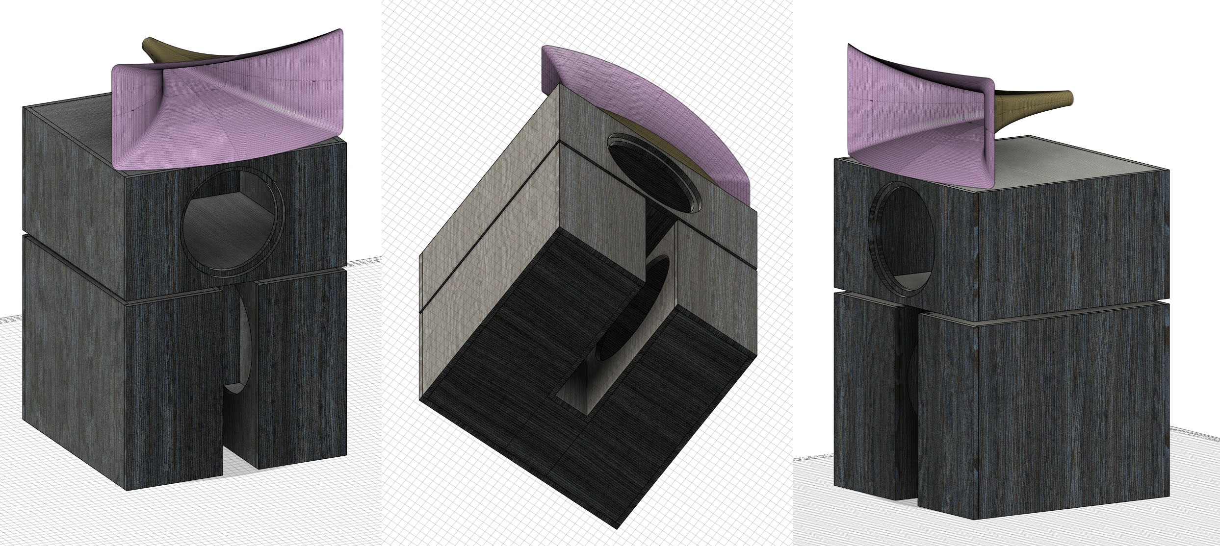

You know I'm dying to be your lab rat lol....If you are saying you prefer the looks of the swh160...the swh160 would fit nice into a box. Don K may or may not be finishing the swh160 round over...then again, the bi radials might not need a round over if fitted to a box...just the tapered edge of the box maybe?....the other horn pic is actually the swh160 scaled down...

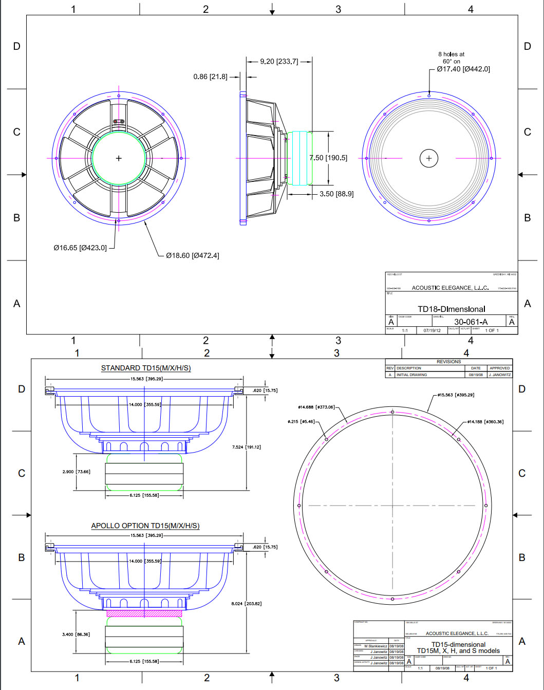

Countersinking the woofer would make the mounting baffle less stiff, counterproductive.Some advice welcome...for the slot load...I can simplify things by not countersinking the woofer...shouldn't be an issue, being that they are buried in the slot....right?
Whether the woofer was countersunk would have some effect on the slot resonance, determined by the slot chamber's depth, width and volume- countersinking would reduce the volume slightly.
At any rate, those issues are easily corrected with EQ, while the polar response inherent with your horn and mid cone position choice can't be corrected with EQ other than at one position.
- Can you elaborate please? Do I have some other options for positioning?while the polar response inherent with your horn and mid cone position choice
The horn you depict would have a "beamy" horizontal dispersion pattern, under 45 degrees above around 5kHz, widening to around 90 degrees at 1kHz, increasing to 180 degrees below 500 Hz. Equalized for "flat" response on axis, the horn will lack upper response off axis, no options will fix that other than a different horn choice.
The acoustic point of origin for the HF driver is roughly at the horn throat, for the mid driver, near the apex of the cone/dome. The path length difference can be corrected by delaying the HF signal to the time of flight, which appears to be around 2.5ms.
That delay would correct for the acoustic point of origin discrepancy on axis, but at off axis angles the apparent physical center to center distance will still result in wave interference, "peaks and troughs", "lobes", "comb filtering".
Options to correct the physical point of origin problem are either to move the HF driver forward, or the mid driver rearward. Those options could include using a separate mid horn, or the mid driver sharing the HF horn.
From what do you draw these over-precise conclusions? From the picture?
I tried to be general, rather than over-precise, as the picture looks just like horns with the response I described :^).From what do you draw these over-precise conclusions? From the picture?
The dimensions can be inferred from the size of the drivers discussed.
To put it simply, you won't hear much high end from an exponential (like) horn if you can't see the throat- they "beam".
Whether beaming is a desirable feature is up to the user to decide.

What weltersys is saying is :
1) The horn is not CD
2) Its not a coax driver, or a Unity horn
I'm concluding that weltersys feels a point source or pseudo point source is the way to go.
I think he is trying to save you about 3-7 years of work and reading, but knows you may have to get there the hard way?😀
