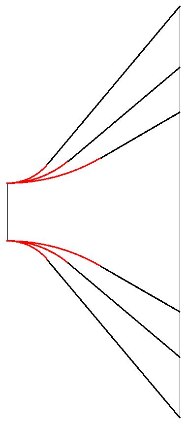

As an example, Peavey's QT horn is a simple compound conical horn that has two parts, the throat and the mouth.
The bell-shaped conical horn (QT) differs from a normal conical horn in that the extension lines on both walls intersect at the center of the throat mouth.
The throat area becomes smaller as the coverage angle increases.
A 60° horn of appropriate dimensions (horn throat included angle ±50°) based on this principle, with an advanced mouth section like mabat's ATH4, seems a better solution.

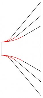

The QT waveguide is simply a cone with a constant radius from the throat aperture to the cone. It was done this way because in days past drawing packages could not do complex curves. So the designer just used a simple radius to blend to the throat. On inspection this is actually quit close to an OS, but not quite. Hence it works almost as well as an OS, but not quite.
Thus the throat area does not change with coverage angle. It can be any angle and any throat size. Honestly, it is a trivially easy solution that works pretty well - better than any device that uses diffraction. Not as good as an OS or any of Mabat's designs. They appear to be ideal IMO.

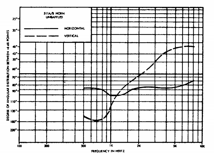

I became a believer in horns after several auditions of the Altec 511, I don't really remember caring about how wide the sweet spot was, I'm pretty this is not a constant directivity horn....If you sit outside the sweet spot, thats called user error.

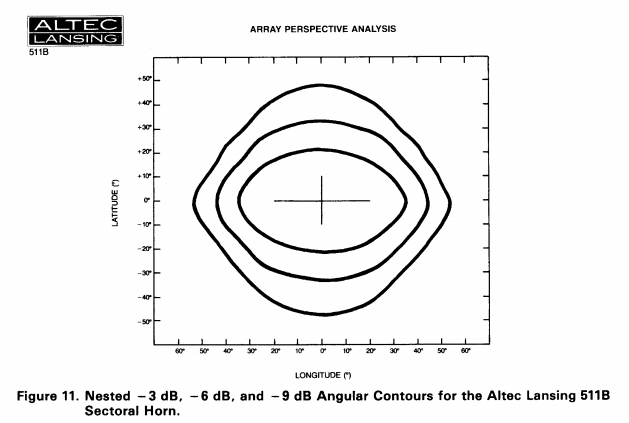

Anyone have a polar chart for the Altec 511?

Draw a picture if you want to see where the beam can go. Pick the angle at which the beam is down by 6dB and draw it out. Depending on the toe in and listening distance the coverage will change.

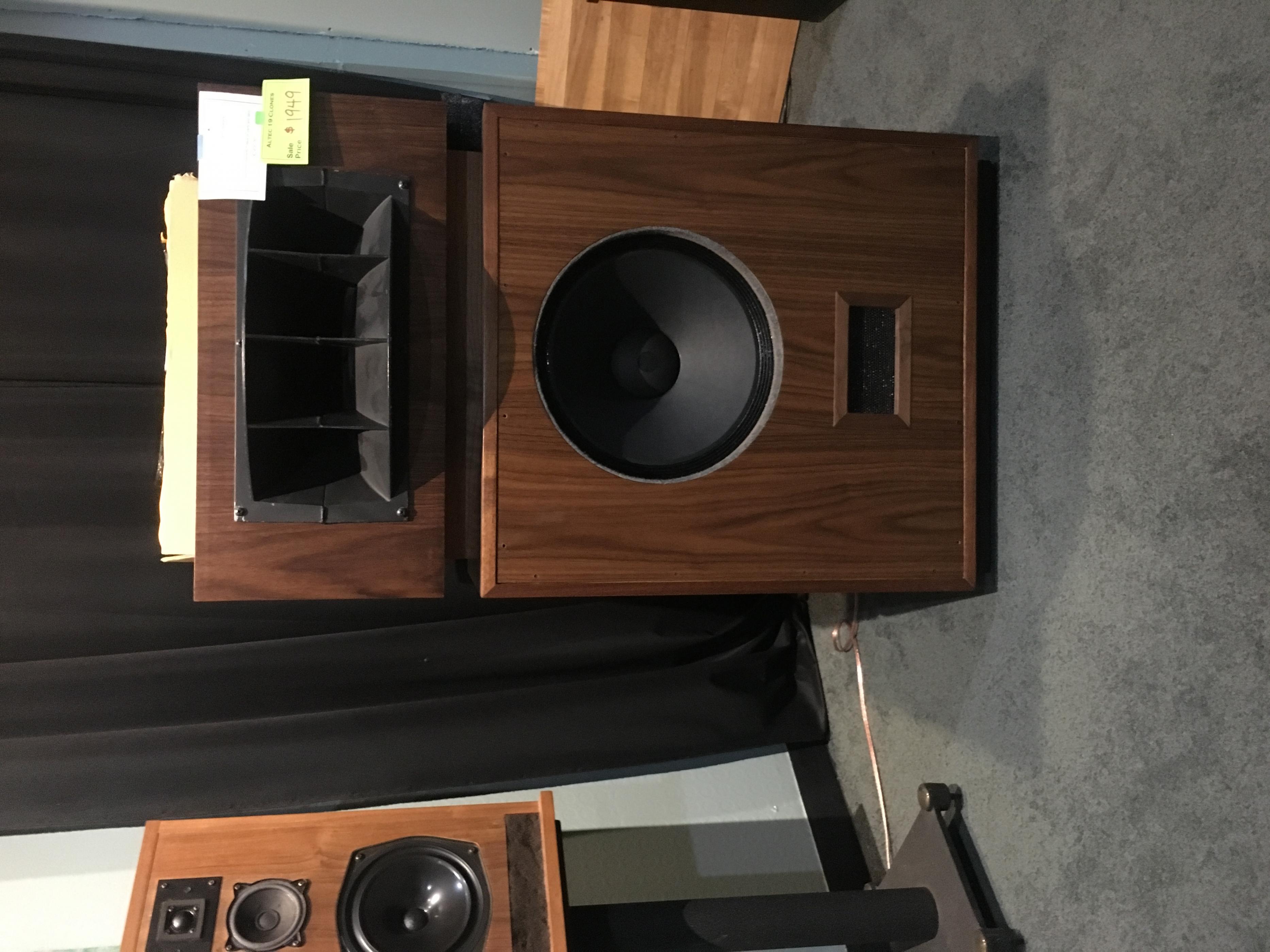

attachment.php
Welt I've heard this horn, it isn't constant directivity, and I really liked it....so when I hear constant directivity its going to blow my mind...thats the consensus?

Also I think the horn I heard was actually an Altec 311...which would have an even more narrow polar... I also sat as close as 1-2m and I didn't care about the beaming because unless I started swaying crazily from side to side, I was in the sweet spot. The damn Rona has everything shut down or I'd look to audition that system again, to be more confident about my experience with those horns.
attachment.php
No idea why its sideways.

Am I miss judging the Altec horns? other than loosing treble I did not experience this " stereo image collapses with even a small head movement"...A small head movement to me would equate to turning my head 5 degrees to the left. I also never left the chair....I think I do recall loosing the stereo image if I moved too far to one side but we are talking about leaning over several feet....who does that while auditioning a mix inthe studio? or ever? Once again, small is relative, please use exact wordings when it comes to beam width, Small head movements, etc etc

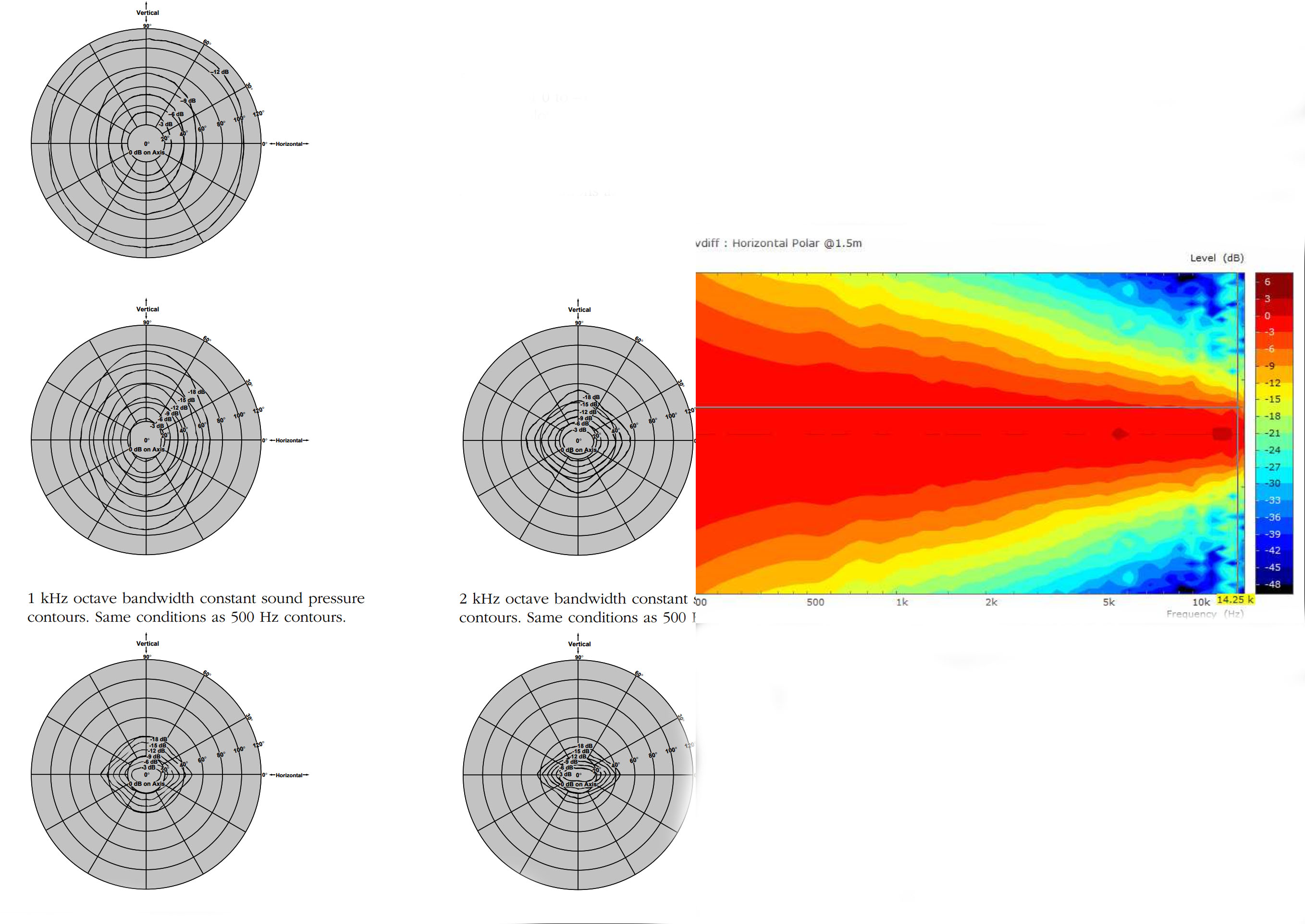

Nested, polars:
Don K once calulated the size of the sweetspot at 1.5m for the HvDiff horn design and it was....
If we use +/-15deg w.r.t axis at 1.5m the soundfield width would be +/-1.5m*tan(15deg)=+/-40cm = 80cm wide at 14.5Khz.
80cm!?!? Thats the beaming everyones crying about? I mean yeah its going to get more narrow as we go up to 20khz but....to what 20cm? 10cm? I tried to do the formula on my calculator but I didn't work out...my calculator didn't like Tan or something.
