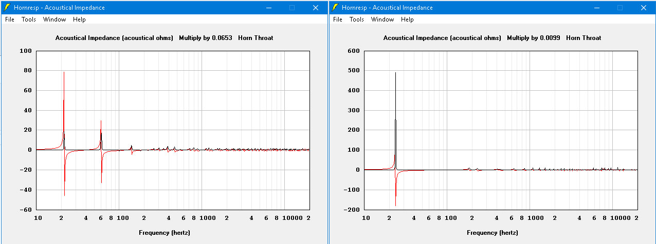

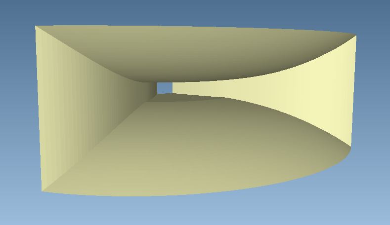

Thanks. This is one possible incarnation with 60 degs base opening angle. The fins are missing here but they are required and should be treated separately...
View attachment 820537 View attachment 820538
Electrovoice HR6040 🙂

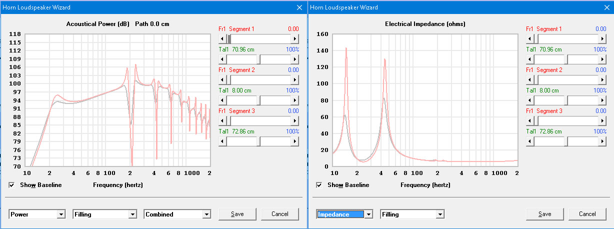

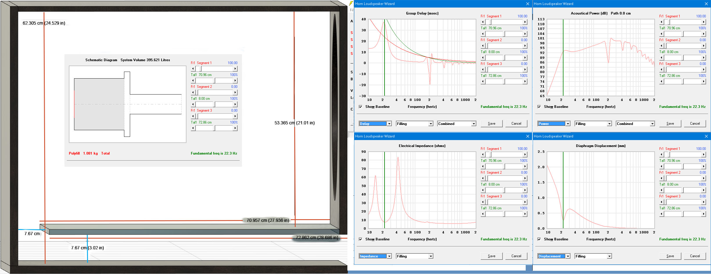

GM, take a look at this MLTL and tell me what you think. I'm still trying to get closer to the group delay you achieved in your design, but maintain the sensitivity. The impedance peak is 10ohms lower in this design.

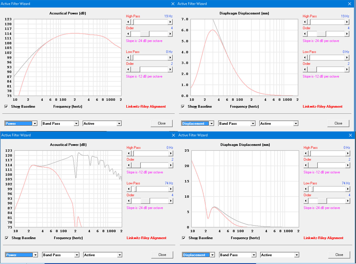

Loosing output from reductive eqing doesn't take away from the benefits of having a high efficient/sensitive loudspeaker because those sonic attributes (dynamic contrast) are tied to the enclosure and driver physics.....reductive (and additive) eq only changes the signal level to the driver, not its output vs signal level relationship. So you may limit the total output of the system, but if you have a rising sensitivity to start with, along with high sensitivity/efficiency, you already have more total output then needed, (for home use). When eqing the response flat, of said system, it increases SQ by diminishing excursion needs in the upper range.

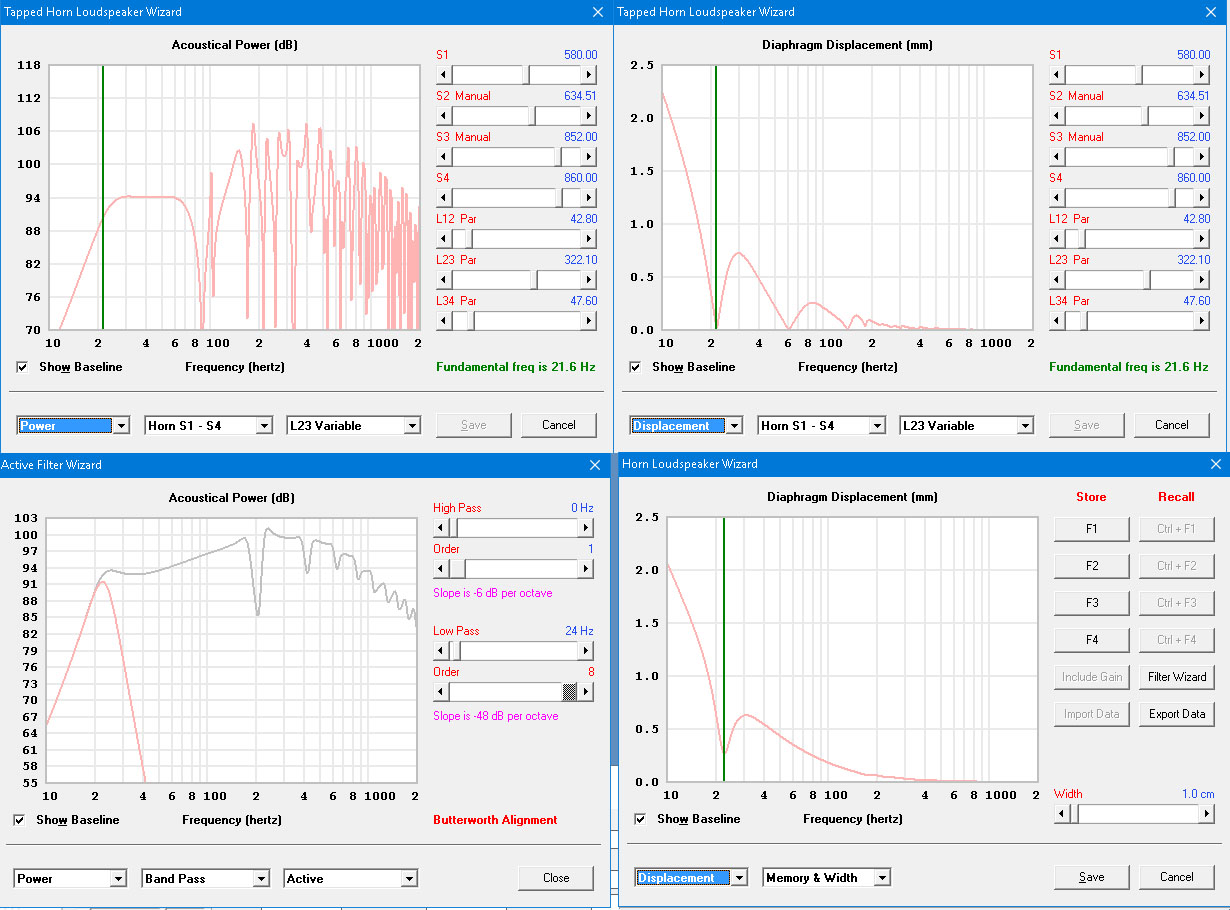

Run the sim with a higher voltage level (EG) to look at the excursion at higher powers to see if you will need a high pass filter to protect the driver. Hornresp can add the filter into the model to give you idea of how it would look.
I've kept a trend since I started modelling...I don't plan to ever reach 14mm-xmax which would peak at 121db @ 30hz (halfspace)... Are you maybe talking about protection, from DC and unmixed material in the studio? At the volume excursions minizes at tuning and at 20hz I'm back to 14mm still 121db. There will be two. How should I implement the HP or do I not need it, knowing that information? At 100db, xmax is at 5mm at 10db. So I think its good?
Below the tuning frequency the cone is uncontrolled and the excursion is rising quickly. The excursion line will continue below 10Hz in an upwards direction so what you see as 14mm at 10Hz might well be a lot more at 5Hz. So if you don't protect the driver with a highpass filter it's possible that material with very low thumps like from hitting an acoustic guitar body or electronic sounds with intentional or unintentional infrabass might give a fright.
Try adding a 6dB highpass at 15 to 20Hz in Hornresp and see what happens, from memory it's in the filter wizard.
OK, how should I implement protection for my compression drivers? Passively right?

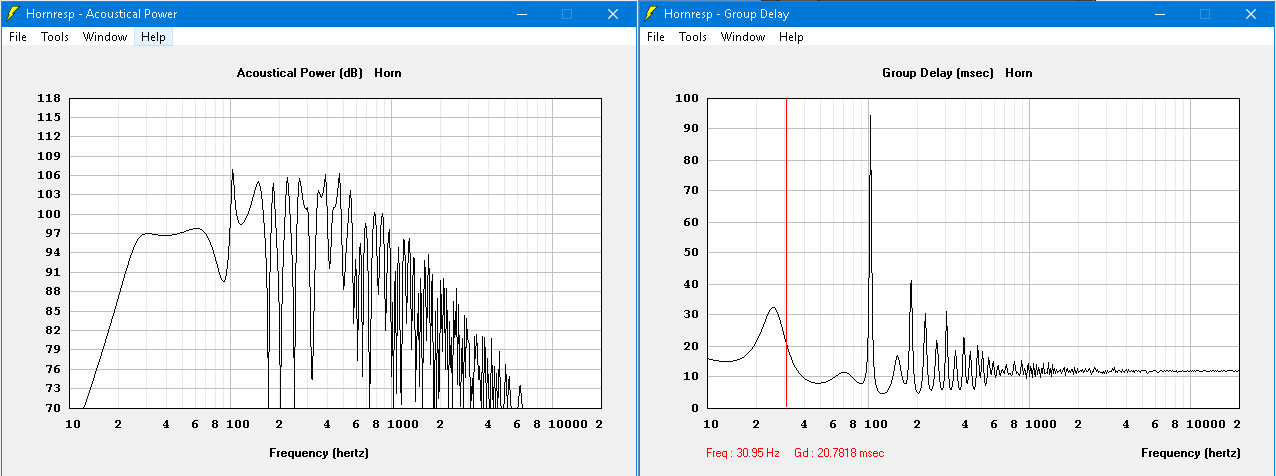

The group delay is inversely proportional to frequency :
Figure 17A : Phase, Time and Distortion in Loudspeakers

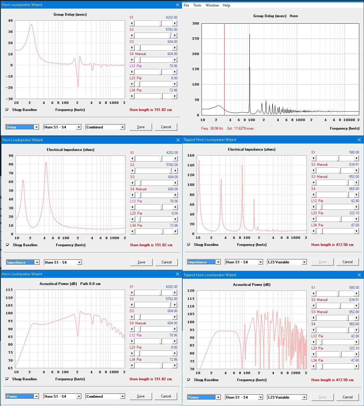

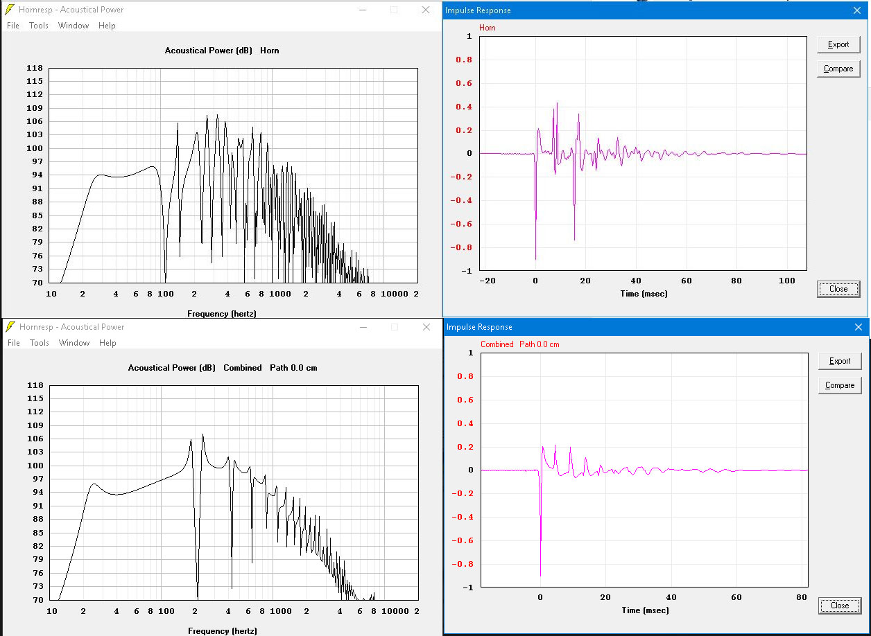

I just had the longest debate with a guy about how I should build a tapped horn instead of MLTL. I feel like I destroyed most of his argument, but I will say that the tapped horn is a beast. I couldn't find a configuration that increased sensitivity over the desired passband vs what I was already getting with MLTL, plus the MLTL had better group delay and more using bandwidth in the uppers. Not to mention, the MLTL is dampened. Is there something I missed?
MLTL without fill
This did appear, around 400 some odd liters with a taper I think... but the extension is less
MLTL without fill
Personally, i'd avoid both.
Imo, a tapped horn is more about getting as much SPL per size of box, as is possible, than about SQ.
Its' a mixed phase device just owing to the substantial path length difference between the two sides of the driver.
I guess same can be said for a transmission line box, but I really don't know much about TL's, and frankly don't want to given the more than usual trial and error it appears tuning one would take. Could be wrong big time here though...

When you think MLTL, just say.....what if I could get the same response as a BR of same size... but with less group delay, and its dampened to adsorb excessive reverberation (hence lowered impedance peak) with a better performing terminus (port)......if you seen the response of my above MLTL without stuffing you wouldn't have any worries about stuffing technique, as far as stuffing is concerned in this design, the more I use the flatter it gets at the knee, so you would know when too much was too much.
I was able to move the HP lower by getting the response to "max volume" and watching excursion versus HP.
Change the alignment type in one to butterworth and put a 1st order highpass in at 10 to 15Hz and see what happens to the excursion below tuning frequency. Then move the highpass frequency up and see the difference. You shouldn't need a 4th order filter for this, using IIR will add a fair bit of group delay low down if that is something you are trying to avoid.I was able to move the HP lower by getting the response to "max volume" and watching excursion versus HP.
