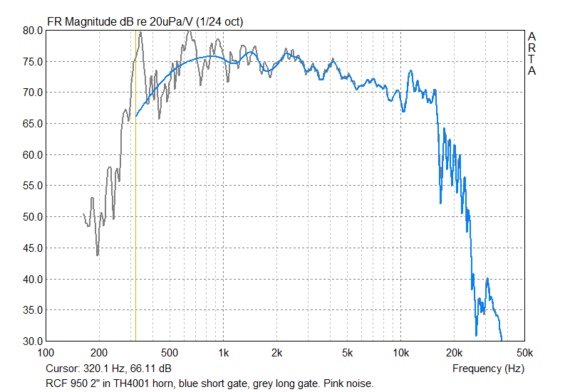

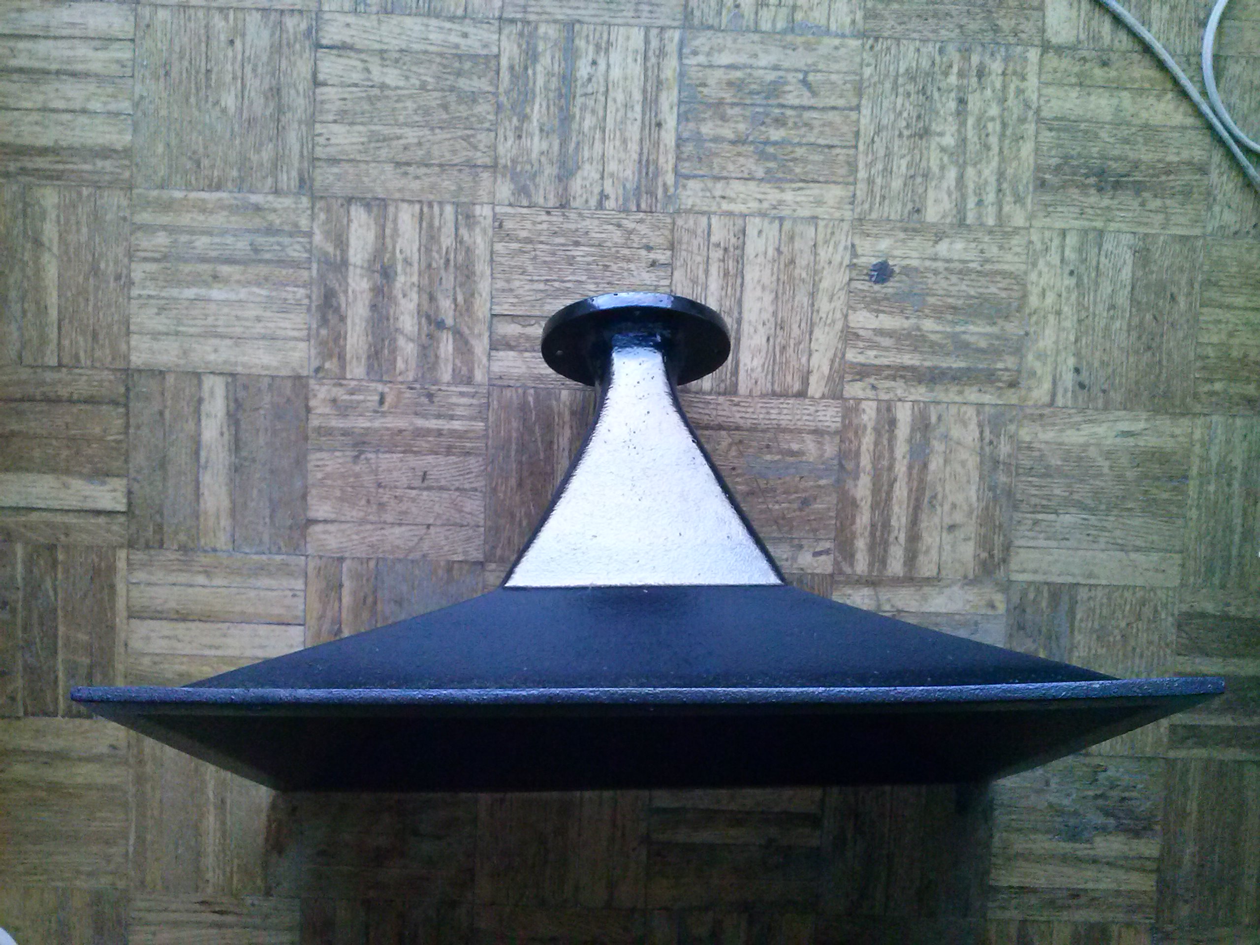

Yesterday I was helping friend with crossover and measured RCF 950 2" in TH4001 type horn. Room was small and tidy.

J, there seems to be a little too much energy between (roughly) 1.5 and 5k. The peaks are likely to boost listening fatigue even more. There's probably also too much output in the top octave for a small room. I suggest to bring those 2 areas down, PEQ the peaks and listen again :)
Sounds as if your tweeter plays some 10-12 dB too loud: even on my crummy laptop audio it sounds ear-splitting. No wonder you yearn for your ESL 57..
Levels ok, crossover from parts we had. ESL57 - very good tonality and natural timbre, try listen to clapping hands. Horns - feeling of mechanical sound. Within few weeks will repeat measurements and make better crossover.
chebum - different rooms.

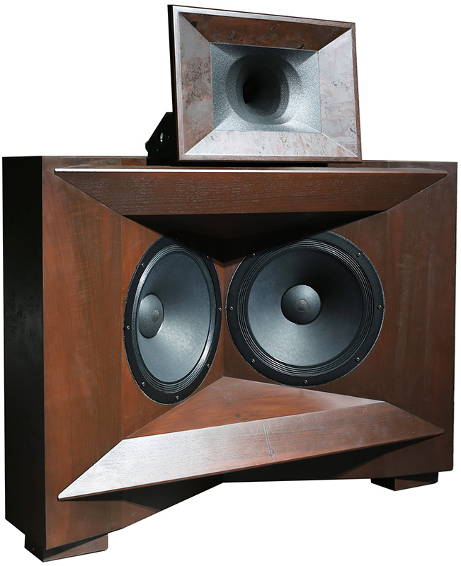

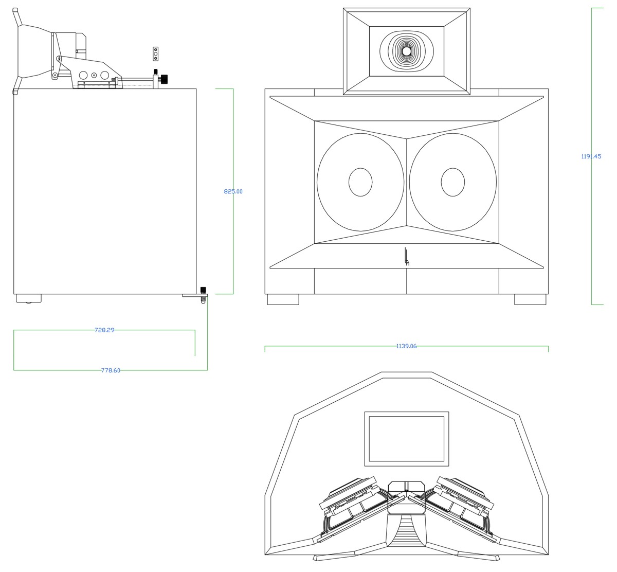

Another interesting 2 way:
30Hz - 20kHz ± 2dB, 4" Beryllium dia on 2" throat + 2 x 15", XO @ 850 Hz and 'only' 180 kg.
The top horn actually consists of an elliptical throat transition to a BMS 2236-type mouth section (last 2 images).
