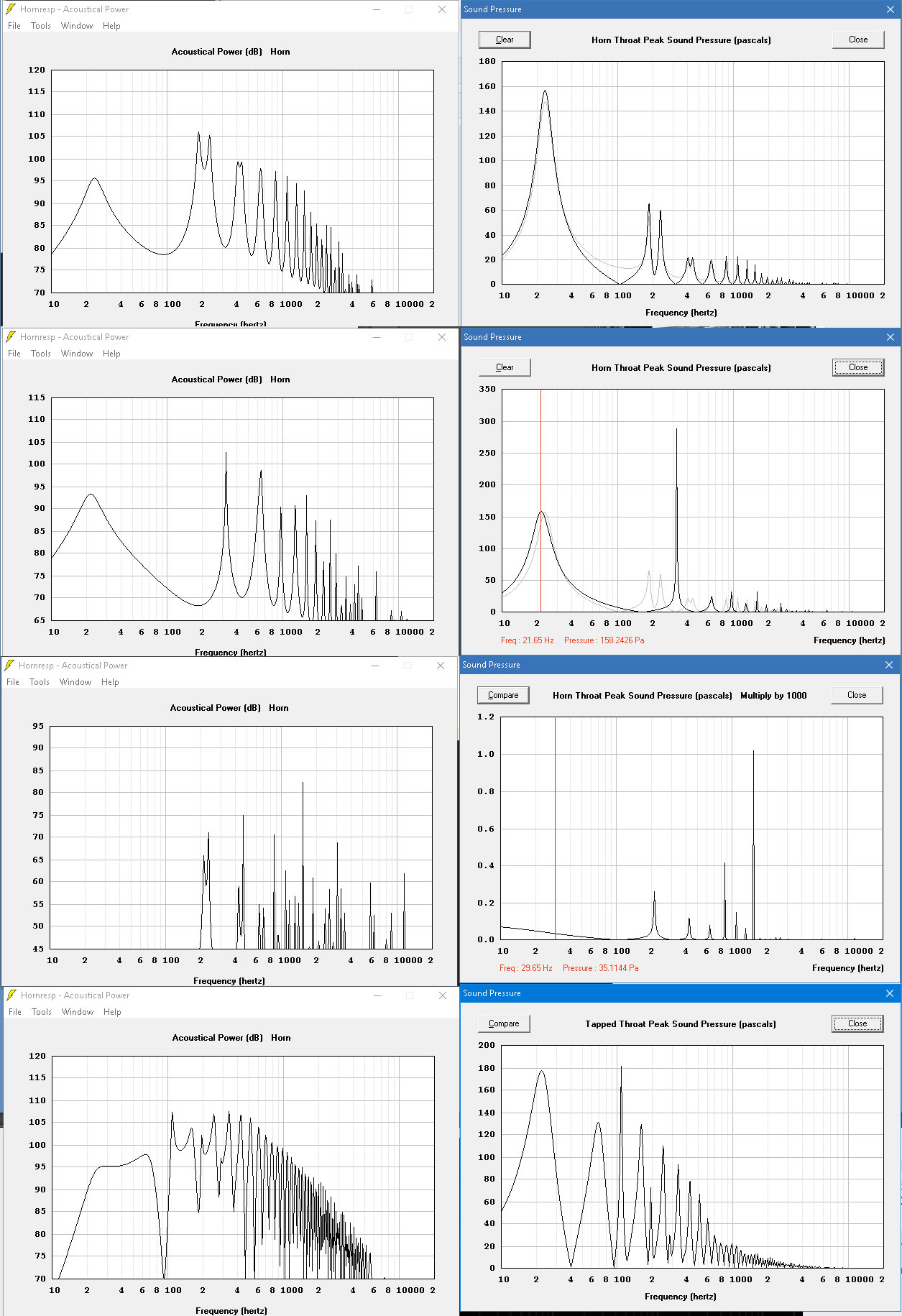

I created these while investigating what type of environment I might be putting the 18H+ into.
I wasn't super stritch on the comparison, I just wanted a ball park idea, and to see if further investigation was needed.
The graphs are; My MLTL, a ~300 liter BR, a ~338L Sealed box, and a 380-400ish liter TH....Getting real specific, I know. I had to trick HR into displaying a figure for sealed, my closed box is just my MLTL box with the smaller CSA length changed to the smallest figure HR will allow. From there these are the Horn throat simulations at 1 watt. I think all of these are probably fine, I was just really interested, and like I thought, the "sealed" box has the highest pressures generated.

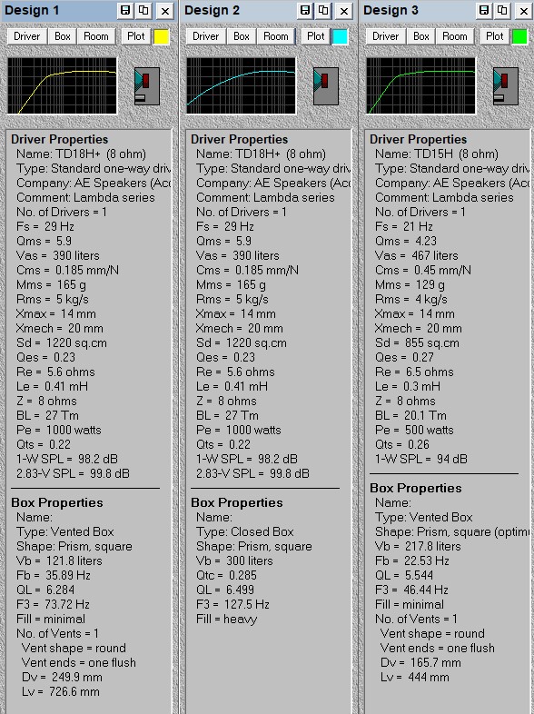

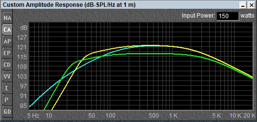

I put Bassbox Pro back on my computer today, and out of curiosity ran some quick simulations of the AE drivers as they were in the database.
I used an EBS vented alignment and sealed in the 18 for comparison. The vent needed for the 18 is not at all practical, the 15 is getting pretty long too.
The 18H+ does not seem to be designed as a subwoofer, the TD15H goes lower in frequency but gives up output to the bigger driver. Depending on how much you are targeting very low frequency response, sealed could be a good choice.
