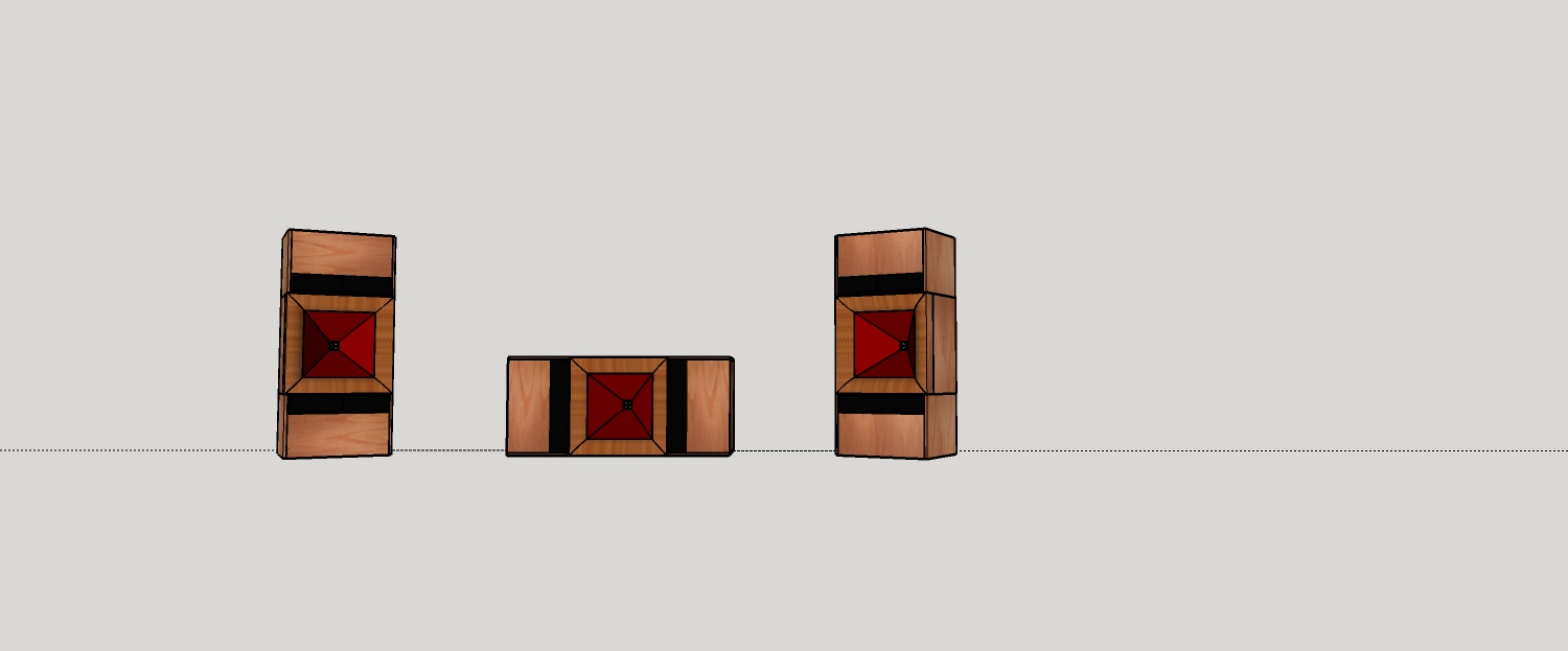

Four 18's up front like I drew (mine are 15's) does indeed look impressive. I've done the drawings and built the woofers but I've never lifted the 2nd woofer on top of the stack out of fear for my back. I've found I'm satisfied with just the lower woofer working with subs out in the room.
I don't see why you couldn't add slot loading to the TL, but I think its an unnecessary complication. At the XO frequency being considered, CTC isn't an issue. It does minimize the height for a MTM stack but its not necessary to get a lobe free forward beam at the XO we are talking about.
If keeping things simple becomes your goal and 4 18's up front is within the realm of possibility, then consider side by side direct radiator woofers below the horn. I think the pair of 18" woofers will be a good match to the horn in both width and height for a better directivity match at XO. That can be made to work well aesthetically as it did for JBL back in the day.

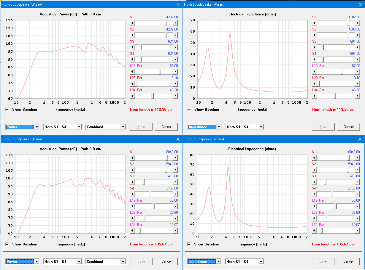

Right now you've got me interested in slot loading the 15M in a sealed box. I don't know how to model this in hornresp though. What type of effect is the slot going to have on the FR.
Currently I am dedicated to the TL. I mean that if I build it and don't get it right, I will not give up until it is right, which is pretty much standard when building a TL thats never been built before.

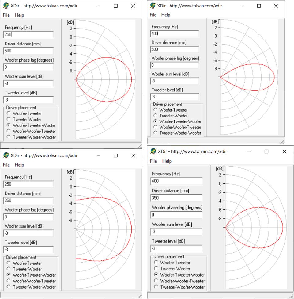

CAn we talk about this....are you suuuure? How am I figuring this? I might have used xdir to confused myself but at 250hz from the center of the 15" to the center of the horn will be....18.5-20"...I am not talking about mtm though.
A slot loaded woofer is modeled as an offset driver horn. A pure slot is such a horn with no expansion. But if you build it as I did as a very high aspect ratio conical horn it will play higher. You can see the HR model and the effect on the FR in post #3 of my Companion Woofer thread.
I agree with direct radiators you will get 20", about 500 mm, or less CTC. Here is what XDIR showed me
