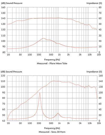

There's isn't much that isn't worth a try if you have the time to do it 🙂 What do you think is telling and about which dip?

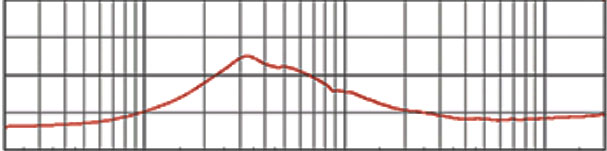

What I see in the impedance traces shows what I was trying to tell you before, the resonant frequency hasn't changed all that much between the two, it is more highly damped and spread out on the PWT measurement. Any practical horn is going to look much more like the seos measurement than the PWT.

Also, why do you say that impedance is more damped on PWT, Impedance is lower on the horn, much lower in the areas above resonance.

Because it is 🙂 Have a look at the scales and you will see that they are not the same, the lowest point on the pwt looks to be about the same as on the horn it just does not have the high q resonances. Overlay the graphs at the same scale if you can't see it.Also, why do you say that impedance is more damped on PWT, Impedance is lower on the horn, much lower in the areas above resonance.

A plane-wave tube (PWT) is a device which is intended to provide a constant acoustical impedance with a value ρ0c divided by the area defined by the inner diameter of the tube, where ρ0c is the specific impedance of air.

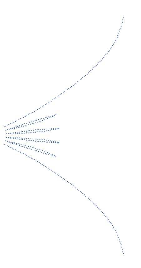

In the meantime I have my own calculator for this type of horns. Very flexibel with any opening angle or number of fins. The TH4001 has staright side walls which I think is not optimal. Here is an example of my new approach:

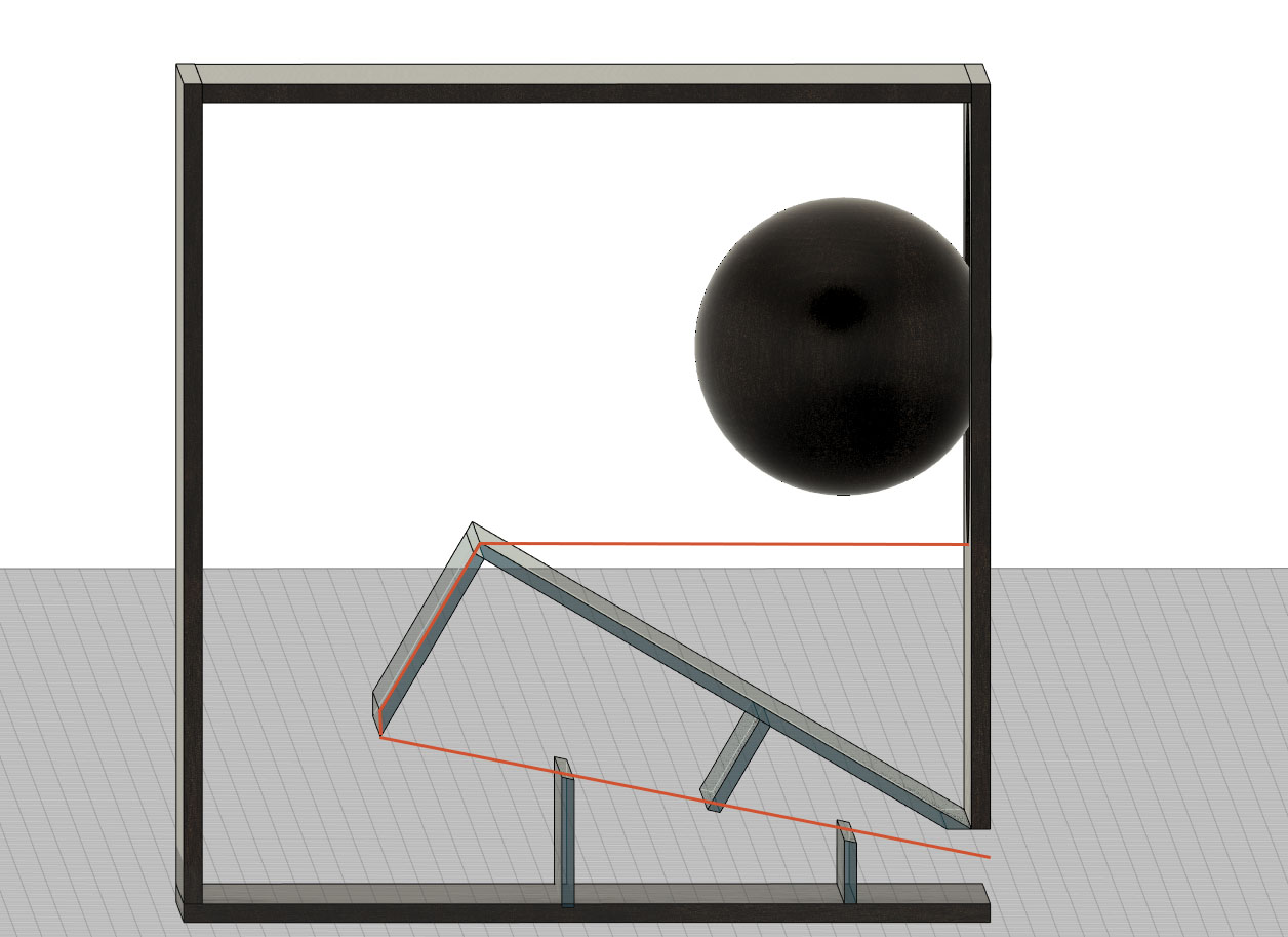

How does one calculate the position of the vent along the horn?
nothing to calculate;
close to the mouth and in the corners is best
So all I have to do is put a hole(s) in the horn near the mouth? Maybe model the holes as port from a cavity like a bandpass?
