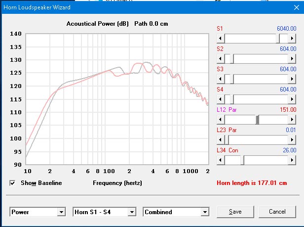

Yes I know in this sim I have the 604 for 10inches, vs how mine tapers till the end, but the sims I did to represent that, where about the same I just happened to have this pic already and it shows what type variation we are looking at, as long as I measure length in a logical way..... from the middle of the driver to middle of the downward channel, down to the middle of lower lane and straight out the middle of the exit. Is there a better way to measure or how do you suggest I model it to predict its performance.
I also have another design sitting on the shelf, another iteration that splits csa into 2, then I'd end up with ports on top and bottom. or each side if I turn it over. This might be a better route, folded like some tapped horns, I would have skinny on the beginning CSA to keep the height or width in check....but not by much....let me see what I can do.

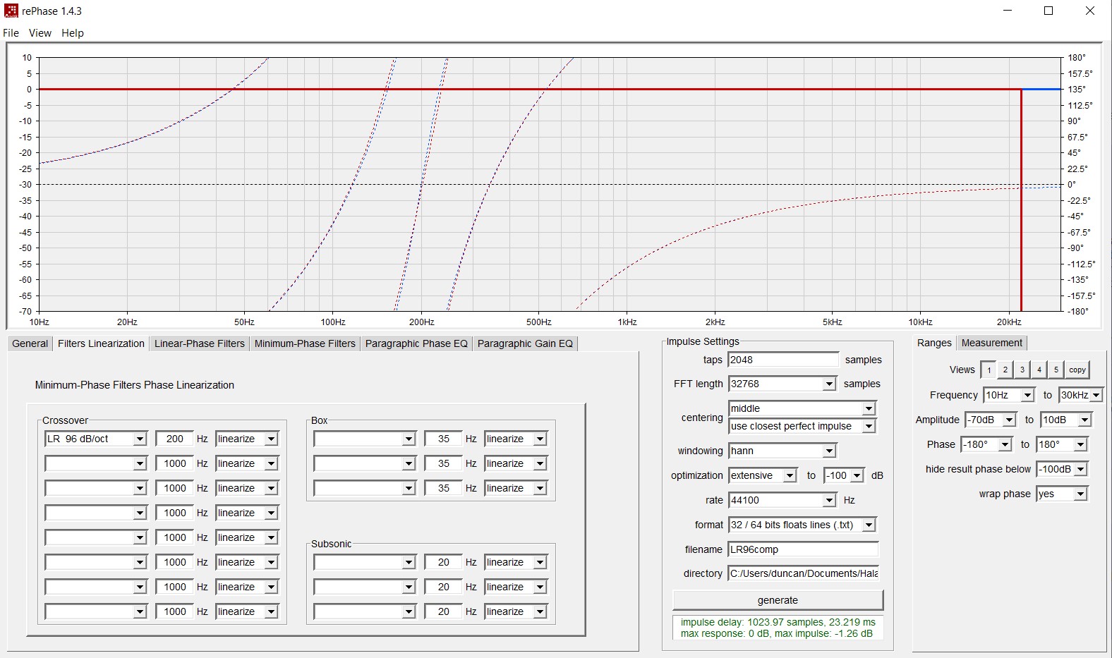

Ah, I thought this was for mixing, so I had that wrong. I have an electronic drum kit and have used a computer with VST as playback, the lower the latency the better for that application and sub 10ms is ideal, you can learn to deal with more but you do have to be quite good to do that and it's hard to be completely consistent.Stereo bass just makes sense to me, it also compliments the experience when I play video games. Same thing goes for latency. As a competitive gamer I am familiar with ms as a unit of time......Also, input latency and keyboard drumming has exposed me to latency and its limitations. So I just opened my DAW to test out some latencies . I think I have been over critical in the past....but at the same time maybe not...I stated that 10ms was my tolerance
It doesn't have to be one or the other though, you can switch to linear when using playback only and switch presets to zero delay when you need it. The difference is not night and day in any case but it would give you options to consider. You can also compensate a Linkwitz Riley MP filter with rephase to undo the phase turn and group delay, phase only EQ can usually cope with less taps than needed for changing magnitude. I have attached a rephase screenshot to show that you could go down to 2048 taps and get a pretty close match to the phase characteristic you need which gives a delay of about 23ms.

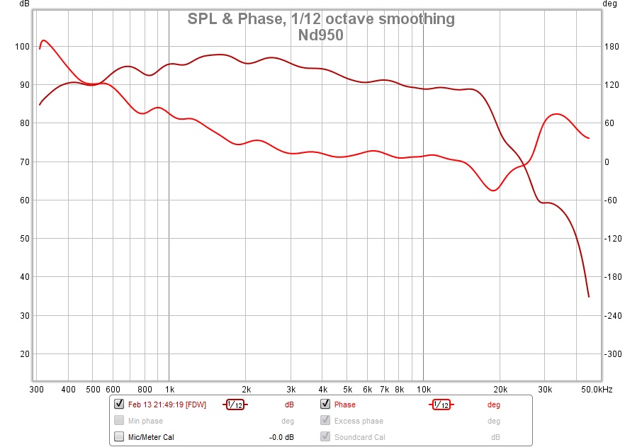

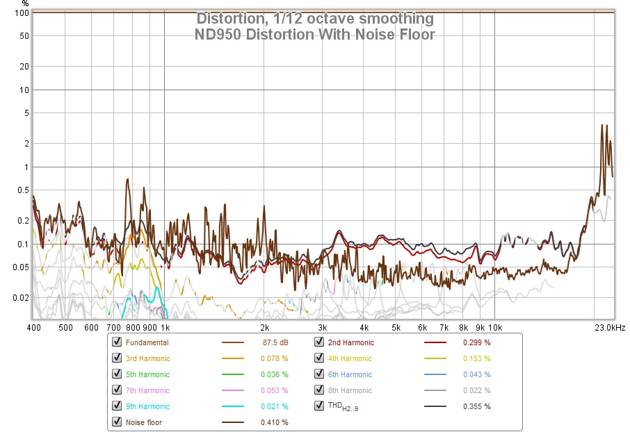

Here is a frequency response and noise floor:Chebum, what SPL ? Needs that reference, along with noise floor when levels so low...

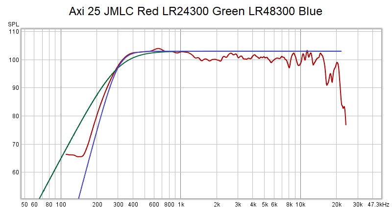

You do understand that in this thread an Axi user has traded REW measurements from his Axi on a 250hz jmlc? Not exactly flying blind here.... at bare minimum I'll be crossing at 300hz, thats a fact, and yes he likes it to 20khz. It rolls off before 20khz like 19khz. He crossed to a 18" Fane woofer I think. He had a beyma 150h on top before the AXi2050, I'm sure his ear would of been crying if sound quality was lacking due such a wide bandwidth....the problem is noone has an Axi2050 first off....or a radian950BE, so anyone saying what it "can't" do, is just speculating. So I'm kinda planning a pick nick and preparing for rain.
There was another guy who had an Axi and said it crossed fine at 300hz, that it could probably be crossed lower (thanks for not testing bud) and that he like the upper of the 950Be better.....and he also did not test how low he could cross the Radian...I just seen his Radian and horns sold on shark audio so not likely to get him to do it in the future either lol. Which makes me think.....aren't there TAD compression drivers that cross as low as 300hz and cover the rest up top as well?

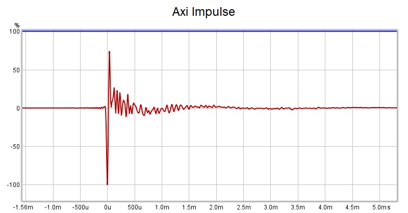

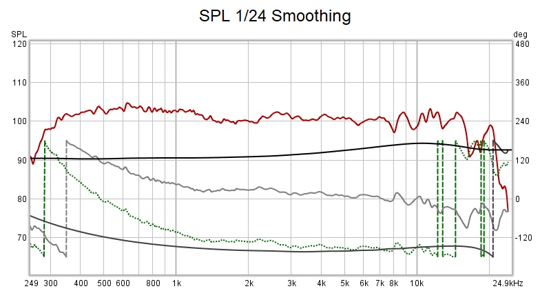

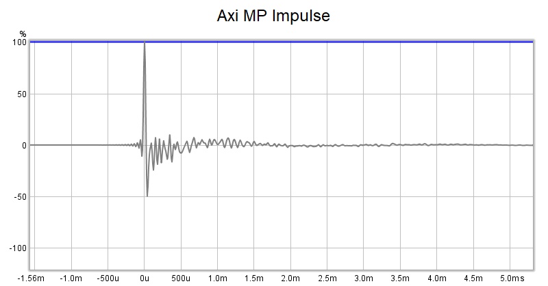

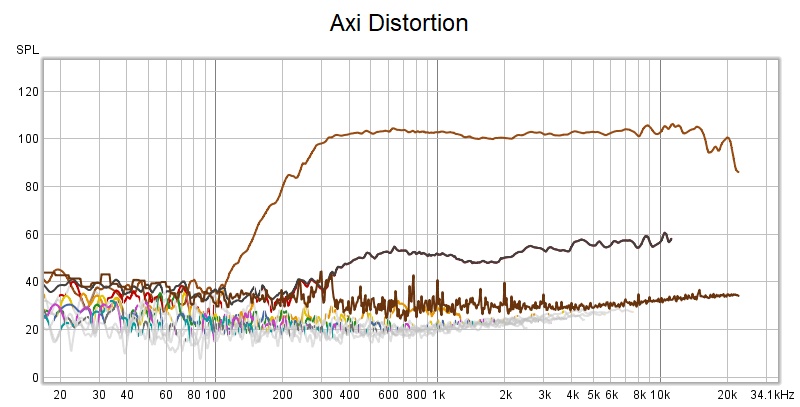

OK first for anyone else looking that file is actually a rar not a zip, 7zip will extract it.Matter of Fact, Why not tell me what you see for yourself, or anyone else interested, here's those measurements.
I'm not sure under what conditions it was measured so it is hard to do much other than guess. The impulse is a bit weird it does not resemble the minimum phase version that well. Looking at the excess phase in the SPL there is something going on at the very top end which could well be a measurement glitch causing the weird impulse. I see a little bit of ringing but it seems pretty well behaved. In the less smoothed spl graph I see a loss of control starting at 7K, hard to say where that comes from.
The distortion is unusual as well the 2nd harmonic is much more prominent than anything else and has a very different profile. The higher harmonics are extremely low for the spl indicated it doesn't seem right to me.
Screenshots below

Camplo, I have added some textbook crossover slopes onto the Axi2050 in a JMLC 250 Horn measurement to give you an idea of what they look like. The rolloff shown in the bare measurement is very close to LR48 300Hz, for comparison there is an LR24 at 300Hz. I think 300Hz is quite achievable with that driver, 200Hz would be more of a stretch and could be output limited if that is an issue. The impedance peak shown on Celestions website on their horn is around 250Hz so pushing below there might be more problematic.
Or at least thats what I'd like to think, I'd take 250hz tbh, 150hz would be better =)The impedance peak shown on Celestions website on their horn is around 250Hz so pushing below there might be more problematic... if using their horn.
Let's see when you build it and take an impedance measurement. Then you can decide for yourself from actual data if it will work 😉
