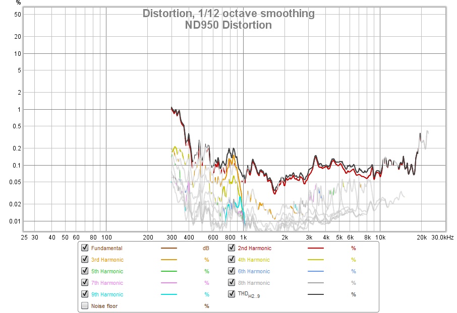

Some RCF ND950 distortion measurements
I made a measurement of distortion for ND 950 in HF 950 horn at 1m distance. I used Neumann KM 183 omni mic. Not a measurement microphone, but it is of better sound quality than UMIK-1. Distortion figures are better with Neumann than when measured with UMIK-1.
Neumann mic is plugged into Focusrite Clarett 2Pre USB. Its line output is connected to an Arcam amplifier. There was an autoformer from Bob Criter + 8,2Ohm resistor between amp and compression driver.
Measurement from 300 up to 45000 Hz. 96000 sample rate.
Distortion figures (normalized) are as follows:
How so? I'm not saying you are wrong, just want to know. You have to have calibration file for this mic? Probably cant trust it past ~3khz, starts to change in sensitivity on up....priuce sure is different lol!

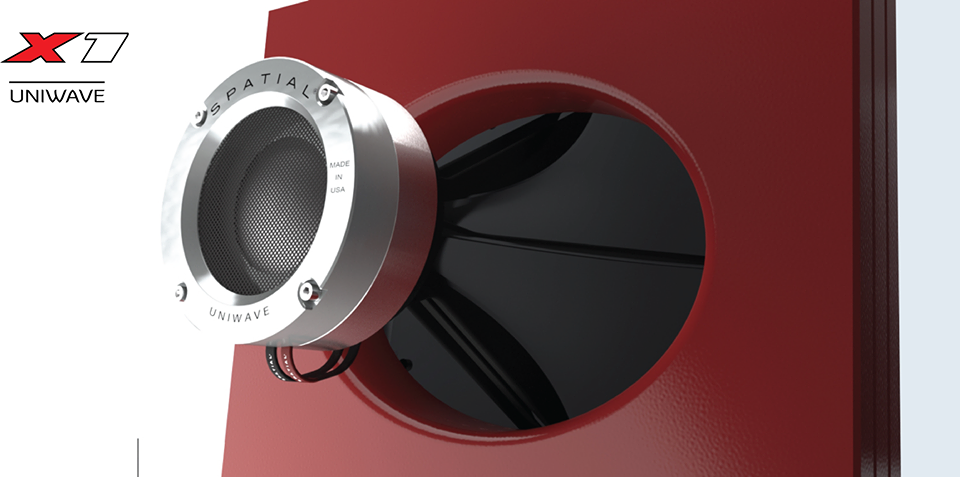

Its really frustrating that they don't give the xmax-thiele specs for compression drivers and their diaphragms.
This is the Radian that they used to cross at 300hz.... on a 800hz horn....I read that the company worked with Radian to produce this compression driver but thats all I know.

How so? I'm not saying you are wrong, just want to know. You have to have calibration file for this mic?!
I made recordings with both. It's clear which one catches more details.
I made a calibration for Neumann based on calibrated Umik-1. Neumann is linear until about 2Khz and then become hotter until 10Khz. Made measurements using both placed side-by-side, then divided in REW and got a calibration curve for Neumann.
Chebum, what SPL ? Needs that reference, along with noise floor when levels so low...
As far as I remember around 90-100 in 1 meter. Louder than i'd listen to. Will check tomorrow.

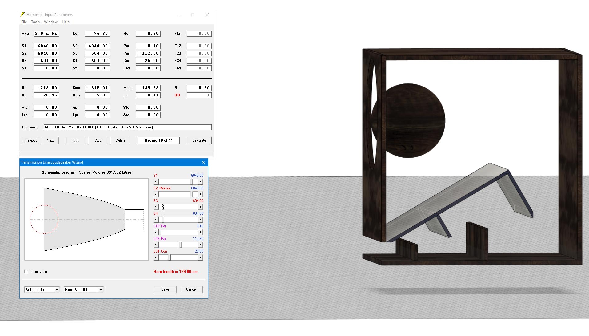

Has anyone ever actually read the page on transmission lines on wiki? I don't know if to trust it or disregard. Theres some different philosophy on there that I've never read anywhere else. Thank God for GM because there are so many people with opinions on what a Transmission Line is or could be or should be, and non of these people have ever built a damn TL, or if they did, they've built or heard 1 or 2 out a very large amount of possible and claimed successful configurations, and then even the people with a wealth of experience disagree, so I think it turns into a personal, or personality type type choice and I I like GM's style so...boom. My 3d iteration of GM's design turned out pretty good I'd say, its a little beyond some's perception but given my design goals and the anticipated performance of anything that resembles what GM's original design intends, I'll be a happy camper. My design ended up being ~16" over but I also modified the design by exiting the taper all the way to terminus and only a few inches before terminus does the line reach the lowest CSA that originally occupied the last 10" of the design. Still chippin at it, but I think its turning out well.
Wiki TL?
3d iteration? If you mean this and drawn to scale it likely won't perform like you think: https://www.diyaudio.com/forums/att...pl-low-distortion-2-a-reiterationgm-mlttl-jpg
Better to just make mine larger, longer.
GM

I got that far, but searching only got me the math: Engineering Acoustics/Print version - Wikibooks, open books for an open world
If you read the Ariel thread, you'll find the staggered 'steps' must be well defined to act as a significant acoustic impedance.
